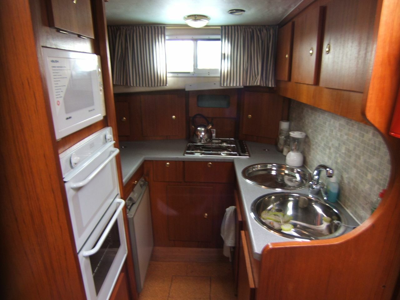

Alan de Enfield Posted November 26, 2021 Report Posted November 26, 2021 1 hour ago, Tony Brooks said: Good idea. I assume you mean on the inside so in effect you increase the depth the water can reach in the channel before it leaks into the boat and therefore it leaks over the outside channel. It does seem to be a standard fitting on cruisers, all my sliding windows are so fitted (with a 30mm ish aluminium plate) Clearly seen on my galley window :
