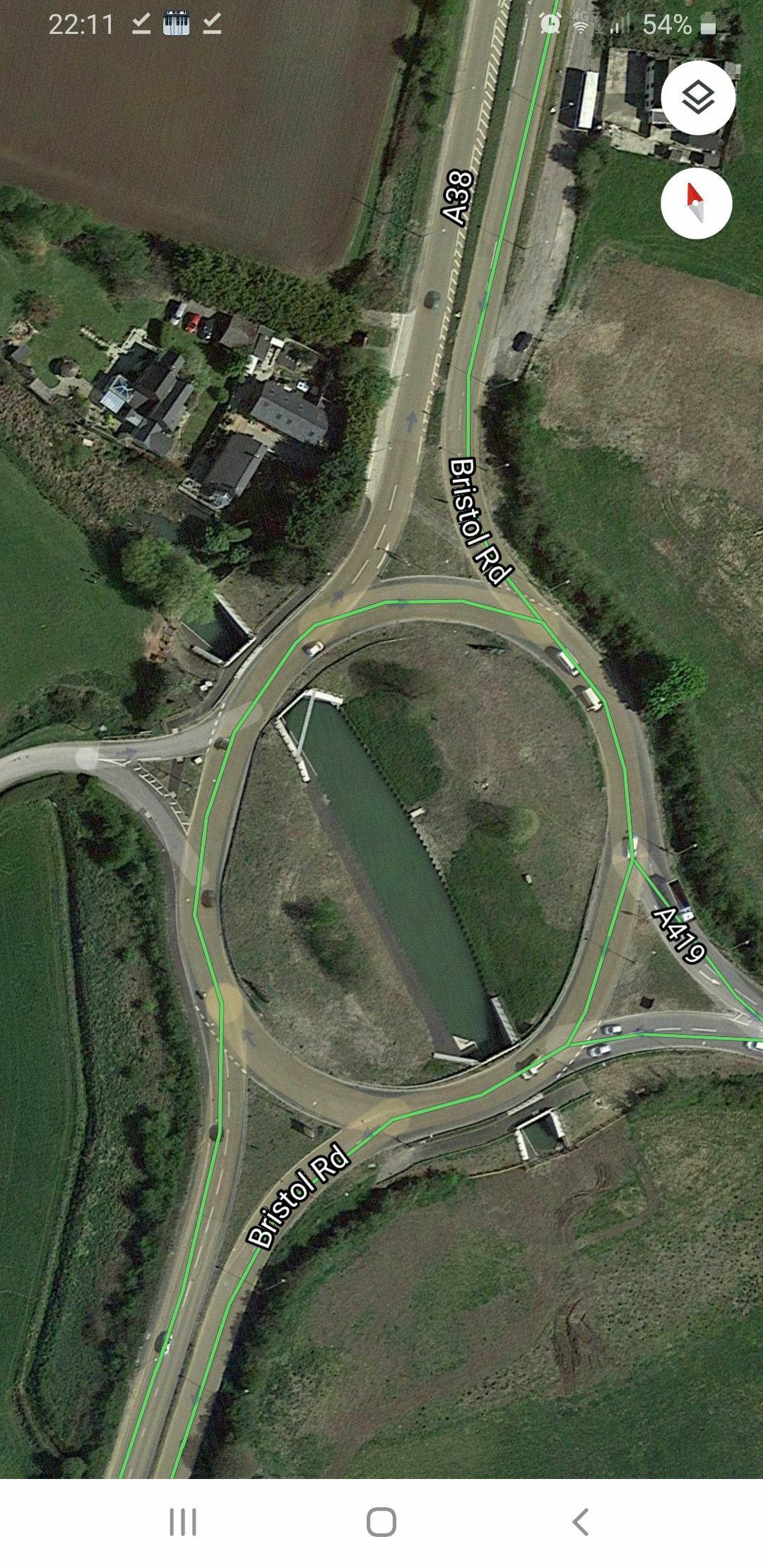

If anybody is interested,the Whitminster Roundabout ,scheme built by Alan Griffiths Contractors,has won prizes and is shown on the Cotswold Canal Trust website.

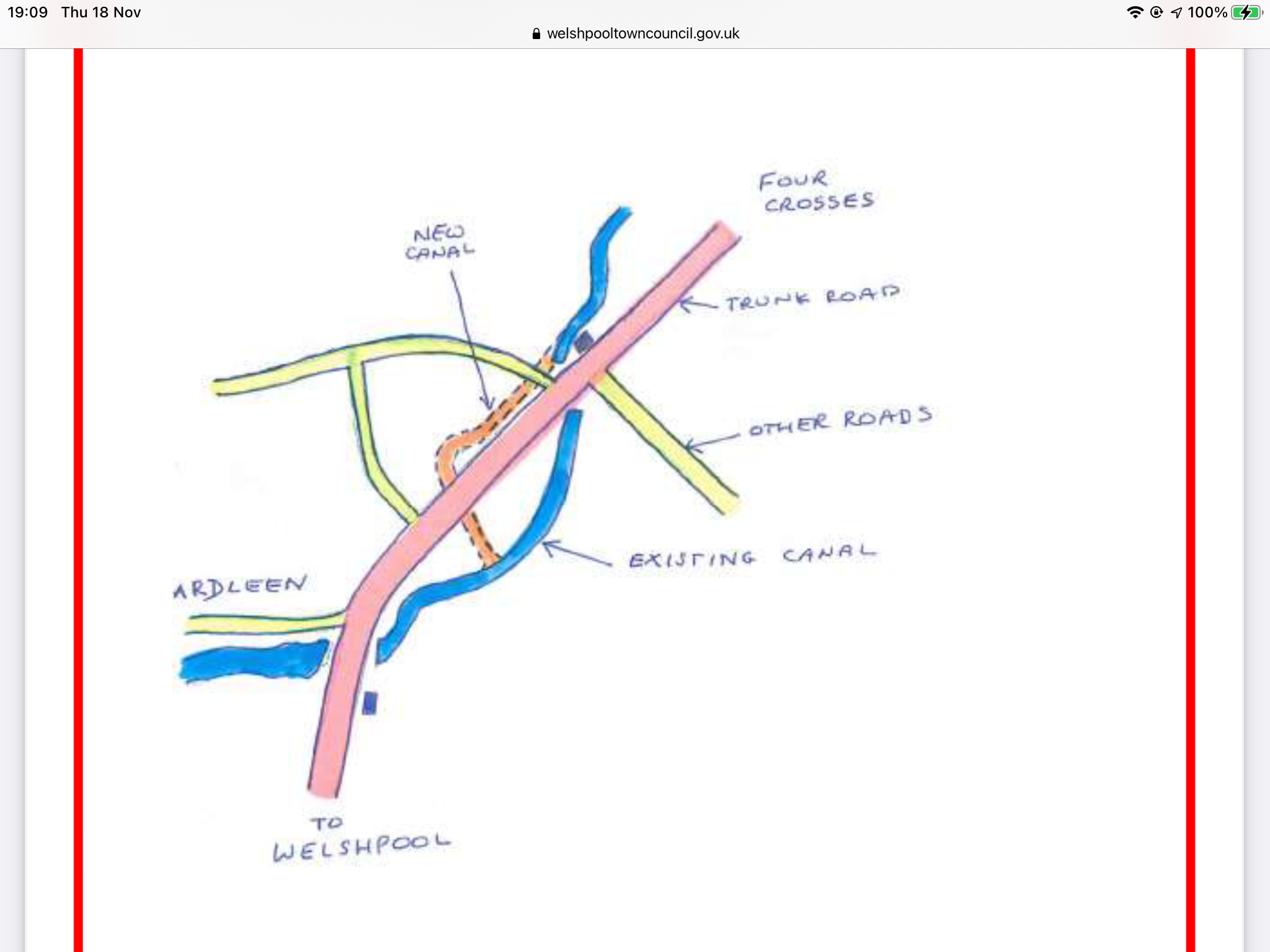

I’ve added a detail map from the Welshpool Town Council  (2016) published report below, showing the plan at Arddleen. The new lift bridge will be needed on the minor road on the diversion, the egregious drop lock on the lower re-crossing of the A483.

What stops them putting in a longer diversion so the canal no longer crosses the A483?
Good question David :-).
 Unfortunately, the answer when you look at an aerial view or the OS map is easy to see: Arddleen. The village lies between the two secondary roads and is packed in pretty dense. No way through for the cut, and IIRC the land rises slowly as you move westward, so a ‘grand deviation’ around the back of the village wouldn’t be on the cards as the land would be too high.
To go round Aardlin would mean a far longer brand new cut around new housing estates and land destined for more,  and a new lock perhaps. The existing plan utilises the Maerdy Brook floodplain and an existing culvert under the A road
Just looked at Google earth and seen the problem. But if that bridge over the Maerdy Brook is is suitable for the canal then the diversion for the first A483 crossing makes sense, and would be relatively low cost.

The first crossing - and the new canal that has to be cut, plus the new lift bridge on the B road - actually adds up to a lot more that the dratted drop lock they are proposing for the southern crossing.
In 2016 money £3.75M for the ‘Northern’ works, and £1.6M for the drop lock.  I suspect they may be planning to put the drop lock on the site of the old railway that passes under the 483 just next to the canals, but that’s just a guess.
Why not build it in the existing canal line?
And why can't the existing road level be raised (along with the side road to the east)?
Edited by David Mack
Hi David, one could.  I was thinking that the track bed was a lot lower than the canal and passed under the 483 in a real culvert.
Just checked and I must’ve been dreaming! It runs maybe 5’ lower than the cut, but is as thoroughly obliterated as the Canal is by the 483.  So probably they will stay with the line of the canal, unless there are some secondary reasons for moving slightly to one side (eg keep the water flowing through the extant culvert, less hassle keeping the works dry until ready for flooding, etc).
Regarding raising the road levels, above my pay grade that one. If you want more guesswork as to why not I’d suggest the answer lies in the following points:
1. Acceptable sight lines for a high speed road (60 mph there??) around that junction
2. Length of the ramps required to provide these and comply with current regs.
Leading, I assume, to £MM price tab, way higher than £1.6m (never mind all the bitching about congestion during the works etc)
Now the cynic in me growls at these arguments, cos if the Mont had been open when they wanted to put the 483 through (the current alignment is new from the last set of improvements) they surely would’ve found a way of doing it.
Edited by Tarboat Tim

Ignoring the snide comment, the A38 roundabout had an easy way to arrange a diversion around one side of it whilst the work was under way, this would not be available on the A438.

I'm not sure the residents of Maerdy Cottage would be too happy to have a new road embankment on the side of their house!

Hi Graham, I agree about the road - I think the drop lock may be the only game in town, but I detest them.  Two separate locks with a 100-200 yard pound between them would be much easier to work and safer, but would cost more to do. So we’ll get a 7’ version of that abort**n in Glasgow.

The Bristol Road roundabout work on the Stroudwater has recently been completed By Allan Griffiths, payed for by the Highways Agency. This involved two road bridges and major works to both carrage ways. The cost was,apparently 4 million. This may give an idea of the cost of the works needed at Ardd lin.  Bridge 103 and bridge102 Maerdy Bridge, Montgomery Canal,( lowered)
