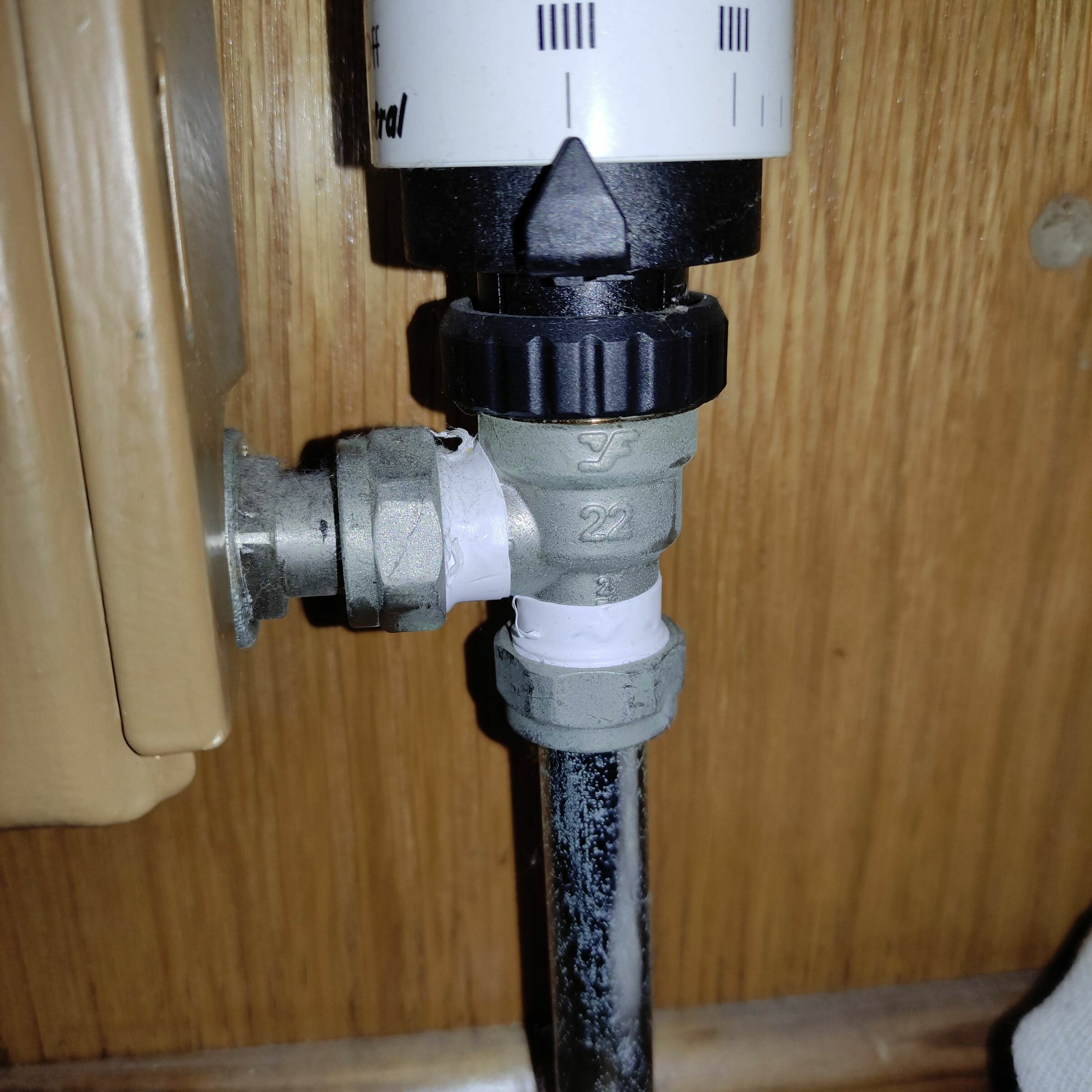

blackrose Posted October 30, 2021 Author Report Posted October 30, 2021 (edited) I bought another refurbished Webasto for £350, ripped the noisy one out and fitted the "new" one today. Problems solved. It runs very quietly even without the exhaust silencer and it doesn't cycle up and down. All rads, calorifier and fan heater are hot. I obviously bought a duff refurb unit the first time which is always the chance one takes on these ebay units. I'll take it apart at some point, find out what's wrong with it, fix it and keep it as a spare. The new one came with a 6 month warranty (for what its worth) and the guy who sold it to me ensures me it's a good one and has been properly serviced. Edit: spoke too soon. Two of my 4 rads (rads 2 & 3) get hot at startup and stay hot for about an hour, but then they seem to shut down. The flow pipes to these rads stay hot but the rads themselves become only warm. Rad 4 stays hot. I guess the thermostatic radiator valves on 2 and 3 must be faulty? The CH system hasn't really been used for 12 years. Edited October 30, 2021 by blackrose
Chewbacka Posted October 30, 2021 Report Posted October 30, 2021 3 hours ago, blackrose said: I bought another refurbished Webasto for £350, ripped the noisy one out and fitted the "new" one today. Problems solved. It runs very quietly even without the exhaust silencer and it doesn't cycle up and down. All rads, calorifier and fan heater are hot. I obviously bought a duff refurb unit the first time which is always the chance one takes on these ebay units. I'll take it apart at some point, find out what's wrong with it, fix it and keep it as a spare. The new one came with a 6 month warranty (for what its worth) and the guy who sold it to me ensures me it's a good one and has been properly serviced. Edit: spoke too soon. Two of my 4 rads (rads 2 & 3) get hot at startup and stay hot for about an hour, but then they seem to shut down. The flow pipes to these rads stay hot but the rads themselves become only warm. Rad 4 stays hot. I guess the thermostatic radiator valves on 2 and 3 must be faulty? The CH system hasn't really been used for 12 years. Maybe the thermostatic valves are set too cool, try turning them up, or better still remove them.
blackrose Posted October 30, 2021 Author Report Posted October 30, 2021 (edited) 18 minutes ago, Chewbacka said: Maybe the thermostatic valves are set too cool, try turning them up, or better still remove them. They were turned up as high as they could go. I tried turning them off and back up again but it didn't help.. I don't really need these valves. Can I just replace them with some sort of right angled coupling? Just looking on Screwfix - do I need to replace the lockshield at the other end of the rad too, or would I just replace the mixing valve with another one of these? What does a lockshield do anyway? https://www.toolstation.com/drayton-angled-lockshield-with-white-cap/p17903 Can't figure out what sort of connectors I need. Would these work or should I get them without the isolator valve to keep them open bore? https://www.toolstation.com/service-valve-angle/p61780?store=OG&utm_source=googleshopping&utm_medium=feed&utm_campaign=googleshoppingfeed&mkwid=s_dc&pcrid=515847200312&pkw=&pmt=&gclid=EAIaIQobChMIrMWUlv7y8wIV4u3mCh3oqw8zEAQYByABEgJxufD_BwE&gclsrc=aw.ds Or these and take the compression nuts off? https://www.screwfix.com/p/flomasta-compression-equal-90-elbow-15mm/33526?tc=JT6&ds_kid=92700055281954514&ds_rl=1249404&gclid=EAIaIQobChMI5ICS-__y8wIVDpftCh2ehArLEAQYBiABEgL5OvD_BwE&gclsrc=aw.ds Why do my valves say 22? The vertical pipe is definitely 15mm. Edited October 30, 2021 by blackrose

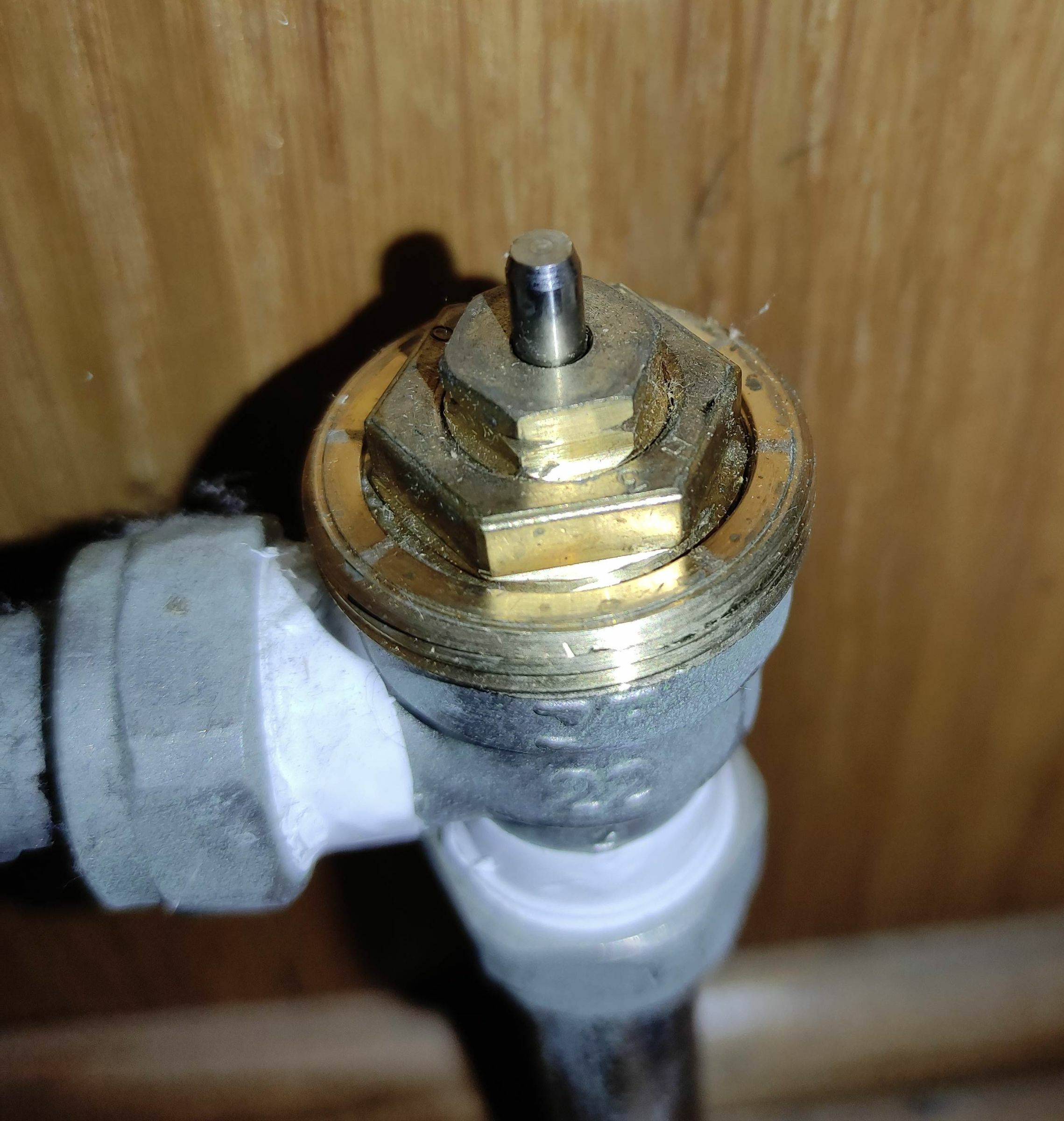

GUMPY Posted October 30, 2021 Report Posted October 30, 2021 Unscrew the black ring below the valve head and remove the head, this should cause the valve to defalt to fully open. once done you could also pull the pin thats exposed up gently to check its fully open.
blackrose Posted October 30, 2021 Author Report Posted October 30, 2021 (edited) 1 hour ago, Loddon said: Unscrew the black ring below the valve head and remove the head, this should cause the valve to defalt to fully open. once done you could also pull the pin thats exposed up gently to check its fully open. Thanks. I didn't realise the head came off so easily. I tried gently pulling the pin up with a pair of pliers but it's not moving. If something inside the valve is stuck down or is being activated when the water gets hot, removing the head won't help will it? Do I need to replace the valve with a plain right angled connector? Edited October 30, 2021 by blackrose
GUMPY Posted October 31, 2021 Report Posted October 31, 2021 I've not seen one stuck internally, normally if the pin is up it's open. https://www.screwfix.com/p/chrome-angled-radiator-valve-15mm-x/33920 Should do the job, sometimes the TRV is a slightly different size so the pipework may not line up. At that price it's worth changing both ends in case the other end has a blockage and while your about it take the rad off and flush it through with a hose.
