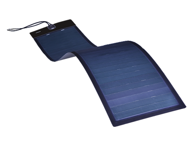

Philip Posted September 18, 2021 Author Report Posted September 18, 2021 (edited) Also I have seen this one - https://www.bimblesolar.com/solar/small-panels/70w-mipv-flexi This is CIGS, is this an amorphous type? Any pros or cons to this type? Edited September 18, 2021 by Philip
