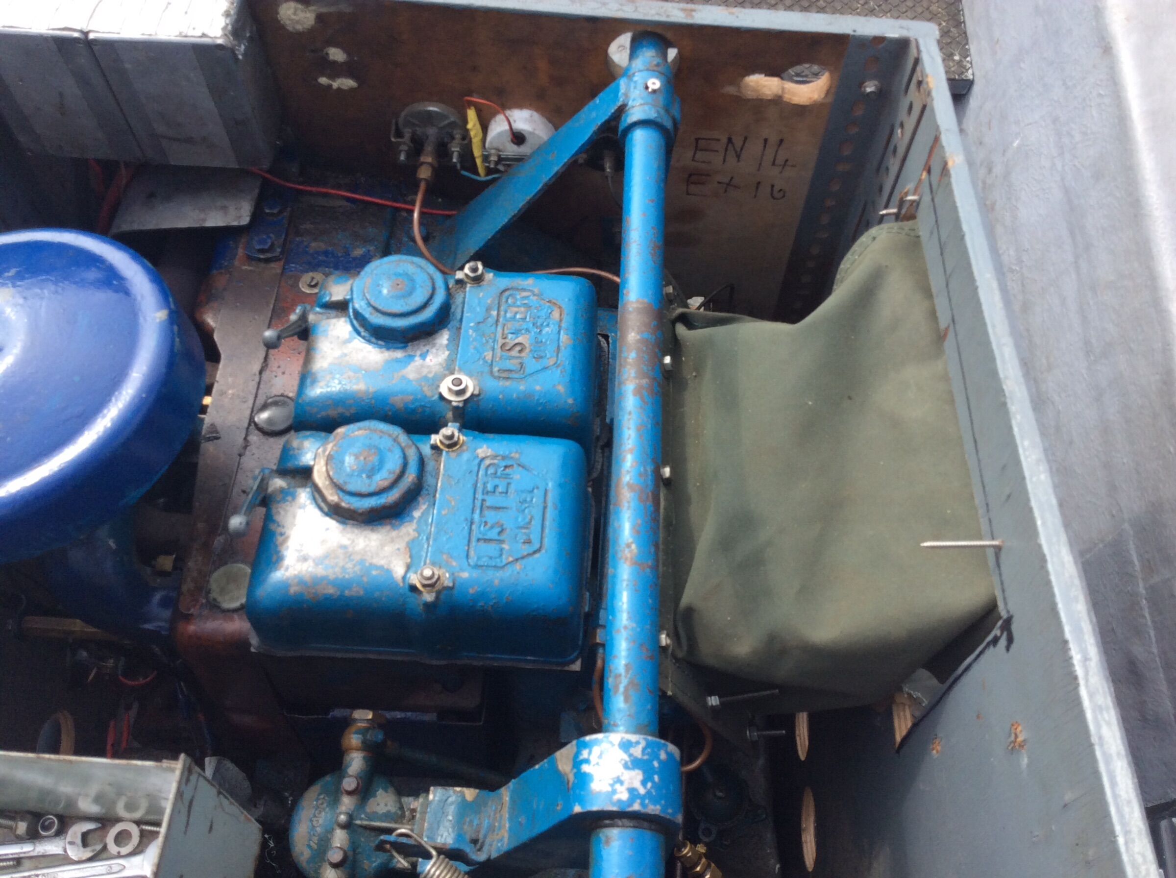

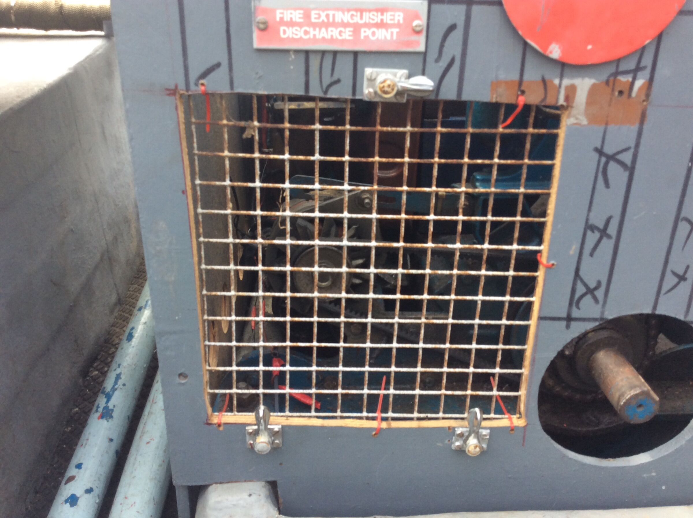

Roxylass Posted August 21, 2021 Author Report Posted August 21, 2021 Took the engine box off and made sure that the engine was getting plenty of cooling air i will try to post some photos later. Took a run to rosyth dockyard on the water roughly three miles not even half throttle i have fitted the canvas that I bought from primrose engineering thanks sue Plenty heat exiting from it also blue smoke circulating around the engine box engine hot to touch but didn’t cut out this time when I put it to idle starting to think now that it could be the fins needing cleaning i have had the exhaust and inlet manifold off can only see a bit of the fins cant seem to be able to remove the air baffles Do the cylinder heads have to come off to carry out this operation
Tony Brooks Posted August 21, 2021 Report Posted August 21, 2021 (edited) 15 minutes ago, Roxylass said: Took the engine box off and made sure that the engine was getting plenty of cooling air i will try to post some photos later. Took a run to rosyth dockyard on the water roughly three miles not even half throttle i have fitted the canvas that I bought from primrose engineering thanks sue Plenty heat exiting from it also blue smoke circulating around the engine box engine hot to touch but didn’t cut out this time when I put it to idle starting to think now that it could be the fins needing cleaning i have had the exhaust and inlet manifold off can only see a bit of the fins cant seem to be able to remove the air baffles Do the cylinder heads have to come off to carry out this operation Our SL manuals had diagrams of the hooks that were to be used for cleaning the fins by just taking the cooling air outlet side cover off, but I still wonder about the possibility of having an air directing baffle fitted upside down, so one cylinder is not being cooled properly. If this is the case, the heads will have to come off. This file:///tmp/LR%20&%20SR%201,2,3%20Industrial%20MPM%20027-08013.pdf suggest it does have a baffle but no illustration. Incorrectly fitted baffles are a known cause of problems. Edited August 21, 2021 by Tony Brooks

Roxylass Posted September 5, 2021 Author Report Posted September 5, 2021 Hopefully should be okay for air now One more
Tony Brooks Posted September 5, 2021 Report Posted September 5, 2021 I hope so as well, but am still bothered about no comments on any air duct between the cylinders.
Roxylass Posted September 5, 2021 Author Report Posted September 5, 2021 Tony she will be put on a hard standing end of this month good couple of hours running today in the river forth every half hour touched the rocker covers they were just a nice warm got back to the moorings idling as it should pulled the engine stop touched the rockers five minutes later to hot to touch heads will be coming off and fins cleaned in a ultrasonic cleaner is there a diagram anywhere showing how the baffles should sit thanks for your advice
Tony Brooks Posted September 5, 2021 Report Posted September 5, 2021 9 minutes ago, Roxylass said: Tony she will be put on a hard standing end of this month good couple of hours running today in the river forth every half hour touched the rocker covers they were just a nice warm got back to the moorings idling as it should pulled the engine stop touched the rockers five minutes later to hot to touch heads will be coming off and fins cleaned in a ultrasonic cleaner is there a diagram anywhere showing how the baffles should sit thanks for your advice I think there was in our SL4 manuals, but I have not seen any in the common SL/SR manual. If you have one in a twin, then I think it might be possible to work it out by eye, otherwise a PM to RLWP or Bizzard once you have access should provide a definitive answer.
