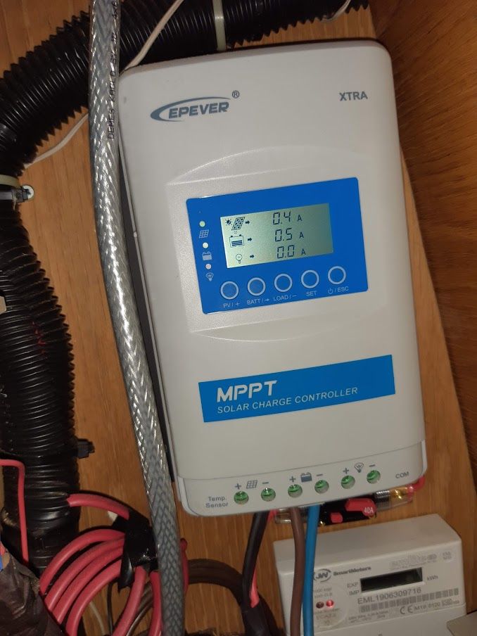

Can anyone help me with how I can alter the settings for the Float Voltage on the above Controller. I can get to the part where I select User Defined Battery but cannot get to the part to then alter the individual settings?

That is the manual I got with the unit. The screen has a display and buttons.
