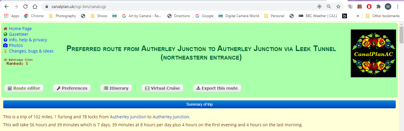

Will someone please clarify my understanding . I have punched in Autherley junction to Leek tunnel ( northeast ) Return.      I am getting  7 days 40 minutes  at 8 hours cruising per day . Plus  4 days cruising on first day , and 4 days cruising on the last .  Is this first and last day included in the 7 day total , or additional to it ? Thanks

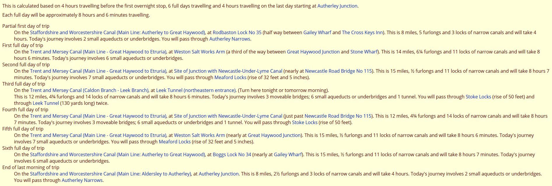

Doing some playing with and without the first\last day hours it looks like it adds extra days as if you look at the overnight stops you get more stops when adding the first\last day hours in.
If you change to use start and end dates then it plans hours per day constrained by those dates including the number of hours in the first and last days.

I think the word plus in this quote from the calculation answers the question.
This will take 56 hours and 39 minutes which is 7 days, 39 minutes at 8 hours per day plus 4 hours on the first evening and 4 hours on the last morning.
The 56 hours is 8 days  so the plus implies to me the 2 x 4 hours are on extra days.

It doesn't say anything like that when I put it in.  Is it something to do with putting start and finish times in?
In any case, the whole trip takes c.56 hours which is 7 days.  Not 56 + 4 + 4 = 64 hours.  So it's 7 days.

If you enter parameters as 7 hours per day and 4 hours for the first and last days then it spreads the journey over more days, you can see this by checking the overnight stops.  As I posted above if you put start and end dates instead of hours per day then it keeps the journey to with in those dates and uses the hours for first and last days specified.  Therefore it is possible to have the 7 day trip take 8 days depending on how you configure the cruising days.

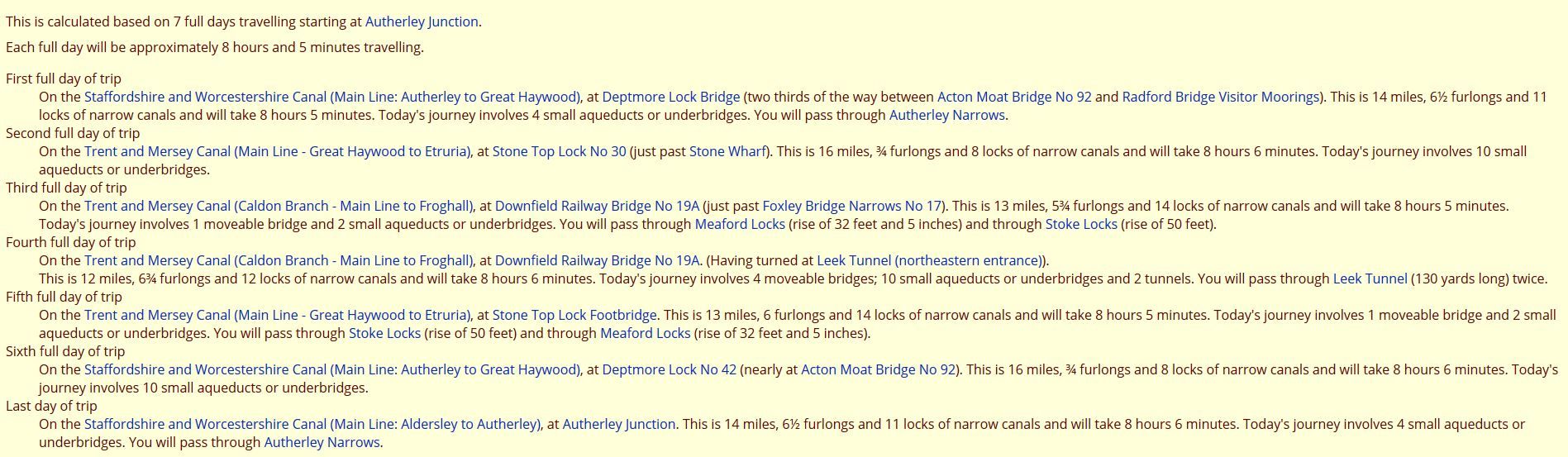

Aha.  I see now.  Canalplan makes it confusing then in the way they write it.  It's therefore:  A half day, the 6 full days, then a half day.  So 8 seperate days.

OK. thanks, I had put in the first and last days as 4 hours because that's about the time allowed by a hire company on those days . Pick up time is usually after 3 pm . and drop off time around 10 am . However I better understand the wording now .
