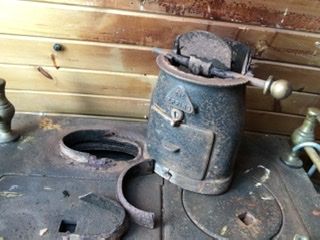

I knew my Epping had issues but I didn’t think it would be this bad!
not only has the top rim of the damper box corroded and broken in two but the socket on that receives the box on the top plate of the stove has gone the same way!
What do I do now? Apart from weep!
I’m guessing these bits make hens’ teeth seem commonplace: is any of this repairable, might the rest of the stove be as bad - and should I be thinking of cutting my losses, hauling it out and sourcing some sort of replacement?ACD7048C-6305-4E7A-982F-7302E7532ADE.jpeg.e4f8cb7b6ccc08b0dd1b81a78c478ffa.jpeg

A good fabricator with a steady hand and a box of cast iron welding rods?
I don't know how successful it would be, but it might be worth asking the question as it's looking quite poorly otherwise.  Has anyone else tried this on an old Epping?

Mine went a similar way a few years ago. Not quite as bad as yours, so I bought a new smoke box ( I think that's what the part in the pic is called) Reassembly with plenty of fire cement kept it going for a few years. Then the top plate cracked in half, which was, I thought at the time, terminal. However all parts are (or were, until recently) available if you wish to rebuild it. In the end I bought a new one. The company which makes them is owned by Pete Dufficy. I have his number if you wish to speak to him.
