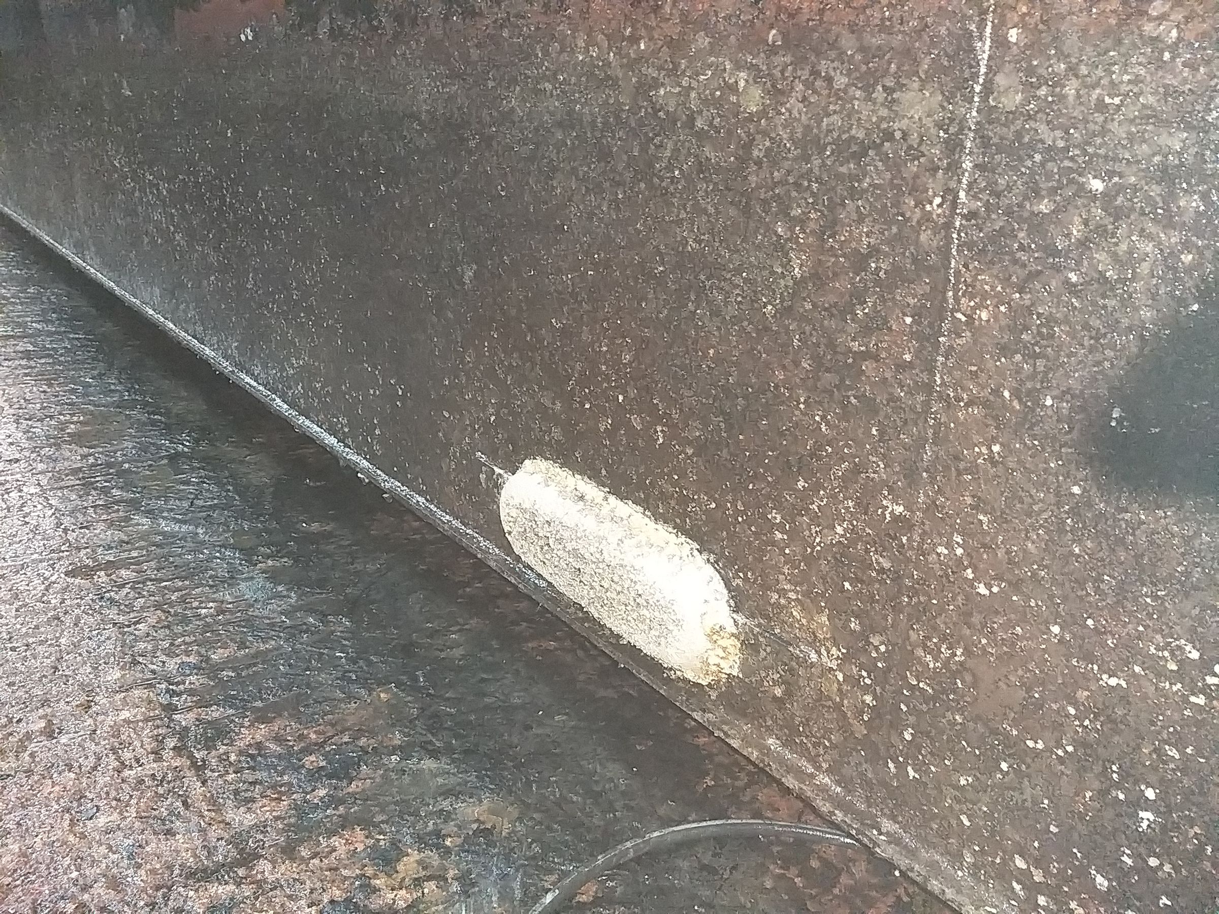

On 15/02/2020 at 08:13, matty40s said:
Normal corrosion occurs generally at the waterline, slow to occur, deep red/ brown colour and often results in delamination as it progresses.
Galvanic corrosion occurs at all levels underwater, is typified by bright orange ''pustules' of rust in rashes, when washed off leaves bright silver pits. It normally doesnt happen near a working anode....here, less than 2 feet either side is protected.
So this is an example of galvanic corrosion? To be honest it looks the hull of any pressure washed boat in reasonable condition. Most boats that I've seen have some corrosion all over, not just at the waterline  Anyway, if this really is galvanic corrosion why did it happen? Was the boat left on shore power without any form of mains earth isolation for example?
