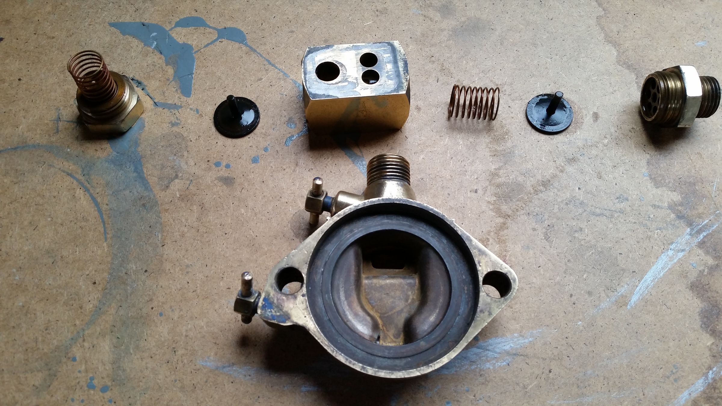

My Sabb GG engine is s overheating after running for 5 minutes. I've taken the water pump apart and cleaned it and the water line is clear but seems low pressure. Doesn't seem to be providing enough pressure to go into engine. No water is pumping out of exhaust which It should do. Any suggestions?
Is this the standard diaphragm pump?
If its not a split diaphragm have you checked the one way valves are working OK?
Pic of my 2j pump bits -think yours is same?

Same as yours.  I'm not sure. I just opened up every bolt and cleaned and sucked everything through.

I think I would be tempted to run the engine and (briefly) disconnect the pump outlet. That should help you see where the problem lies and be a good starting point of where to look next.
Problem sorted. The problem was definitely a clogged pump. I replaced it with my spare pump as I couldn't get last bolt off to clean inside. Need to put it in a vice. Just glad it's s simple fix.
Glad to see your sorted B2019- like you say they are simple enough (if you have that vice handy)-though does amuse me how that valve block is held on with that bit of steel -thought mine had been bodged when I first saw it ?

Bing, bang, bosh engineering that any idiot can repair but still chugging after nearly 60 years of punishment. Like to see if it outlives most new engines.
