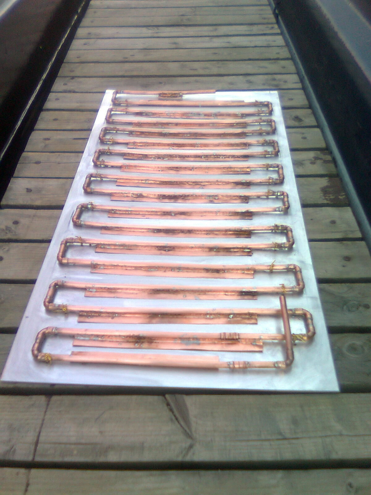

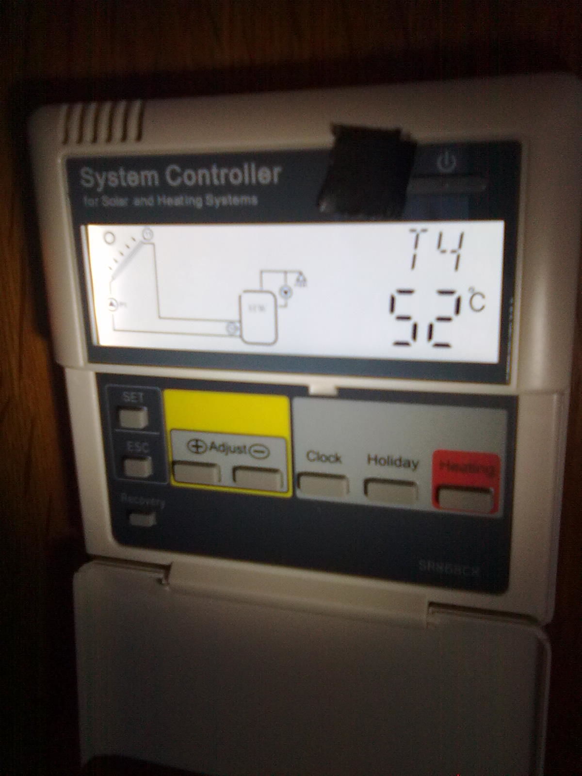

As you can see.....I soldered copper 'tags' to the copper pipe..and these were then bolted firmly to the aluminium plate...so maximum heat was passed into the pipe. I sprayed it with matt black thermal paint (Halfords) ....then enclosed it in a box with glass on one side ( the non pipe side )..and roof insulation on the other with a layer of tin foil between the roof insulation and the pipe side..so sun heated the aluminium plate on the matt black painted side...and any that passed through the plate was reflected back. It worked a treat. I've since sold this boat and removed the 12 volt controller. Its in my garage..languishing.. It has two thermal sensors...one on the tank and one on the roof collector...the unit has a differential controller to stop it pumping your hot water up to the roof should the plate outside be colder.
I made this collector.....10mm pipe. Couldn't believe how well it worked. Burnt my fingers while bleeding it on an overcast day !
