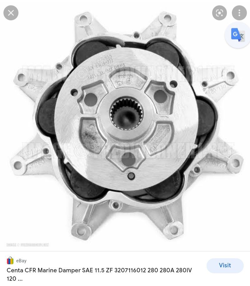

This is an R type damper. You can obviously get them supplied with different options of backplate and spline to suit the application. As you can see they have rubber rollers that run up ramps. So any torque applied is gently taken up by the rollers.
The Gardner I did this mod on was the same set up. Trad style engine room long prop shaft and a big propeller. That's a lot of inertia. I've bought a couple over the years directly from Centa Transmissions Ltd. They were based in Shipley, close to Bradford. But I think now they have moved. I used to get them through a work colleague who was there marine sales engineer, but unfortunately he has now moved on to another company. I'm not really sure of the cost, but considerably more expensive than your typical R & D plate. But in my opinion so much better and well worth it.
Many years ago I had a similar issue on a Gardner engine. There was always a very noticeable clunk as it went into gear. To rectify I fitted the engine with a Centa Transmissions R type drive plate. This worked wonders and really smoothed out and quietened down the gear selection. I have used this plate on numerous engine installations with great success. I think the reason that the engine manufacturers don't use it as standard is as always down to costs.
