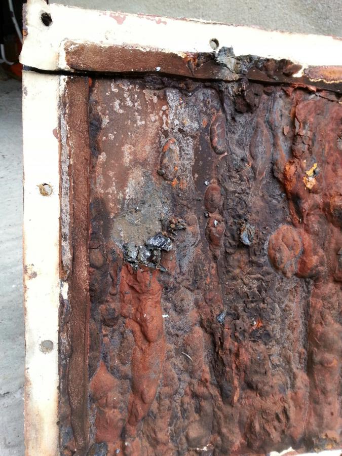

Just embarked on some long overdue water tank maintenance, not done since I've owned the boat. Now I know why I've been putting this off for so long. My tanks form the sides of the well deck, so there are 2 of them, each 2 m long, one each side connected by a ballance pipe. So twice the agony. After draining and opening the side mounted access panels, the inside looked frightening with large encrustations down the sides of the tanks, which look like it could be rust. Photo of access panels shows the sort of stuff. My first thought was that it was lots of rust, but it yields to a scraper leaving a very pristine surface of the original plating, no obvious rust or pitting. The encrustations are very black, soft and crumbly beneath the crusty superficial rusty looking tint on the surface, I wonder if it is a degradation product of the previous coating, which I assume was some kind of bitumen. It has actually done a superb job of protecting the steel, even after many years (>9 ) of no tank maintenance. My question is what does the forum recommend as a coating now, since I discovered today that the bitumen product stocked by Midland Chandlers is no longer WRAS approved for potable tanks. I was checking the manufacturers (Everbuild BlackJack) Tech data sheet for coverage, and there they state there that it is 'not suitable for potable water tanks', On the tin it used to say it was. Edit to add: Everbuild confirm the product is no longer certified and should not be used for potable tanks.
