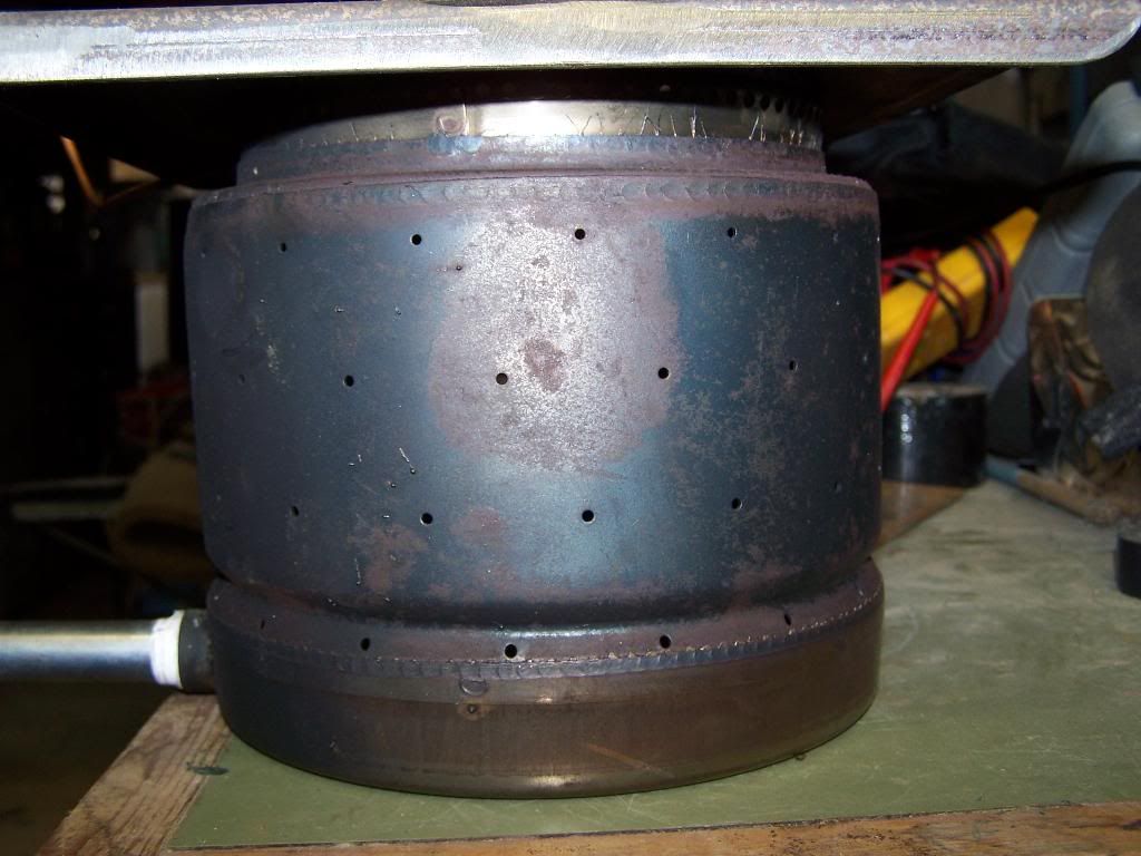

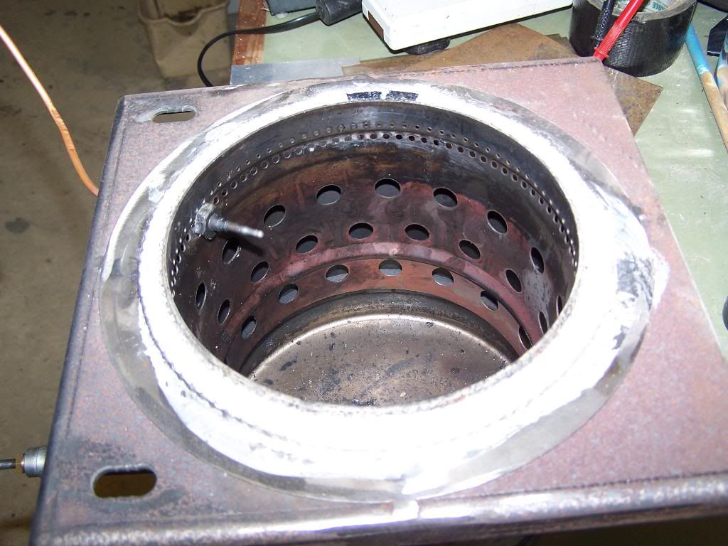

I just installed a new firebox in a 71m Refleks diesel heater, seems much better than the old rusty one, no soot coming out of the chimney , but the flame looks pretty much pure yellow, should it be more blue? Any hints or tips?

Here's a couple of pictures of my Kabola E5 pot (removed from boiler and catalyser taken out) which shows the holes I mean - ALL of them must be unblocked and ALL the air going up the flue must pass through them.

I think the "diesel inlet" you've seen in my photo is actually the flame failure themocouple tip. Do Bubble stoves not have these to cut off the fuel if the flame goes out?. The actual diesel inlet is the silver coloured pipe entering the bottom of the pot which you can see in the 2nd photo. I think all mfrs burner pots work the same way in this respect.
