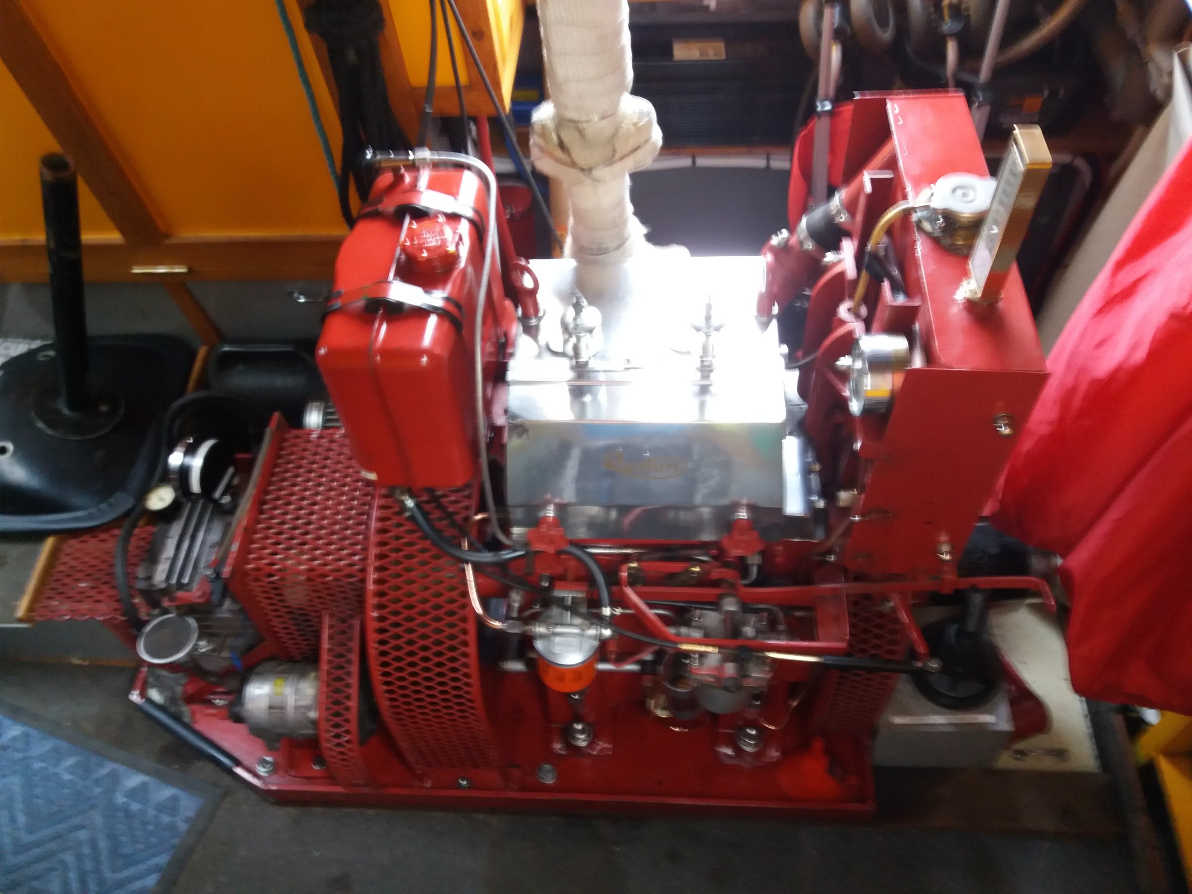

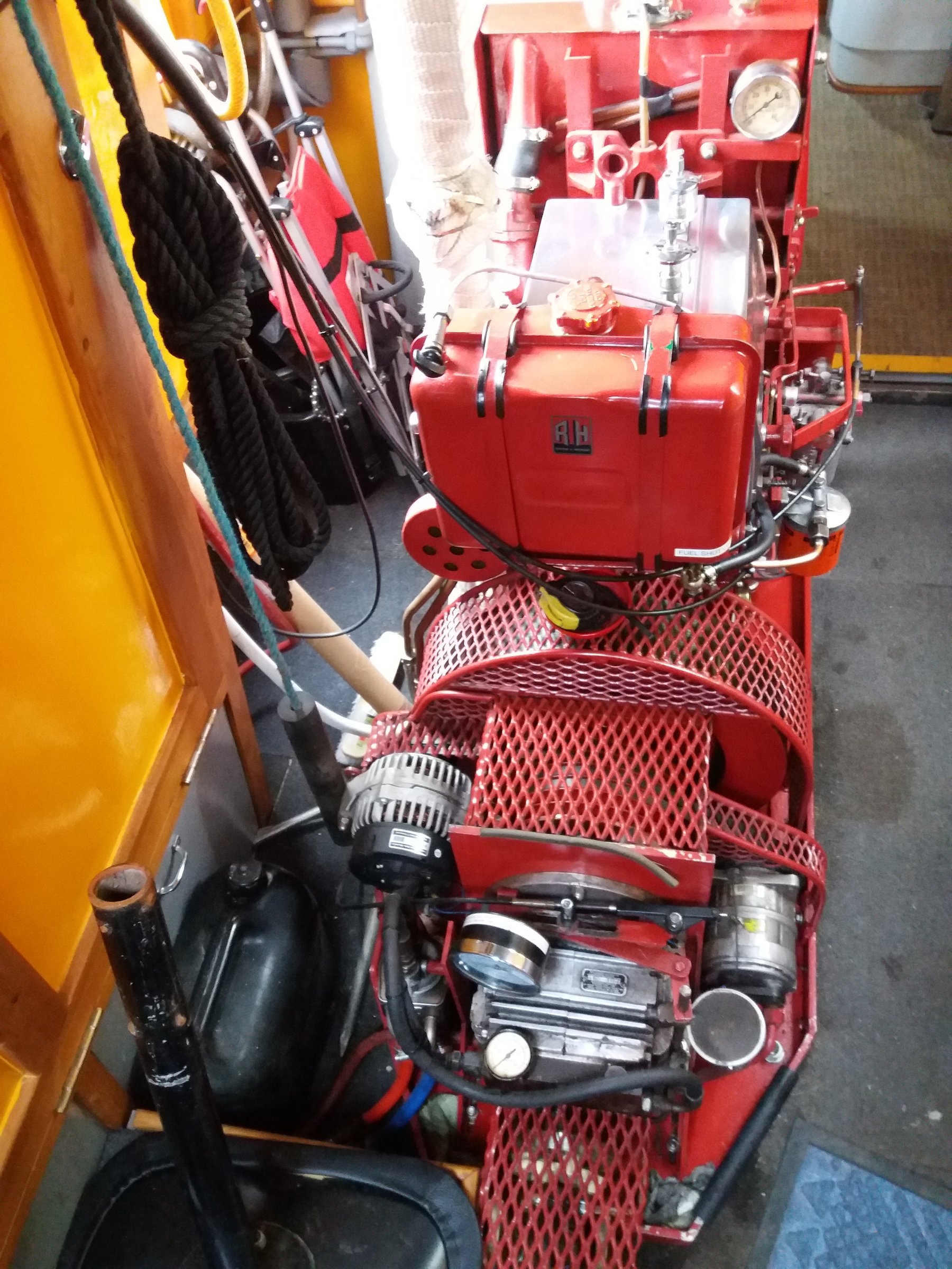

Ok, so it's not very fast, but it does get there.. to get around the governed max rm of 1000, I have fitted a separate wire throttle off the top of the governor arm which allows more revs when needed, (got the idea from a friend's Kelvin J2 which had one fitted) only really for getting loose when aground or stopping, though it did achieve 4mph with about 1200 rpm along the moss straight.. Going to fit a slightly bigger prop too and then i'll leave it as it is.. My friend has a fully recon HR2 he's trying to sell me, which will fit the engine hole, but that would be quick and wouldn't sound as nice.. I get a lot of comments from passers by, one chap was telling his wife about the steam coming out the chimney, lol, another asked if it was a standard diesel engine? and one chap asked if it was a bolinder...!! I wish...
