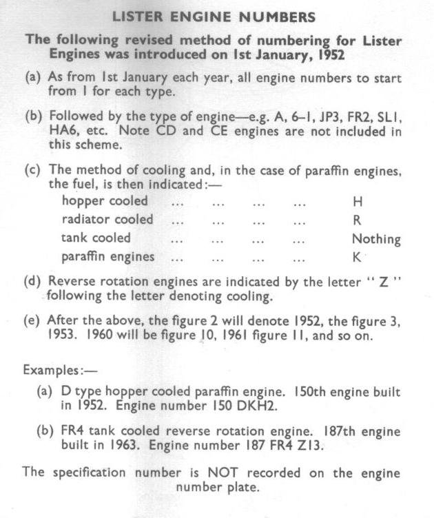

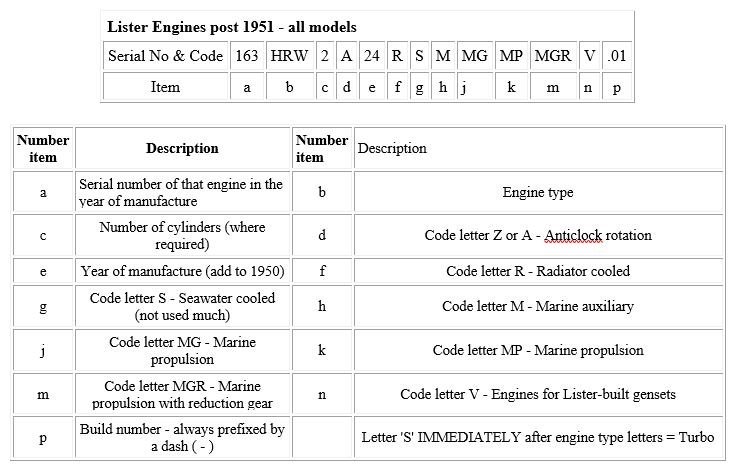

Here's two useful guides (although contradictory!) Neither offer any explanation for what 'E' denotes, however, as I already know my engine to be a semi-marine (intended for a boat, but not the main propulsion engine - mine was a pump for deck washing on an IoM ferry!) I'm therefore assuming E to mean semi-marine. Mine certainly isn't (and hasn't ever had) electric start.

Yes, the top one is what I found.
I wonder about the logic of starting a numbering series in 1952 but taking 1950 as the base year for dates.

Makes the mental arithmetic easier, with the last digit of the serial number and year of build being the same.

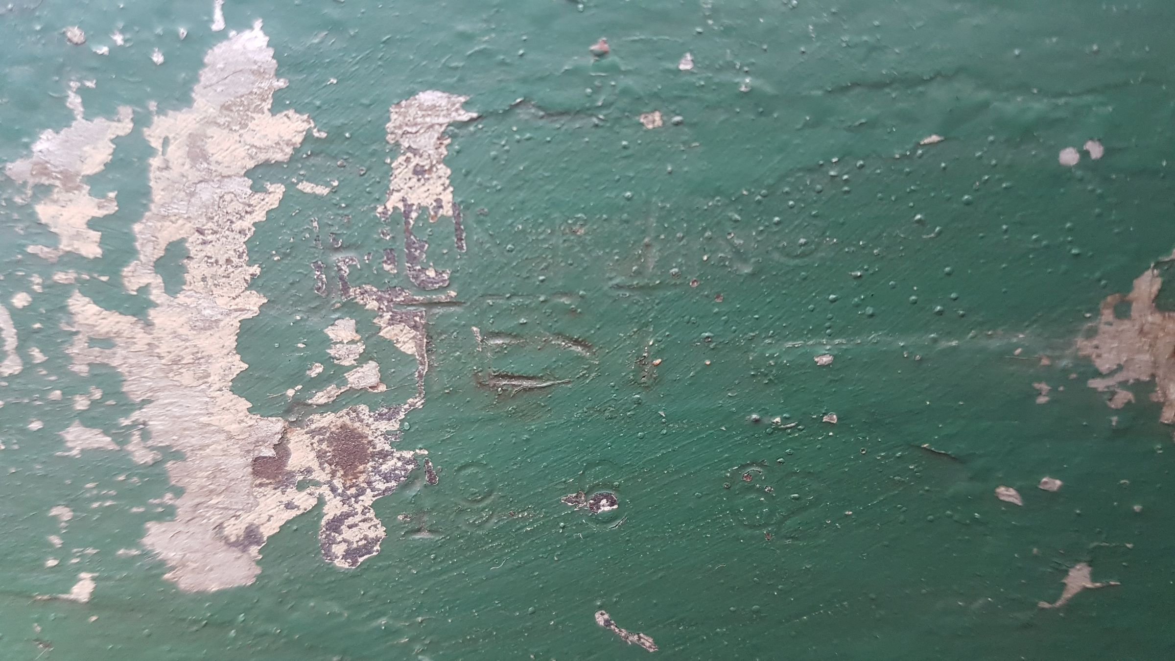

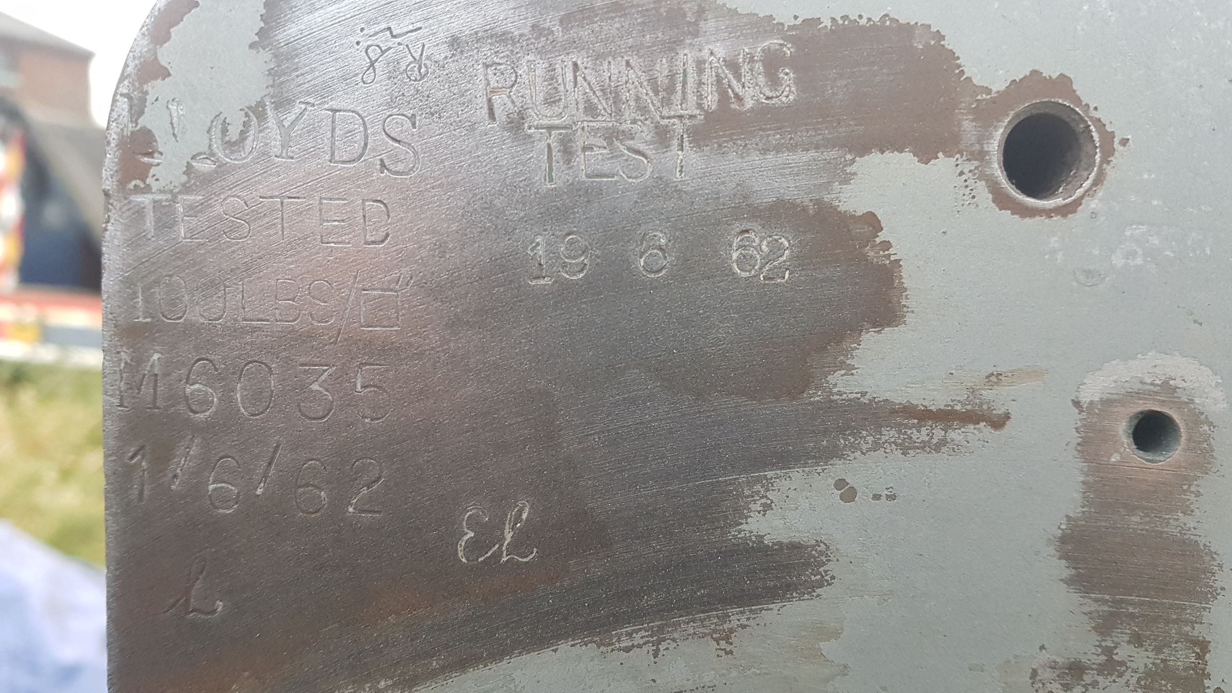

I was taking my flywheel off the other day (like you do) and noticed a stamp in my crankcase that I've never spotted before - it reads 'RUNNING TEST 19 6 62' - which I guess is the engine equivalent of a date of birth! I was very chuffed to find it, and means the stamps on the crankcase door, flywheel and now crankcase all match which 20191108_150003.jpg.b097976b32d6595da2068503509192d0.jpgis nice.
Worth checking on yours if you're still looking for something?
Update - having fetched the paint off I've also found a Lloyd's stamp - cool! Anyone know what the 100PSI is referring to?
