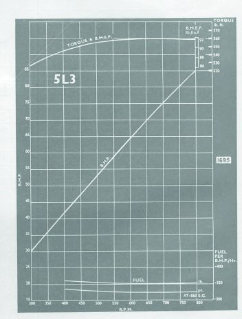

Split Pin Posted August 16, 2018 Report Posted August 16, 2018 (edited) Fuel consumption in gallon and lbs along the bottom of the graph Looks to be around 3.6 Gall per hr if fully loaded at 900 rpm The gearbox will be a 3UC not a 2UC Edited August 16, 2018 by Split Pin 1
Aussie Guy Posted August 16, 2018 Author Report Posted August 16, 2018 6 hours ago, Split Pin said: Fuel consumption in gallon and lbs along the bottom of the graph Looks to be around 3.6 Gall per hr if fully loaded at 900 rpm The gearbox will be a 3UC not a 2UC Thanks Split Pin, from the looks of things the quoted RPM is full throttle. Any suggestions on what RPM they are happy to run at all day long, can’t imagine flat out is a good idea. Modern engines would t like it but not sure about what these “old girls” are like. Re: 2UC, it definately says that on the documents I have.
Split Pin Posted August 16, 2018 Report Posted August 16, 2018 The books that I have relating to L3 engines list the Marine version as 900rpm max, Industrial versions were rated up to 1200rpm intermittent It would appear that the info given on the sales information is for max engine speed. I'm sure that it would run quite happily at full throttle all day long, although I can imagine that most would be run slightly below this for comfort. I don't have any experience of running an L3 (LW and L2 being my area of expertise) If you are on facebook you might try the Gardner Diesel Engine group for more information , I know that there are some members on there running L3's. Re the gearbox, 2UC boxes wont fit on L3 engines, (they are considerably different in size) It maybe that it has a 3UC type 2 which is causing the confusion. Steve
