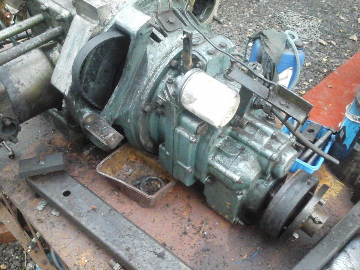

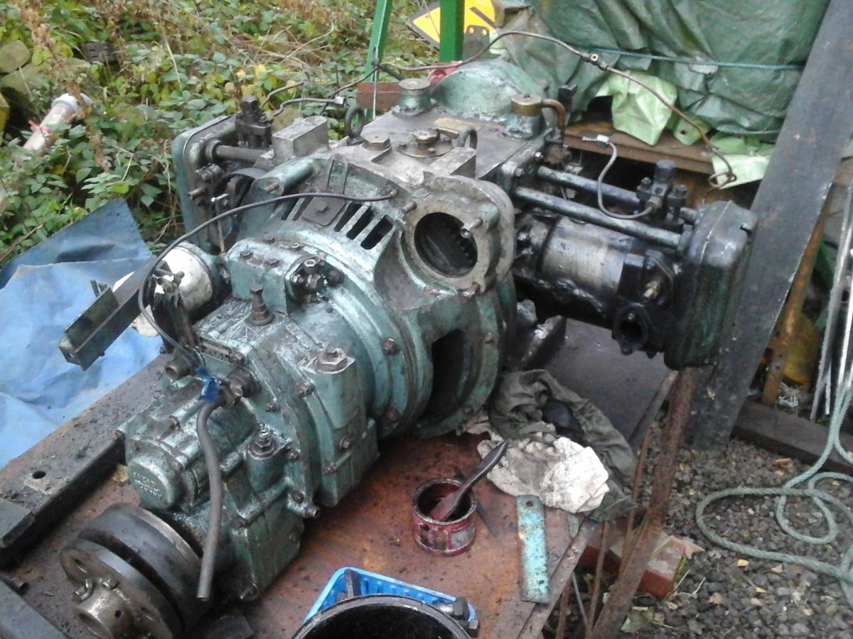

I know this post is old but just wondering if you still had you're coventry victor vixen hdw, i have one and need advice. I would add picture but dont know how???
Edited by Swinder09
Hey Swindler. Yes still running the same engine. Had heads and barrels off in spring due to headgasket going with engine oil in cooling water but running good again now. It's cool that someone else on this forum will be running one of these. Will answer any questions if I can. Haven't seen that type of gearbox on a CV ( or anywhere ) before. What is it ?. Thanks, Kieron.
Hey there, the gearbox on my coventry was made by 'BRB Precision engineering ltd'and is a type 19z 2:1 reduction.I dont think the company exists any more, however its a design of gearbox that has been produced by many different compaines over the years and is still being made by 'thamesway marine products' who call it the 'tmp type 12000 marine gearbox', which means all spares are still available.

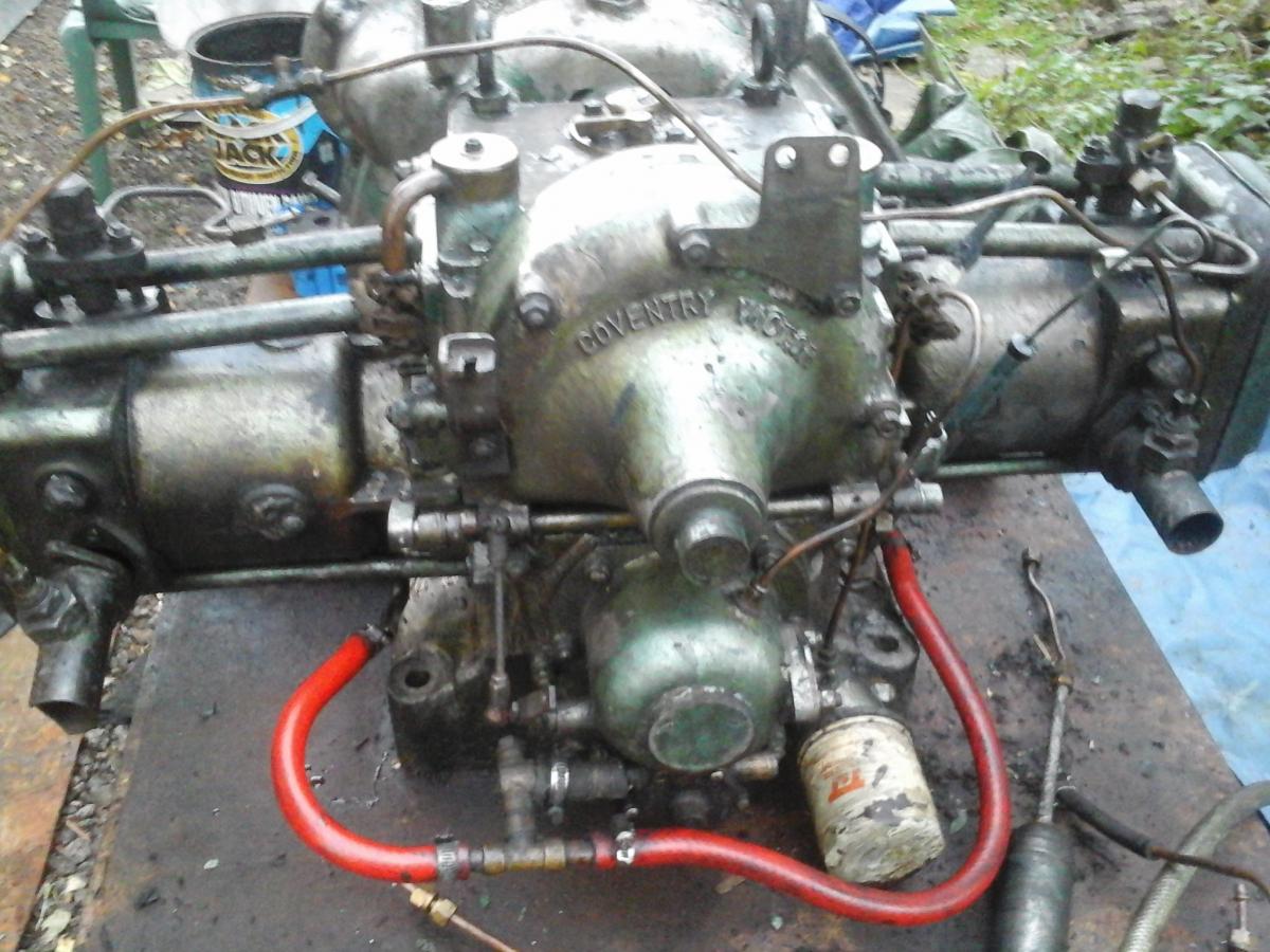

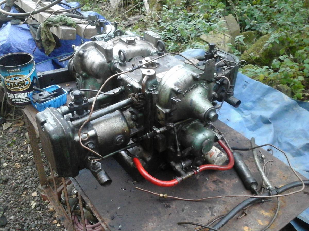

Hi Mick and Kieron, its SWinder (not swindler, im no con man!) as far as i am aware my coventry is almost complete. Although not on the photos i do have the starter motor, alternator and both injection pumps. The only thing missing is the linkages that connect the pumps together and control the revs. due to this i have not attempted to start the engine yet, although it does turn over freely, so dont know if anything else is missing or faulty as of yet. However it would help a lot if either of you could take some photos of these linkages to give me a better idea of what i need.

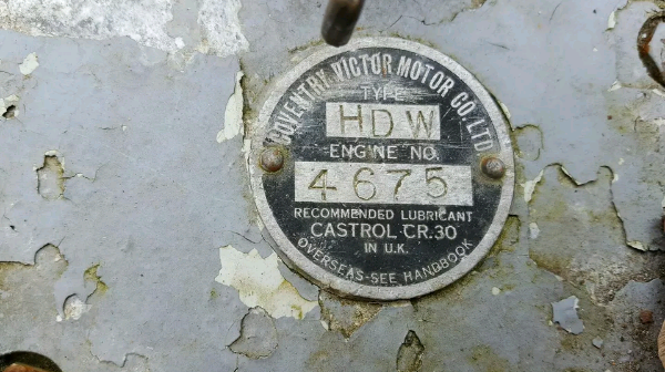

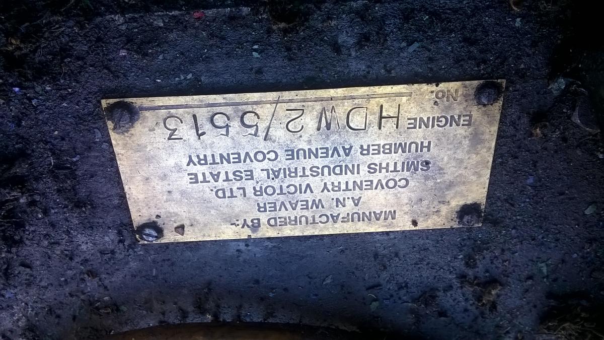

As for those coventry victor engines on ebay i dont think they are the same version as mine. Mine is the HDW2 which i think means mk2 whereas those for sale are both HDW probably meaning mk1's. Theres probably next to no diffrence between them but dont want to end up buying 2 more projects.
What mk engine do you have?

Hey Swinder , my mistake. Although Swindler does have a ring to it. I might have a spare throttle linkage for a later engine some where, i'll have a look. Thanks for that Suigeneris, I was going to mention that you have all the technical info that enabled me to set bump clearances, valves etc but didn't know if it was right to volunteer your services with out your permission. I've got Mk2 in the boat , another for spares and then an early engine with gearbox ( same as listed on ebay ) in my lockup. Have you got a boat in mind for your engine / gearbox Swinder ?
