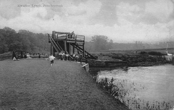

Heartland Posted October 31, 2023 Report Posted October 31, 2023 This c1900 post card shows a lock on the River Nene, near Peterborough, the wooden structure around the guillotine gate may be part of the construction process- any thoughts?
magpie patrick Posted October 31, 2023 Report Posted October 31, 2023 That's only the second picture I've seen of a Nene lock pre modernisation Bradshaw 1918 lists two locks at Alwalton - Alwalton lock and Alwalton Staunch, which is described as a navigation weir but was almost certainly a single guillotine gate. Somewhere (but I'm not sure where - it's in a book I bought cheaply because it was flood damaged) I have a picture of a "proper" lock on the river Nene pre-modernisation, it didn't have guillotines. As modernisation was after 1900 (1930?) I wouldn't expect Nene locks before then to have guillotines, although it's possible some did I guess. I think the picture might be Alwalton Staunch, pictures of other fenland staunches show rather elaborate structures around them.
ditchcrawler Posted October 31, 2023 Report Posted October 31, 2023 4 hours ago, Heartland said: This c1900 post card shows a lock on the River Nene, near Peterborough, the wooden structure around the guillotine gate may be part of the construction process- any thoughts? Alwalton Lynch c.1904 - PETERBOROUGH IMAGES ARCHIVE also has an up to date photo 3 minutes ago, ditchcrawler said: Alwalton Lynch c.1904 - PETERBOROUGH IMAGES ARCHIVE also has an up to date photo This may also be of interest Orton Staunch on the River Nene - PETERBOROUGH IMAGES ARCHIVE
Scholar Gypsy Posted November 7, 2023 Report Posted November 7, 2023 I think that's a flash lock, ie just one guillotine gate. When a boat wants to transit it is lifted and the boat either zooms downstream or is winched upstream as the levels equalise. I have seen photos of a very similar structure on the Brandon Ouse, near Hockwold. The remains of that are just about visible. I think one can also see the old lock structure downstream of Awalton, though I may be imagining that. One certainly can just below Lower Wellingborough lock (which looks like a 1970 structure rather than a 1930s one).

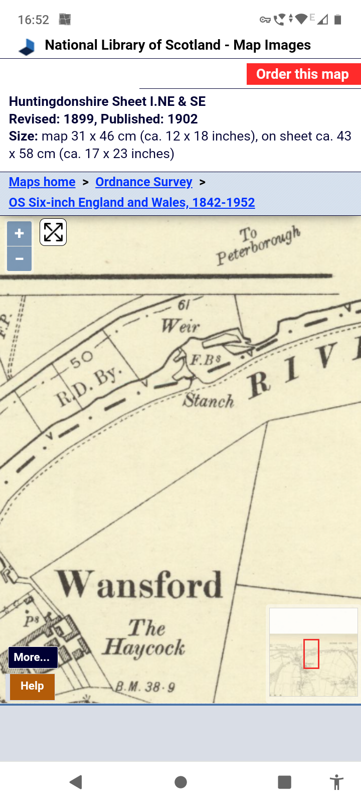

pearley Posted November 7, 2023 Report Posted November 7, 2023 The remains of this one are also visible
Scholar Gypsy Posted November 7, 2023 Report Posted November 7, 2023 This is the one I had in mind at Alwalton - a new stretch of river was built to take out the kink! https://maps.nls.uk/geo/explore/side-by-side-old/#zoom=15.8&lat=52.55889&lon=-0.32293&layers=168&right=193
