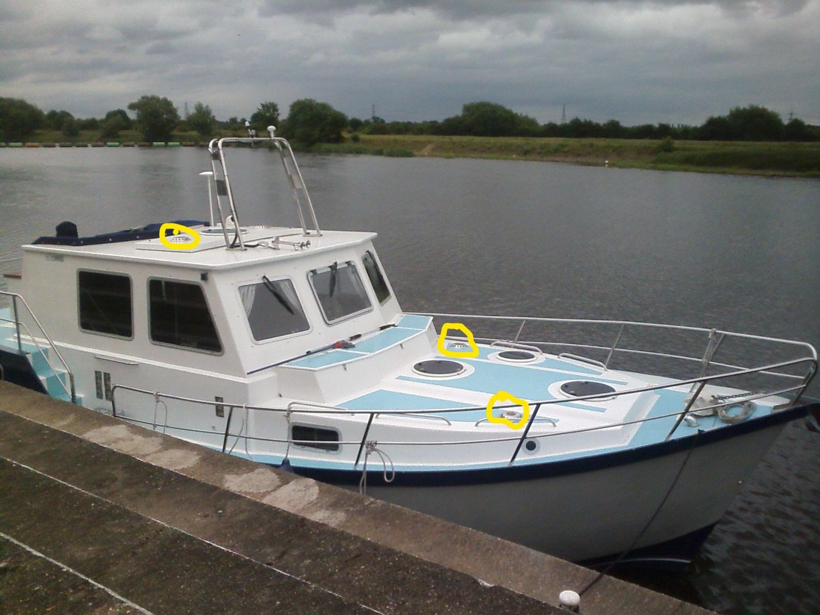

Alan de Enfield Posted September 28, 2021 Report Posted September 28, 2021 21 minutes ago, Rick Savery said: No point just changing one problem for another. But they were only a problem because they were incorrectly installed (pop riveted instead of screwed down) We have never had any mould problems, and even when waves have broken over the boat they have not leaked. Simply remove screws and it justs lifts apart, you can clean or replace parts as necessary. They even have a sliding collar (inside the boat) so that if you don't want a draught you simply push it up and it blocks off the air flow. Our Sea going cruiser with 'flying saucer' vents (piture on River Trent)

RickS Posted September 28, 2021 Author Report Posted September 28, 2021 19 minutes ago, Alan de Enfield said: But they were only a problem because they were incorrectly installed (pop riveted instead of screwed down) We have never had any mould problems, and even when waves have broken over the boat they have not leaked. Simply remove screws and it justs lifts apart, you can clean or replace parts as necessary. They even have a sliding collar (inside the boat) so that if you don't want a draught you simply push it up and it blocks off the air flow. Our Sea going cruiser with 'flying saucer' vents (piture on River Trent) Thanks Alan, I misunderstood David's post. I thought he was indicating that that was the problem with UFO vents rather than the method of isntallation. That is lot more encouraging and worth looking into more. Now I need to find one that requires the same size hole through the roof as the mushroom vent. i read earlier, I think, that they are the same, although was told by someone else that the UFO vents used a smaller diameter hole - I suppose it depends on whether my mushroom vents are 'standard' or not 5 hours ago, Yellowback said: Remove from where it is, and replace somewhere more convenient ? I have about 8 mushroom vents on my 66 foot boat, and not all on the centre line, a couple off to the side, so I think losing one should still be OK - but I will double check before any removal
Alan de Enfield Posted September 28, 2021 Report Posted September 28, 2021 (edited) 8 minutes ago, Rick Savery said: Thanks Alan, I misunderstood David's post. I thought he was indicating that that was the problem with UFO vents rather than the method of isntallation. That is lot more encouraging and worth looking into more. Now I need to find one that requires the same size hole through the roof as the mushroom vent. i read earlier, I think, that they are the same, although was told by someone else that the UFO vents used a smaller diameter hole - I suppose it depends on whether my mushroom vents are 'standard' or not I have about 8 mushroom vents on my 66 foot boat, and not all on the centre line, a couple off to the side, so I think losing one should still be OK - but I will double check before any removal I'm sat under a 'flying saucer' as we type. The hole from the inside is 100mm diameter (4 inch in real money) Examples : 101mm here Stainless Steel Solar Deck Vent - 78-434-100 (marinestore.co.uk) 96mm here Force 4 Venticlear Stainless Steel Vent | Force 4 Chandlery 92mm here Force 4 Waterproof Ventilite Shut Off Vent 97mm here Stainless Steel Mushroom Deck Vent with Clear Centre (228mm OD) (asap-supplies.com) Chech the size of your mushroom hole Vetus Mushroom Vetus Mushroom Vent Portos 117mm (4.5). - portos1 (marinestore.co.uk) Edited September 28, 2021 by Alan de Enfield
