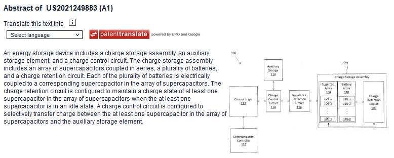

Rishworth_Bridge Posted September 7, 2021 Report Posted September 7, 2021 By volume As they have a 100% dod while Lead-acids are 50%-ish they are more or less equivalent, the problem being that there is no 'reserve' with the supercapacitor. If you want to know more try Googling "Sirius". This will bring up a US outfit called Kilowatt Labs which likes to claim that they developed them though I believe they were actually developed - and are still produced - in the UAE. I have a direct contact if anyone is interested.
IanD Posted September 7, 2021 Report Posted September 7, 2021 (edited) 2 hours ago, Rishworth_Bridge said: By volume As they have a 100% dod while Lead-acids are 50%-ish they are more or less equivalent, the problem being that there is no 'reserve' with the supercapacitor. If you want to know more try Googling "Sirius". This will bring up a US outfit called Kilowatt Labs which likes to claim that they developed them though I believe they were actually developed - and are still produced - in the UAE. I have a direct contact if anyone is interested. Supercapacitors are great for really high charge/discharge rate applications i.e. many times C rate. But for a given capacity their cost and energy density are terrible compared to batteries, that's physics for you. A million cycles would be useful if you intend to keep your boat for several thousand years... All boat applications are fractional-C where they're just not the right solution. Edited September 7, 2021 by IanD
IanD Posted September 7, 2021 Report Posted September 7, 2021 (edited) 4 hours ago, Rishworth_Bridge said: Some good points. I'm not going to get into detailed discussion of BUS requirements for Li batteries except to say that they seem to work perfectly well with their own BMS and some sort of black box to interface them to the charger. I did a calculation some time ago which suggested that rigid solar panels could produce power at about mains cost so were a very good option for static and minimal movement boats. However, I'm not happy with the safety (let alone aesthetic) aspects of rigids on cruising boats so we are currently without. I note that flexibles are currently being advertised as having aluminium backs "to dissipate the heat". To where when the roof itself is hot enough to fry an egg? The fuel consumptions quoted for the 7 kVA generator look rather high. We seem to use about 1.5 litres/hour for 5+ kVA. Doesn't fall much below 1 even with virtually no load so, rather than running the generator very inefficiently to float our batteries we try to arrange plug-ins every 7-10 days. Even with mooring charges this is reasonably economical if we let the batteries get a bit lower than usual first. While I understand the case for amortising the cost of a generator I'm not sure that it is valid as it is going to be there anyway, unlike solar panels. By all means include oil changes, etc, (which is in my 25 p/kWh estimate). If you are looking to improve overall efficiency without breaking the bank completely, look at supercapacitors. 40 years/1 million cycles, 100% dod and no charging losses at a cost that I believe to be between Lead-acid and Li batteries. The problem is that the energy density is only about half that of Lead-acids. Because they don't have charging losses a smaller 'battery bank and more frequent charging runs should suffice. Agreed about batteries -- LiFePO4 need to be the boss and in control of what happens to them, how this is done is an exercise for the designer... Also agree that rigid panels are a pain to mount, but they're still a better solution than flexibles -- about which there is much BS, as you point out. There's also misunderstanding by some boaters about "bifacial panels" claiming to offer higher efficiency -- which they do, but if you dig into the small print they have to be angled and spaced apart so the sunlight which misses the panels reflects off the surface underneath, which should be painted white or silver. Fine for a large-scale solar array with big gaps between the panels, completely irrelevant for boats where they have exactly the same yield as cheaper standard panels. As usual, the devil is in the details. Generator fuel consmption figure was for 7kW not 7kVA, because when charging batteries the inverter looks like a resistive load. -- Beta Marine BetaSet 10 : 2.7l/hr @ 8.5kVA / 0.8PF = 6.8kW -- Kohler 7EFKOZD : 2.6l/hr @ 7kW All the other generators I looked at are similar, they're all about 25% thermal efficiency at maximum load which agrees with the Victron generator tests -- diesel is 38.6MJ/l, 7kW is 25.2MJ/hr, so 25% efficiency is 2.6l/hr. If you think you can do much better than this then you should contact all the generator manufacturers, they'll probably beat a path to your door and pay you a fortune 😉 Edited September 7, 2021 by IanD
Rishworth_Bridge Posted September 8, 2021 Report Posted September 8, 2021 The Sirius supercapacitors I mentioned seem to be quite widely used for off-grid applications - virtually identical to the requirement for boats. I don't understand how they achieve the performance they do but there is a lot of electronics involved. I suspect that the voltage is boosted hugely on storage and vice versa. I have corresponded with a director of Infusion Energy, the company I believe to be the actual developer and manufacturer of them, and have been assured that they are compatible with standard inverter/chargers like our Quattro. (The advertising at the time suggested that they would need a lower charging voltage.) Indeed, there are pictures of them linked to Quattros on the Internet. Try https://www.getgreen.energy/product/sirius-super-capacitor-kilowatt-labs/. We have off-peak power at home and I am hoping to install a single unit to evaluate overnight charging and daytime use as a proxy for a boat system, though we will be away so much that it may have to wait another year.
IanD Posted September 8, 2021 Report Posted September 8, 2021 (edited) 43 minutes ago, Rishworth_Bridge said: The Sirius supercapacitors I mentioned seem to be quite widely used for off-grid applications - virtually identical to the requirement for boats. I don't understand how they achieve the performance they do but there is a lot of electronics involved. I suspect that the voltage is boosted hugely on storage and vice versa. I have corresponded with a director of Infusion Energy, the company I believe to be the actual developer and manufacturer of them, and have been assured that they are compatible with standard inverter/chargers like our Quattro. (The advertising at the time suggested that they would need a lower charging voltage.) Indeed, there are pictures of them linked to Quattros on the Internet. Try https://www.getgreen.energy/product/sirius-super-capacitor-kilowatt-labs/. We have off-peak power at home and I am hoping to install a single unit to evaluate overnight charging and daytime use as a proxy for a boat system, though we will be away so much that it may have to wait another year. The Sirius supercapacitors make sense at extremely high cycle counts, for example off-grid (daily use 365 days a year) over more than 10 years. Since I doubt that any non-commercial boat will ever even get close to the lifetime of LiFePO4 batteries before the boat (or the drive system) is scrapped, the only reason for using supercapacitors instead would be if they're smaller, cheaper or lighter -- and right now they're bigger, heavier and more expensive. If this changes in future (and no better battery technology for boats than LiFePO4 comes along) then they'll have a market. Edited September 8, 2021 by IanD
Rishworth_Bridge Posted September 8, 2021 Report Posted September 8, 2021 Depends how you use your boat. We probably spend about 200 days a year on ours so our batteries get through a lot of cycles, albeit only partial ones. And the batteries have now been installed for just shy of 7 years and used regularly for 6 1/2. We bought them in the expectation of getting 10 years so may need to be considering replacements within the next few years. As discussed earlier, the principal (only?) barrier to the widespread adoption of electric propulsion is cost, a barrier that Lithiums, whatever their technical benefits, make bigger. Despite claims of large price reductions, a functionally equivalent (smaller) bank of Lithiums costs about three times as much as one of Lead-acids. Given the control intricacies that you obviously understand and I don't, that makes them a poor choice in my book, except in one particular situation (below). I have to admit that I have come across conflicting price information for supercapacitors but believe that a 7 kwh unit will (maybe already does) cost about £1,500 in the UK. 6 or 7 of them will be needed to make an electric boat viable so that's £9-11K. If that's correct, that's about 50% more than Lead-acids but about half that of Lithiums. As to weight, they work out at about 1/5 that of Lead-acids which, ironically, adds to the cost as more ballast will be needed. Except where space is critical I see them as preferable to any type of battery - though watch out for Iron-air!
IanD Posted September 8, 2021 Report Posted September 8, 2021 (edited) 57 minutes ago, Rishworth_Bridge said: Depends how you use your boat. We probably spend about 200 days a year on ours so our batteries get through a lot of cycles, albeit only partial ones. And the batteries have now been installed for just shy of 7 years and used regularly for 6 1/2. We bought them in the expectation of getting 10 years so may need to be considering replacements within the next few years. As discussed earlier, the principal (only?) barrier to the widespread adoption of electric propulsion is cost, a barrier that Lithiums, whatever their technical benefits, make bigger. Despite claims of large price reductions, a functionally equivalent (smaller) bank of Lithiums costs about three times as much as one of Lead-acids. Given the control intricacies that you obviously understand and I don't, that makes them a poor choice in my book, except in one particular situation (below). I have to admit that I have come across conflicting price information for supercapacitors but believe that a 7 kwh unit will (maybe already does) cost about £1,500 in the UK. 6 or 7 of them will be needed to make an electric boat viable so that's £9-11K. If that's correct, that's about 50% more than Lead-acids but about half that of Lithiums. As to weight, they work out at about 1/5 that of Lead-acids which, ironically, adds to the cost as more ballast will be needed. Except where space is critical I see them as preferable to any type of battery - though watch out for Iron-air! If you're right about the UK price of the supercapacitors then they would be a good solution for narrowboats. However the KW Labs price in the UK is £3800 each for the 7.1kW unit, so 4 of these would be £15k, though prices outside the UK are much higher than this (almost double) -- it's also not clear if this includes VAT, if it doesn't the cost would be £18k. Your prices for lithiums look off though -- two BYD 15.4 48V batteries (600Ah, 31kWh usable) cost about £12k inc. VAT. From the quotes I got an 800Ah lead-acid traction bank (hybridmarine) was about £6k and a 1000Ah lead-carbon one (Waterworld) was about £9k, so for the same usable capacity lead-carbon are 1.5x the cost of traction batteries, lithium is 2x, and the supercapacitors might be 2.5x--3x. Lithium lifetime is becoming specified in MWh now, since so long as you stay within 10%-90% SoC the DoD*cycles is roughly constant. The BYDs are rated at 48MWh (and this is guaranteed since they're remotely logged), which is 3200cycles at 100% DoD, 6400 at 50% DoD and so on. If you use 50% DoD every day they'd last about 30 years, so the fact that supercapacitors might last you 1000 years isn't really much of an advantage... 😉 Edited September 8, 2021 by IanD
Rishworth_Bridge Posted September 8, 2021 Report Posted September 8, 2021 We can probably debate prices ad infinitum. The Sirius price I quoted was converted from dollars and came from a 'when available' UK list about 2 years ago. At that time, Infusion Energy (not KWL) were anticipating having stock in the UK by the end of the year (2019). Unfortunately, I have lost the link so can't check. You may well be right that it didn't include VAT and are certainly right that prices, particularly in Australia and NZ, are much higher. I got the impression that the relationship between Infusion and KWL might be a bit strained. KWL didn't reply to my enquiry and took 3 months to pass it to Infusion. I shall go back to my Infusion contact rather than KWL if/when I am ready to move.
IanD Posted September 8, 2021 Report Posted September 8, 2021 (edited) 28 minutes ago, Rishworth_Bridge said: We can probably debate prices ad infinitum. The Sirius price I quoted was converted from dollars and came from a 'when available' UK list about 2 years ago. At that time, Infusion Energy (not KWL) were anticipating having stock in the UK by the end of the year (2019). Unfortunately, I have lost the link so can't check. You may well be right that it didn't include VAT and are certainly right that prices, particularly in Australia and NZ, are much higher. I got the impression that the relationship between Infusion and KWL might be a bit strained. KWL didn't reply to my enquiry and took 3 months to pass it to Infusion. I shall go back to my Infusion contact rather than KWL if/when I am ready to move. Just be warned -- I also found articles/reviews on the web saying that these are not supercapacitors at all but just packaged LTO batteries, that the KW labs claims to use graphene are fraudulent, and that even graphene supercapacitors can't get anywhere near the energy densities they claim. LTO cells do have very long lifetime, also lower energy density and higher cost than LiFePO4, and the numbers KWL claim do stack up with what you'd expect if they were LTO cells. Whether you believe KWL or these claims is up to you, but I certainly can't find any reliable independent test/review/technical analysis of them anywhere... Their patent application also suggests it's an LTO battery pack, possibly with some series supercapacitors to provide extra peak current capability, see attached snapshot. Edited September 8, 2021 by IanD
Rishworth_Bridge Posted September 8, 2021 Report Posted September 8, 2021 Thanks Ian. Pause for thought.
IanD Posted September 8, 2021 Report Posted September 8, 2021 (edited) 28 minutes ago, Rishworth_Bridge said: Thanks Ian. Pause for thought. Have a read here. They're parallel LTO batteries, possibly with some series supercapacitors added. It's a scam... http://forums.aeva.asn.au/viewtopic.php?f=17&t=5486 Edited September 8, 2021 by IanD
