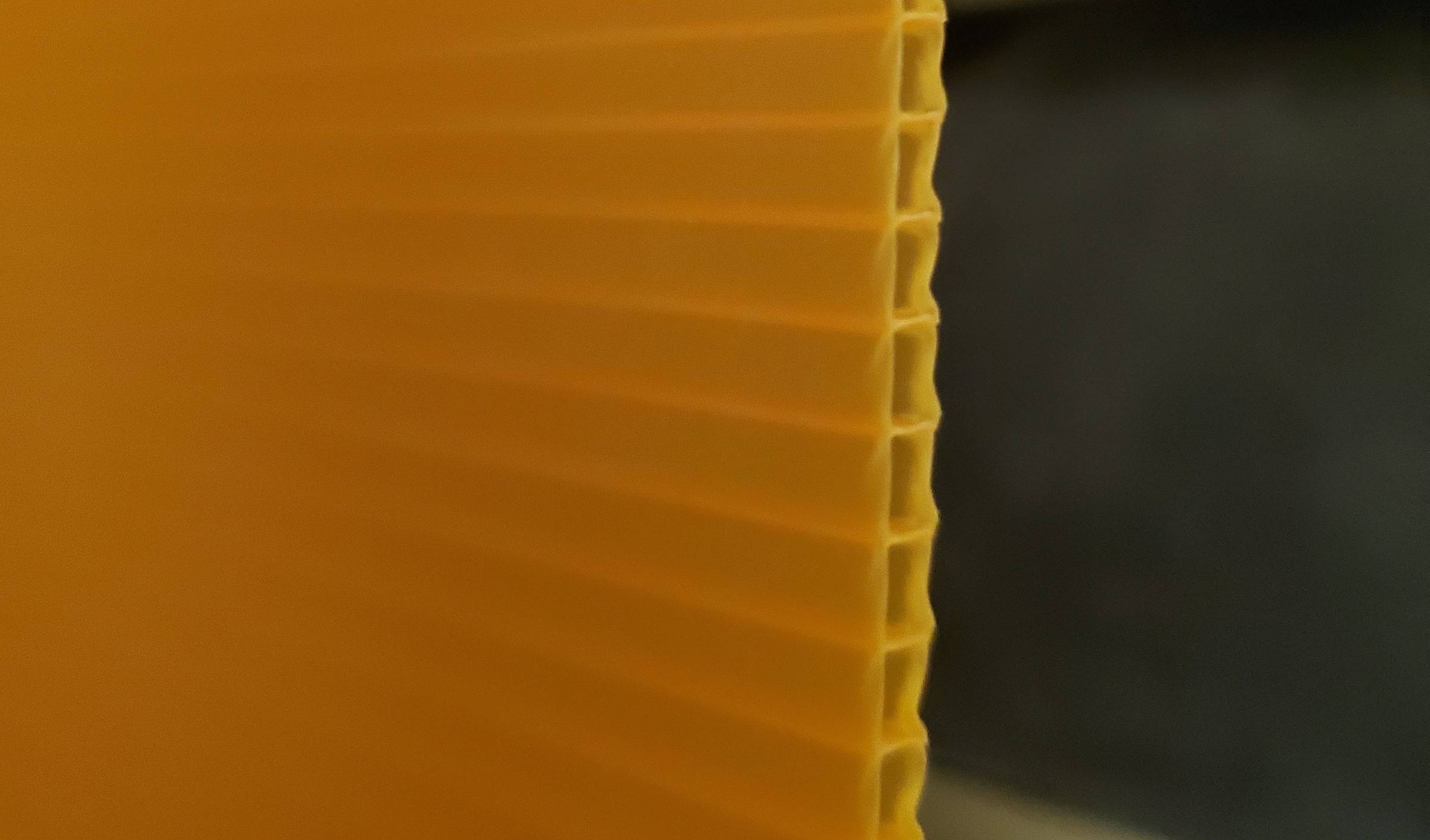

  7. A few more comments. Ampère's solar panels were bonded to the roof in accordance with the manufacturer's instructions and appeared to fail by delamination - white spots which grew to patches the size of postcards. I'm sure that panels will have improved since then but am pleased, if a little surprised, to learn that IanD has got a 10 year warranty. An Internet search about 12 months ago suggested that a life of 5 years was about average, the longest I found being 8. My understanding is that heat is the principal problem. Panels are mostly black so absorb heat easily and boat roofs (if there is any left that isn't under panels) also get hot so can't dissipate much heat. What appears to be needed is a method of positive cooling. The obvious one would be a double-skinned roof through which cold water could be passed, though I hate to think what this might cost. Ortomarine are mounting panels on thin plastic sheets like that in the photo, something which will certainly allow some ventilation though I doubt that it will offer a complete solution. My current thoughts are to try passing cold water through capillary matting (as used in ceiling heating) attached to the underside of the roof. Anybody fancy trying it? As to use, since taking ownership of Ampère at Crick in May, 2015, we have done something over 5,500 miles and almost 4,000 locks and expect to do about another 100 miles and a similar number of locks before the end of the year. Although we are registered as continuous cruisers and spend more time aboard than at home, we aren't live-aboards, putting the boat into marinas or boat clubs or occasionally leaving it pinned to the bank if we need to be elsewhere. So far this year it has spent 12 weeks in marinas or boat clubs (with another 2 due to start tomorrow) and about 3 pinned to the bank. Doing relatively little cruising for the time spent onboard means that a disproportionate amount of our fuel goes on domestic use rather than propulsion, particularly when our oil stove is running during the winter.
