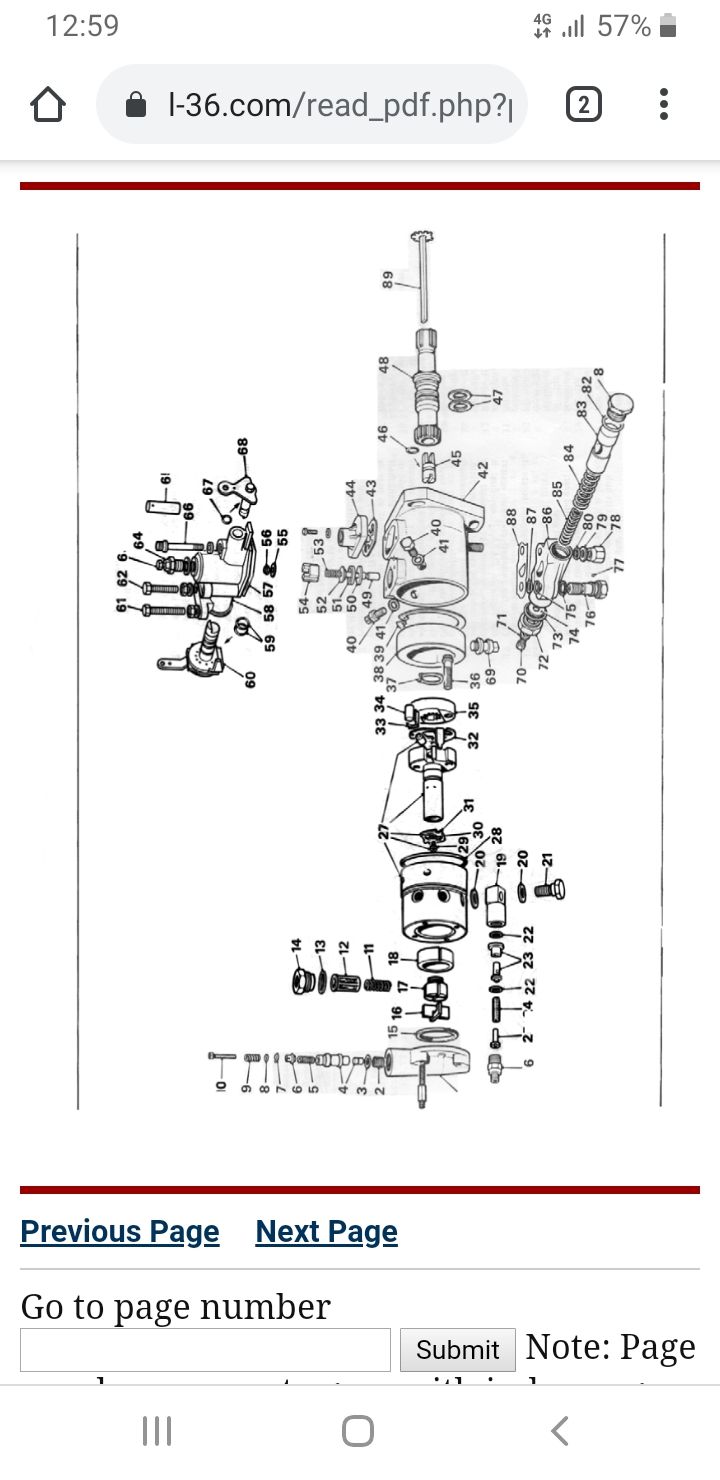

Tracy D'arth Posted July 5, 2021 Report Posted July 5, 2021 2 minutes ago, Scooter36 said: I have tried Culcutter boat, they don't have one, they told me it is not needed, but my mechanic said it does, they must be still being made CAV would have not made it so if it was not needed. It takes the backlash out of the pump drive so it is possible that it could run without but its not correct. Have you tried a Lucas CAV agent? If you want the best advice try asking R Wilkinson Diesel Service Ltd They are in Stockport, a long way from you but I have always found them to be reliable and helpful. 0161 476 4645
Tony Brooks Posted July 5, 2021 Report Posted July 5, 2021 (edited) 22 minutes ago, Scooter36 said: I have tried Culcutter boat, they don't have one, they told me it is not needed, but my mechanic said it does, they must be still being made I think something is coming back to me, and I think I agree with Calcutt. I seem to remember that some DPA drive splines look as if they have a thin section on the end that has been almost cut through, but the splines on it were slightly out of line with the main drive splines. When inserted into the female drive splines on the thin section was forced to turn a fraction and thereby loaded the torsion bar. This was an anti-drive chatter measure and nothing really to do with driving or timing the pump. I think you have another problem that your engineer has not considered/identified. Bet 1: lack of adequate bleeding. Bet 2: Lift pump fault (diaphragm or cap seal). Bet 3: seals in fuel filter incorrectly fitted. The rarer thing like fuel pick up pipe split or blocked etc. Edited July 5, 2021 by Tony Brooks

Tracy D'arth Posted July 5, 2021 Report Posted July 5, 2021 What happened to the original one? 4 minutes ago, Tony Brooks said: Is your mechanic really familiar with the BMC 1.5/1.8 engines? They are simple enough, but those more familiar with automotive/Japanese engines may not know the wrinkles. We might be able to give more help we knew what has been done to it and how the bleeding was carried out. 1.8 D was an automotive engine, Leyland LDV Sherpa van. They have this torsion bar in the end of the master splined drive for the injection pump. It loads the spline to avoid any backlash which would alter the injection timing point.

Slim Posted July 5, 2021 Report Posted July 5, 2021 Can't comment for whether it's needed or not but my manual shows one (item 89 as quoted earlier). I distinctly remember lining it up when re-installing the pump, a job I've done several times. There's a definite knack to it.
