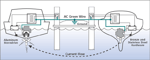

Why will I not get corrosion on my hull when using the generator?
You need a IT when connected to a shoreline because the earth is common between you and other boats which can set up an electric current and erode your metal parts.
You can set up a 'current flow' between (say) your bronze prop and the adjacent boats aluminium prop.
The generator is 'yours alone' (not thru a common earth) so you do not get the problem.
The generator is 'yours alone' so you do not get the problem.
Not unless you stick an earth spike for the generator into the soil or water. Any main power source properly installed ON THE BOAT will be earthed to the hull so there is no path through the water. The mains or a generator earthed to the bank has  an earth connection in the bank or fairly close by. The mains may have several such earth points. The mains wiring on the boat will be earthed to the hull so if there is any difference in electrical potential between the hull and bank will allow current to flow through the water and eat away at the hull. Faults on other boats nearby is likely to do the same - hence the need for an IT or GI.
