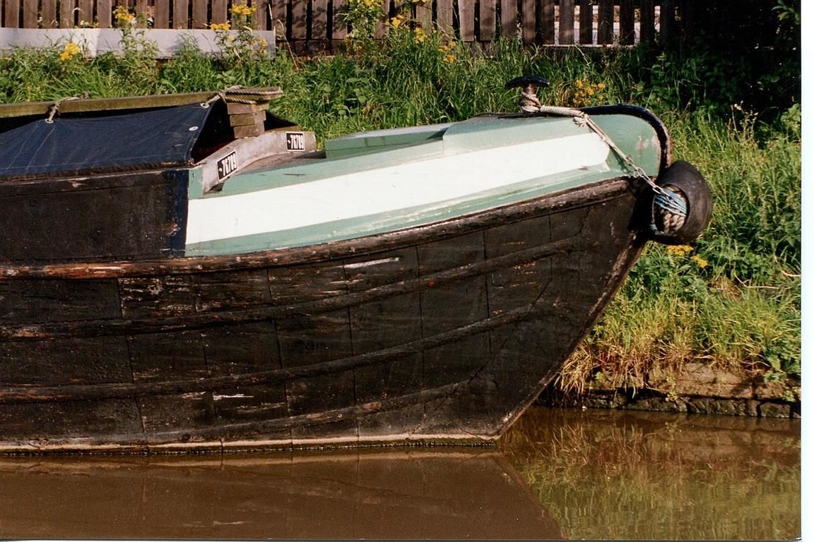

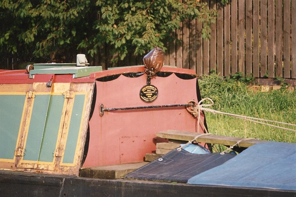

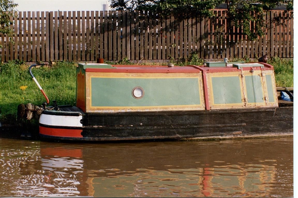

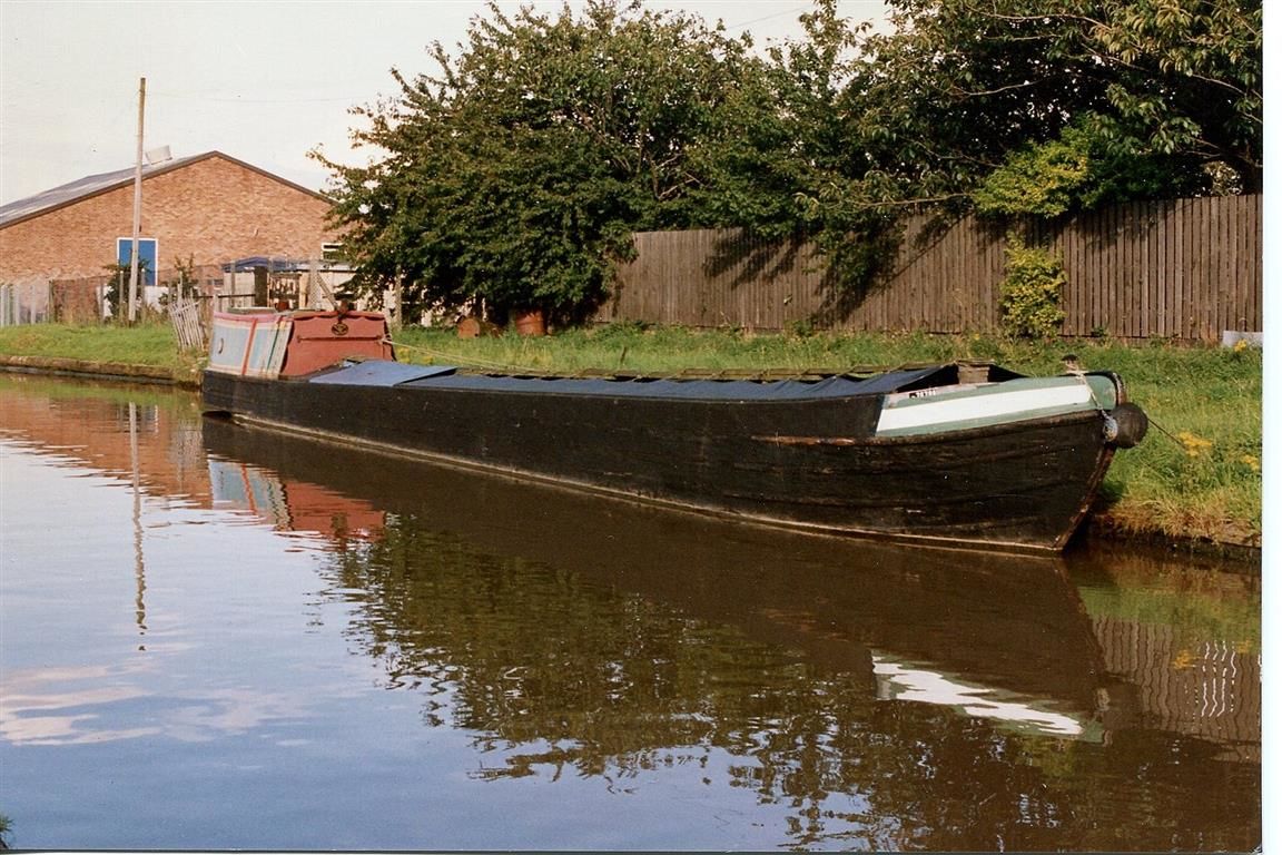

Nick, you can pass these on to your neighbour if you like. Taken at Middlewich in '83 or '88, I think maybe the former.
Wow! Its Venus! what incredible pictures I'll pass them on to Scott who owns her now he will be thrilled. Thank you so much.
