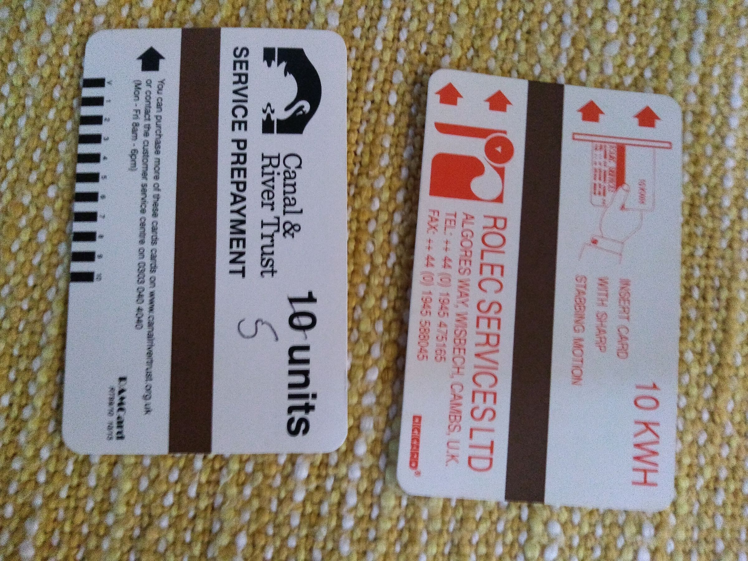

Left hand one is Digicard for use in the readers with eject button. You leave the card in all the time you are plugged in then eject it when leaving. It removes one unit as soon as inserted (standing charge?) then other units as you use the electric. On ejection it punches a tiny mark by the relevant stripe on the card. These pillars usually have a lockable cover (CRT key) over the reader. This is same card as pumpout but with less units on it. I would imagine pumpout card would work but have never tried it as we use cassette!
The right hand is Rolec and removes the entire amount as soon as inserted in the reader. Any unused electric is shown on the display and is available for the next user FOC. These pillars usually have a clear plastic cover over the reader.

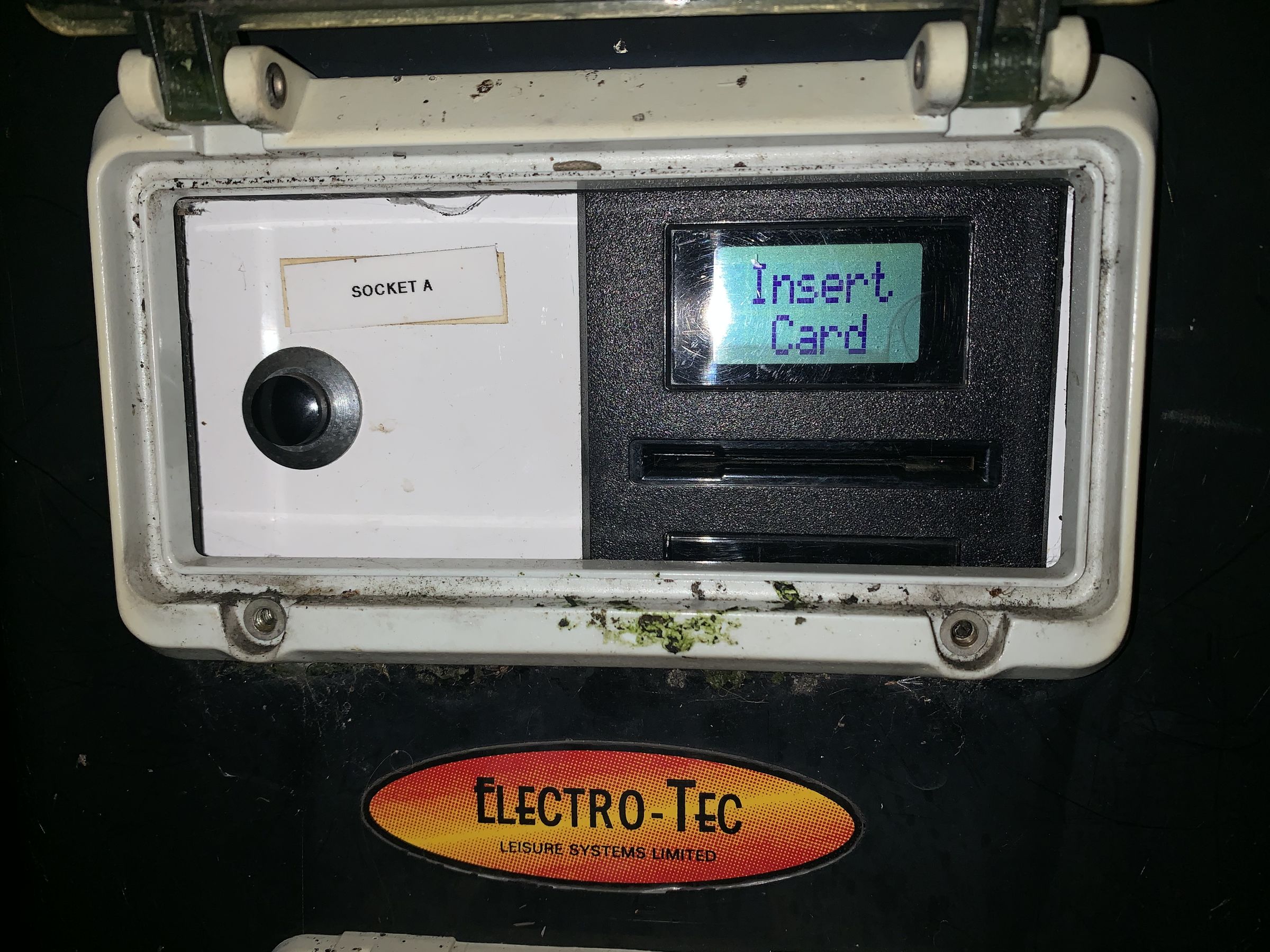

What does it say on the display on the reader?
That card on the left looks just how I remember the Stourport cards looking. But the shop here insists the pump out cards they sell are different.
This is is the reader/card slot.
This is a card I have that I tried earlier. The reader just spat it back out without me needing to press a button.

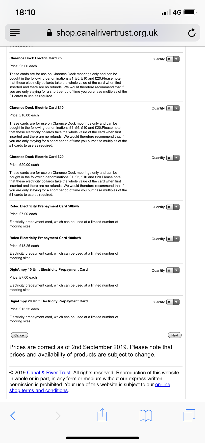

Just seen this online. I’m now convinced the card on the left of your pic is the one I need. They sell them in the little shop in Diglis?
I would say the one on the left too. The display says Insert Card, the Rolec one would say how much electric was remaining, even if it was £0.00.

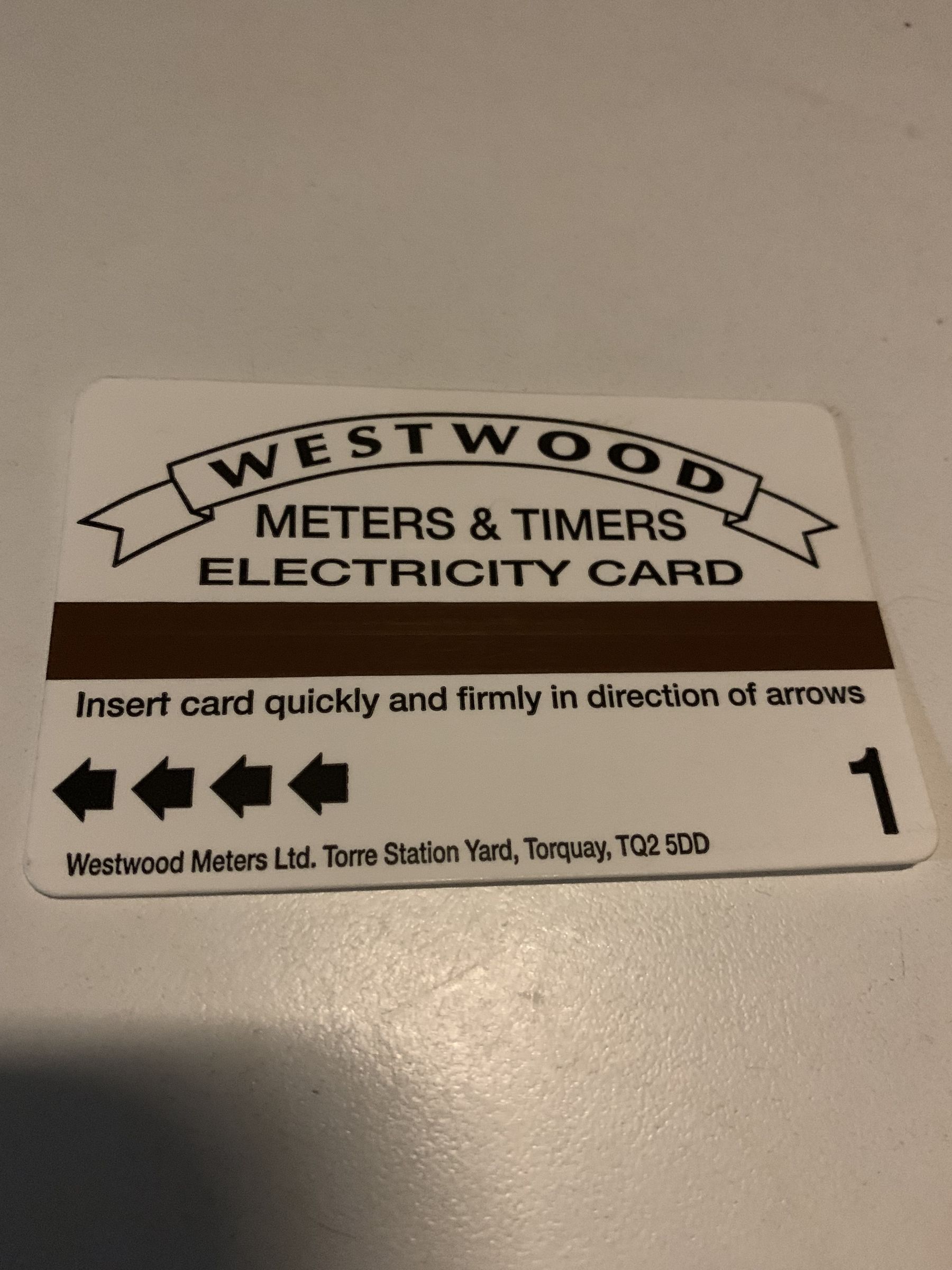

The Westwood one looks like a Rolec but personalized.
So the one from Diglis should work.
