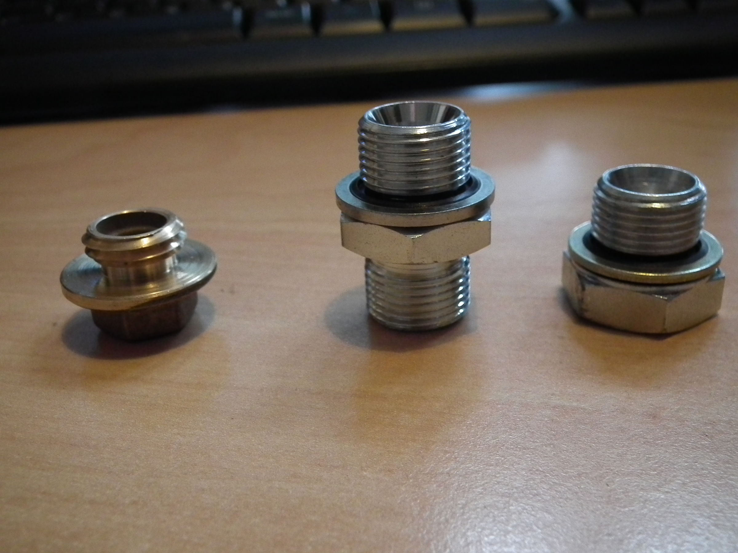

Depends upon the age of the box but there are two different types of sump plug.

May be completely wrong but are the drain plugs BSP threads? I think most have magnets in so you can clean off the swarf when you do an oil change.
Of the two plugs in the above photos neither had magnets.  They were purchased direct from the factory in Coventry. The gold coloured one looks like phosphor bronze.
I bought both as I was unable to ascertain which I had until the gear box taken out for an overhaul.
Had no problem with the drain plug once I got a fixed spanner. The user guide says 15mm A/F (across flats) which meant that a 15mm spanner was a tad too tight to get it on and a 16mm a tad too loose - but did the job.
