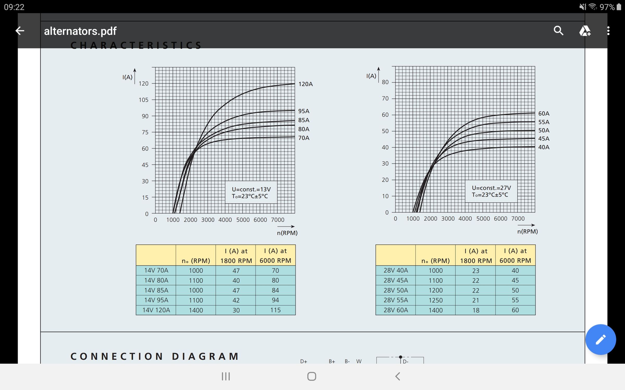

Found the power curve chart for my alternator.
Need to do a few tests to see if this is what happens in real life.  I have bonded both my 95a alternator and 45a alternator to charge my battery bank and am getting 40amp from both at 1000rpm which confused me as I expected more from the 95a alternator. However this power chart seems to match this. I'll try increasing the rpm next and see if I can get more out of the 95a alternator.

Basically - unless you 'thrash' your alternator at 6000 rpm you get a fraction of the rated output.
With the 'normal' 3:1 pulley ratios it shows that you need to run your engine at 2000 rpm to get somewhere near the rated output.
These are 'actuals' on my two engines / alternators. Both alternators are 70 amp.
Port Engine / Alternator
1000 RPM = 28 Amps
800 RPM = 21 Amps
14.2 volts at Alternator
Starboard Engine / Alternator
1000 RPM = 30 Amps
800 RPM = 22.5 Amps
14.0 volts at Alternator
The output will also obviously depend on the state of charge of the batteries - it is them that control the charging current - NOT - the alternator.
My alternators have a cut-in speed of 1200rpm and a max speed of 15,000 rpm.

This is really helpful  my battery bank is lithium, so it will pull everything it can get from the alternators.
Just tested it at 2000rpm and getting 100amp total from both alternators which is what I was originally expecting.
