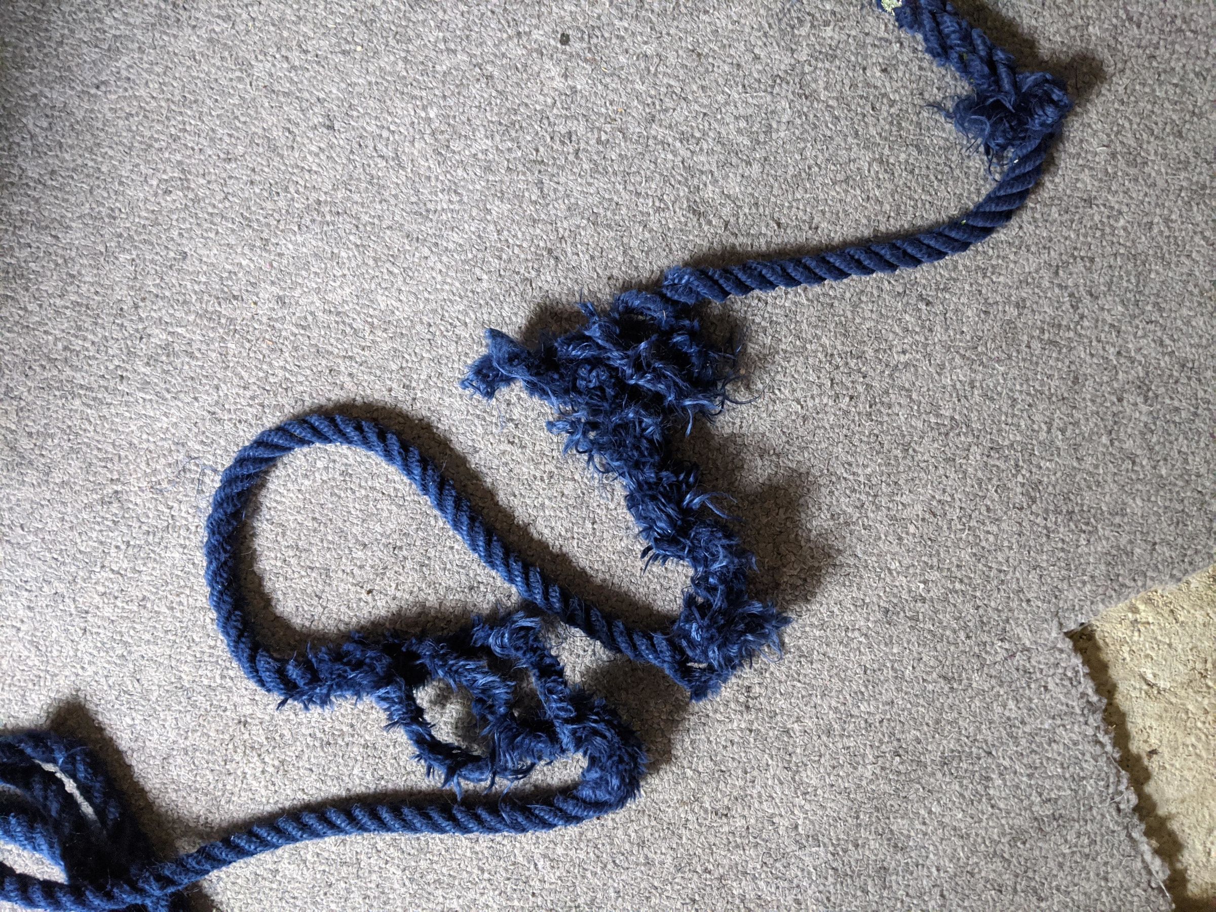

What have you fettled for the boat today?
Onewheeler replied to Captain Fizz's topic in Boat Building & Maintenance
Not fettled, but it begins with "f". I let the missus give the new-ish but dirty centre line a gentle wash. -
