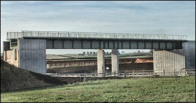

  12. You can try the Lichfield and Hatherton canal trust, see http://www.lhcrt.org.uk/aqueduct.htm and you can view one of the 7 wonders of the M6 toll road... I wonder what that empty steel aqueduct is doing with no embankment crossing the M6 Toll near Brownhills lol?

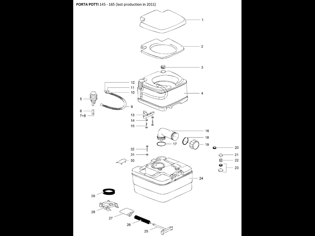

  18. I replaced the lip seal and the vent seal, easy to get to, the internal bellows is deep inside the base over the sliding rod of the handle. Richard Edit... just added a picture, I hope, see item 26
  20. Thanks for the post, but it's not the pump bellows on the top, but the bellows in the base that seal the pull handle from the contents. The bellows must have split, and allow fluid to pass the handle when you tilt the base. According to various websites, caravan dealers, Thetford etc, they don't list the part number now, let alone how to fit it lol I found some similar bellows that are used for brake cables, but could not confirm dimensions or how to replace it. So this base has become the stand by, as the other is fine after the new seals. Thanks for the suggestion though. Richard
  21. Thetford Porta Potti with a second base, never a sanitary station when you need one lol. Just fitted new seals to one base, but spare base the bellows leak, and can't be replaced, but keep it horizontal, and you don't get your own back. lol. but it is only for emergencies.
