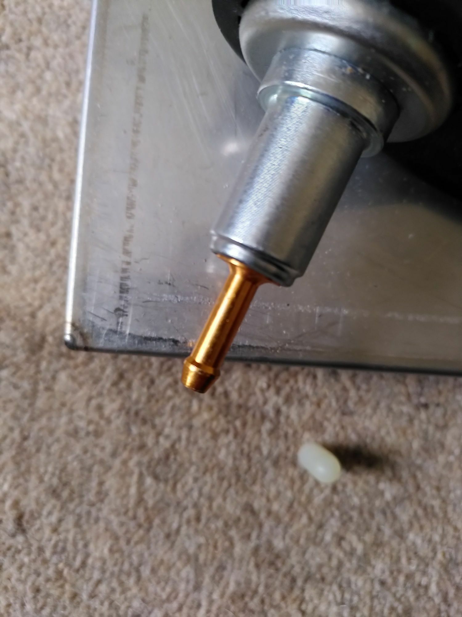

Thanks for all that. Sorry that I haven't been back before this. Life got very busy! I am installling a replacement for my old Mikuni MX40. Space is tight and for that reason I have decided on the new MX50. Years and years ago (in 2006) I sent the old MX40 down to Eastliegh, where Mikuni live in the UK, and they returned it with a little disposable paper filter in a plastic housing with rubber tube connections and little jubilee clips. Will that sort of arrangement still be OK? Will it pass the BSS? I have the new boiler at home with me. IN the image of the inlet pipe you can see that the tube has been shaped to take an olive which, I suppose will fit over the widest bit and then compress down to mae the seal. It seems odd that it should have been shaped like this. Having measured it really carefully I find that the greatest diameter is 6.00mm but the OD of the rest of the tube is 5.10mm. At the moment I can tell you the exact diameter of the pipe from the tank. Thanks in advance. Nick
I need to fit a filter in line. The pipe OD measures 5.30mm with my vernier gauge. Will 1/4" compression fittings work? If not what will? TIA Nick

It's not working at the moment so I have unshipped it, taken it home and am investigating. I think that it's the flame sensor plus some stiffness of the air blower from lack of use over a lengthy period. I can't buy any more gaskets. Mikuni have stopped making spares and MV Heating in Eastliegh have none left. Not necessarily a problem I can create my own from some 2mm gasket paper. I got this news from the nice man at MV Heating who told me that the replacement for the MX40 is an MV MX50 which they will mount on the same plate that the MX40 was mounted on if I send it off to them, cost £595 + VAT plus carriage. Question: is the MV MX50 a good buy? My inclination is to have a go with the old one and see if I can get it going for a few more years (months? weeks? not at all?) Opinions/advice will be gratefully read. N
