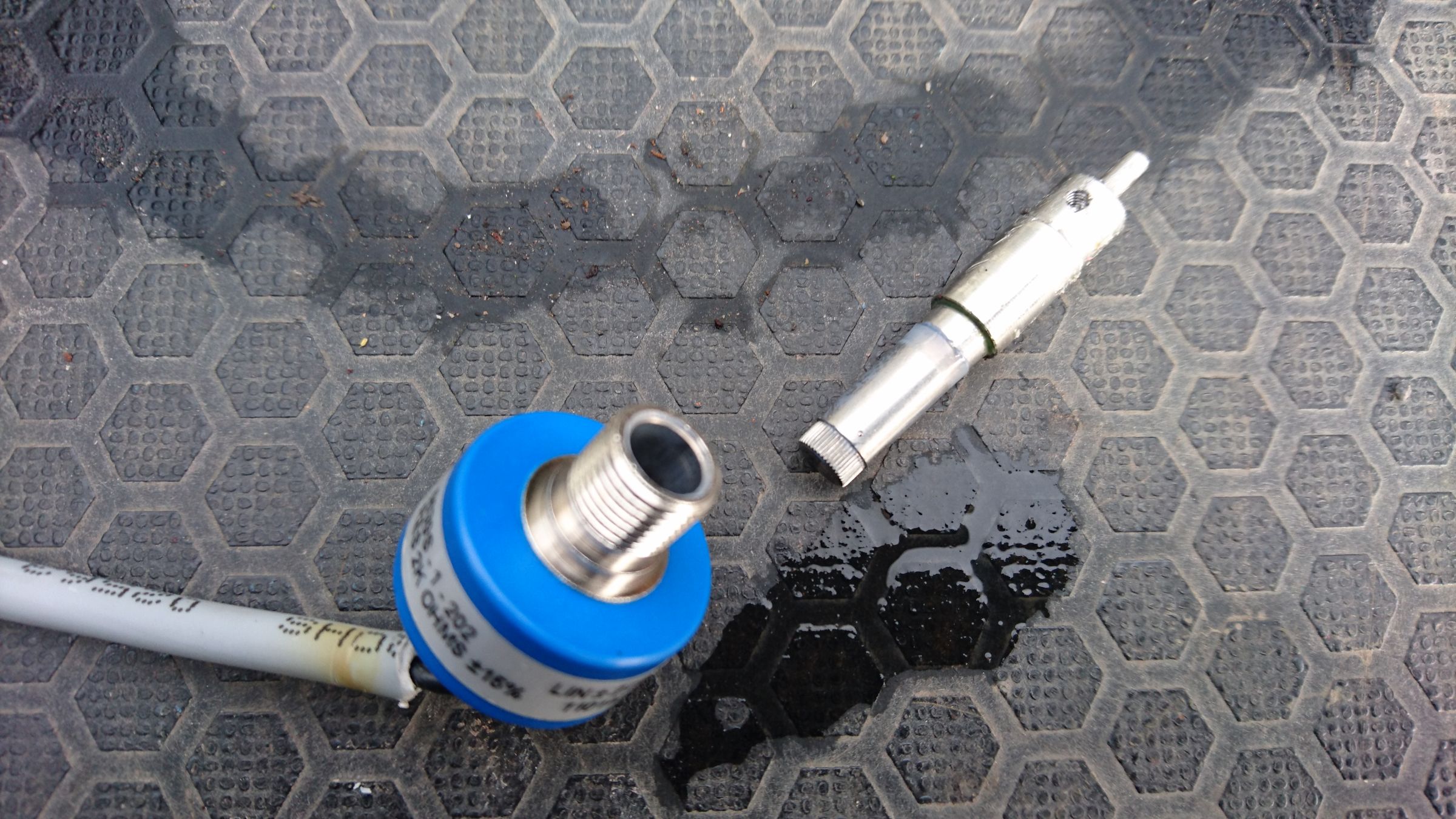

Back to the original topic for a moment, I thought someone (?) might be interested to know my progress. I disassembled the potentiometer housing and took the coat hanger bit off so that I could fully withdraw the pot from the housing. I pulled out the long, custom spindle of the pot as it was just turning around and around (of course normal pots stop at kind of 11pm and 1am). Tried pushing the spline end into the pot, but whatever I do it just goes round and round - so it occurred to me it might be meant to be like that, in which case of course the rotational orientation that the pot is fitted when tightened up (there is the usual retaining nut) would be quite critical. I also metered it out and it does go from zero up just past 2k (Its a 2k pot). Now my job is twice as hard because even if I put the pot back as it originally was, there is no guarantee that the moving bit inside is in any particular orientation. Of course, I can set the spline with the coat hanger fully in the up position, and fiddle with the pot until it reads zero ohms (shorting out wire sent gauge to full) but it would still take a great deal of care to get right. Aside from all that, the readings were a bit touch and go and I wonder if the spline sits into the pot well enough. Maybe the original fault being that it was just turning on its own and not moving anything in the pot itself. Anyone any experience of this type of pot? -
