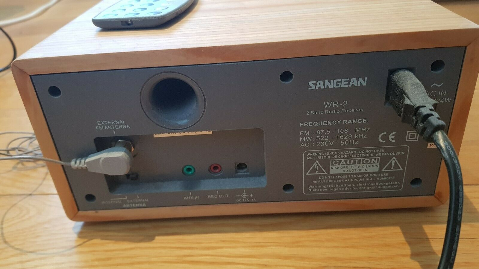

  23. Thanks I have thought about a car radio but then I have to fit speakers etc. Also found that DAB doesn't work so well on a boat. I searched ebay and found this one secondhand that has a 12v input for power and sockets for an external antenna so I will give it a try. Not a name I had come across before. em Description: Compact Tabletop AM / FM Radio with Wooden Enclosure that is Tuned and Ported for its 3-inch Front-Firing Speaker Acoustic Bass Compensation for a Richer Bass Response, Rotary Bass and Treble Controls, this system Delivers Warm Room-Filling Audio for its size 10 Memory Preset Stations (5 AM, 5 FM) Clock and Alarm with HWS (Humane Wake System) (wake by Radio or Buzzer), Adjustable Sleep and Snooze Function Large Easy to Read Backlit LCD Display with Dimmer Adjustment DC-Input, Aux-Input, REC-Out, Stereo Headphone Output, AM and FM External Antenna Connections Remote Control included Item is used but in excellent condition
  24. Does anyone know of a bedside clock/radio that works on 12v dc. I would like one that is am and fm and not DAB. All of the ones I can find use the 50Hz mains signal for timing the clock part and I don't want an inverter running all the time even if it did produce a accurate 50Hz?
