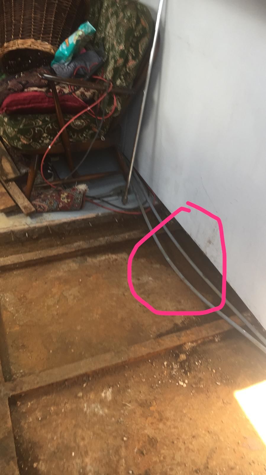

  5. I also have a cruiser stern but isn’t the bilge supposed to be dry as much as possible? On another note this is the state of the baseplate post grinding. How bad does this look to you guys? thanks

  8. The only leak I have been able to identify is from the metal piping leading to the immersion tank. I think this was the source of most of the puddles at the stern but I also think the dampness spread through the polystyrene so more areas were damp without there being water. It’s been drying out for a while and all the other areas are dry but this spot, which is on the opposite side to the immersion tank. I do think that my windows could be leaking though. The water does appear as if it’s coming up from the baseplate but again it’s sort of hard to tell because it so slow. Thanks for all your responses! I guess it’s hard to diagnose a problem from poor descriptions and blurry photos.

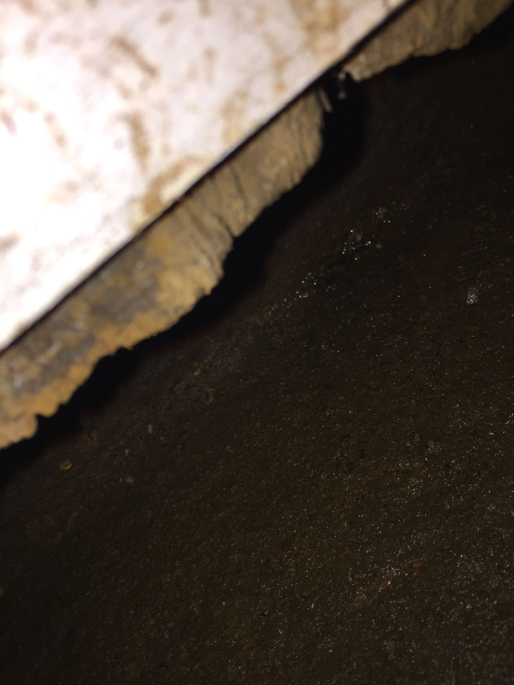

  9. I can’t see a hole but it is quite rusty. The photo is where the baseplate meets the cabin side. It’s sort of oozing water. There’s a nappy there currently to soak it up. I’m not sure what a scupper is, excuse my ignorance. There was some old ballast that was polystyrene with poured concrete on top. That’s been removed but the water seems to be coming from the seam.
  10. If you sponge it then remove the sponge water very slowly reappears. Everything has been scraped away from the hull so you just get damp metal

  12. Thanks for your replies. I’m interested in what the chance is that it could be canal water? The survey was ok and done last year. There were no parts tested below 4mm but I understand that they don’t test the entire hull. The internal rust is not terrible. I’d say a mm in most places and a 2-3 mm in a few spots. The water is coming in really slowly, as in over night it will dampen the surrounding area but there won’t be a puddle. Are there any other possible explanations? Thanks again
