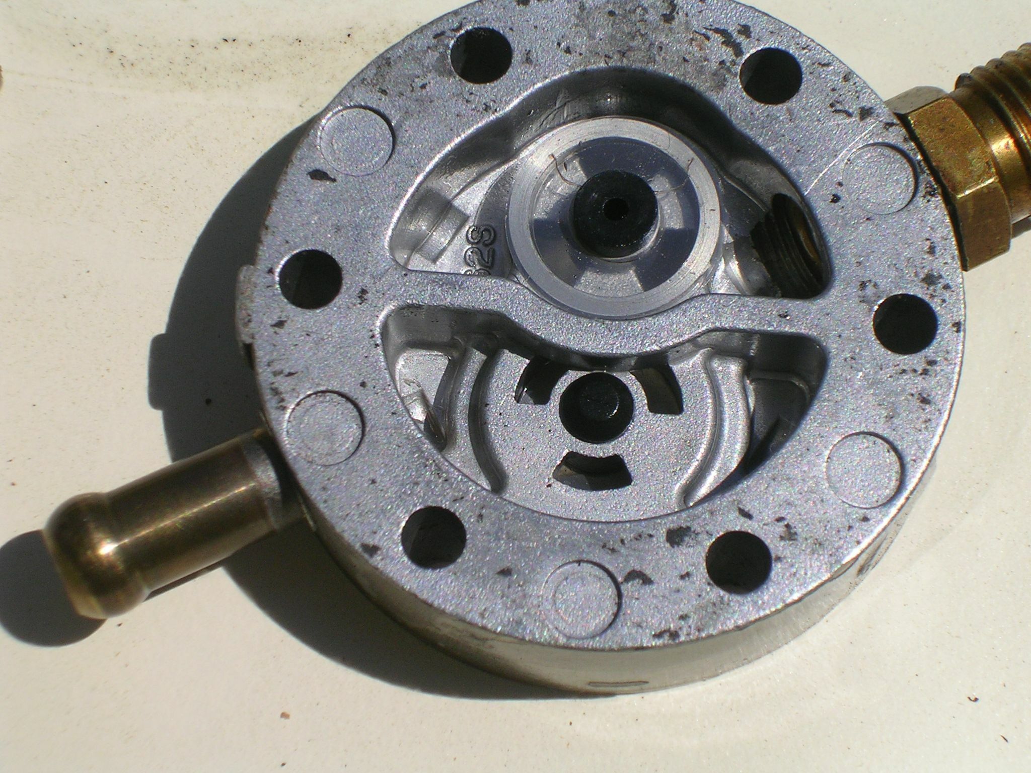

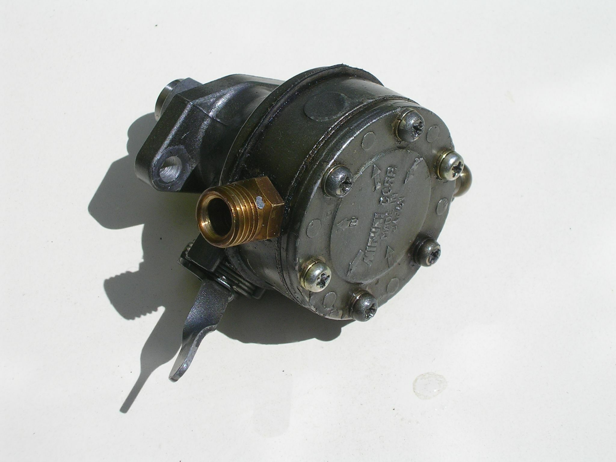

  12. Brucie bonus: piccies of the offending article from 2011 (how sad it that??) - checkout 10:00 o'clock and 02:00 o'clock round the black plug at the top of the second piccie:
  13. Long time ago when moving my new (to me) boat from broker to marina, I had similar. How does your fuel get from A to B? Eventual solution for me involved the fuel pump. When split, there is what I can only describe as a transparent 'plastic' diaphragm between the top and bottom halves. Fuel is pumped by flexing the semi-rigid diaphragm - fuel into bottom chamber, through non-return valve and out top. There was an almost invisible crack in the diaphragm. When fuel level in the tank was high, it was not a major problem but as the fuel level fell and the pump had to 'work', the pump could not develop enough 'suck'/'push'=fuel starvation. Luckily, RCR sent a proper engineer who wanted to understand the problem as well as just replacing the faulty pump. Barrus Shire.
