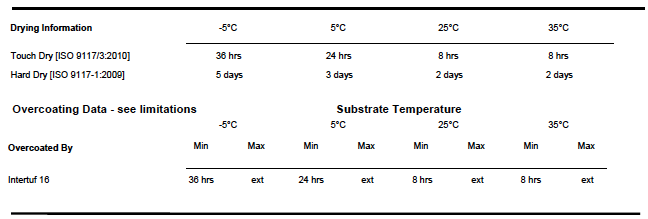

Surely if boatyards are doing poor work you can challenge them? The table below is for Intertuf 16 (other blacking products are available!) https://www.international-marine.com/product/intertuf-16 If you experience failed blacking, can the boatyard prove they followed the manufacturers instructions? If not, they should redo the work at their expense shouldn't they? What records do they keep? Did they record the temperature and humidity during the work? The equipment for this is cheap so there is no excuse for not doing it. -
