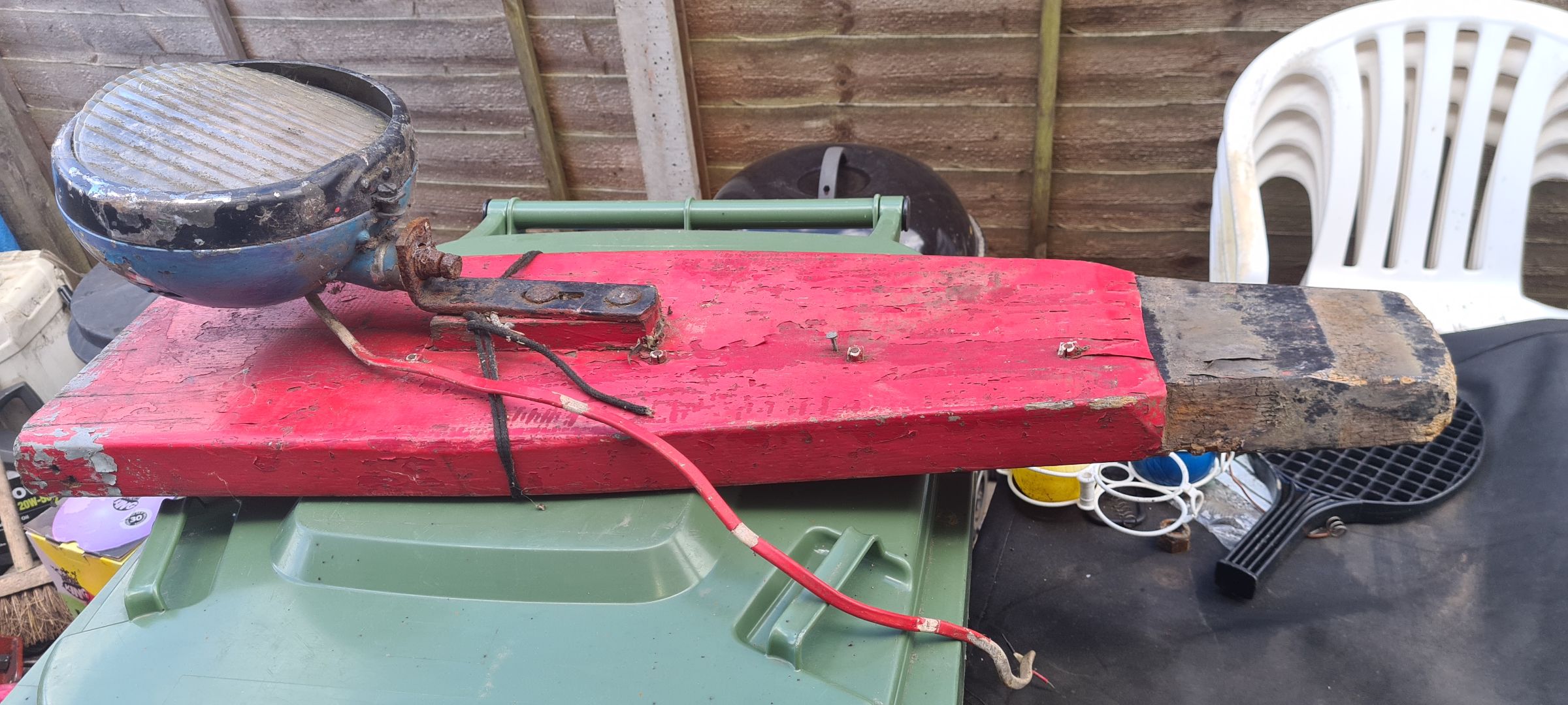

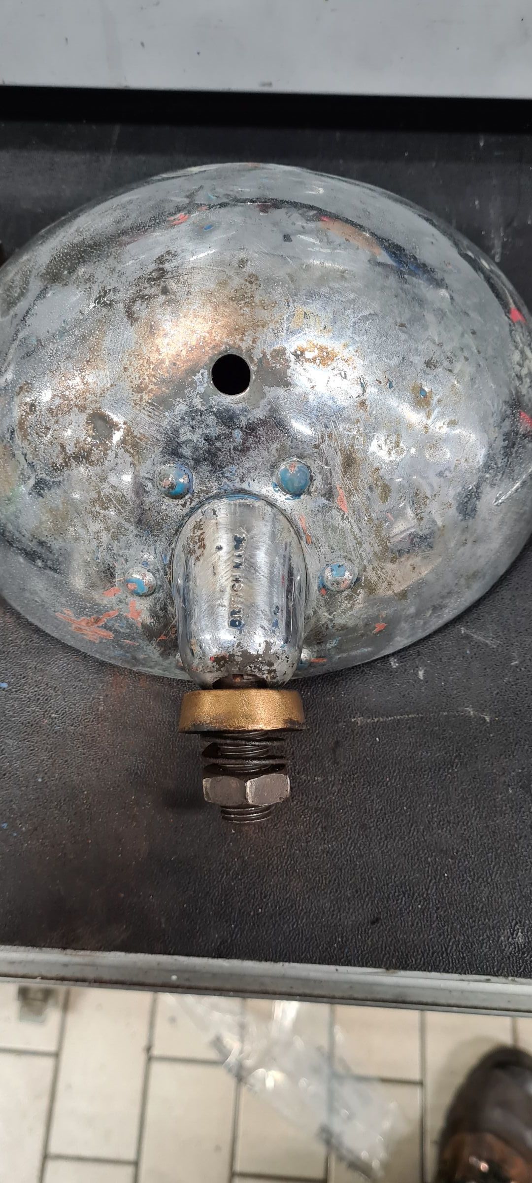

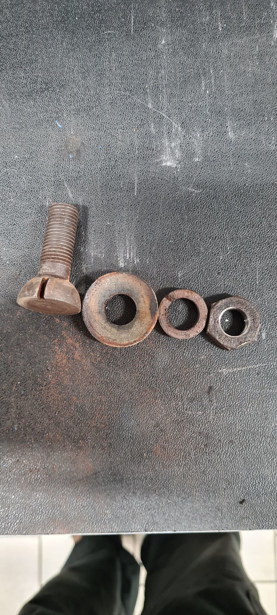

All paint removed reveals the old chrome and in odd places the black that was on before, the front ring is still black. Removed the old mount, cleaned the holder nut and bolts. Just got to paint and clean front ring, rewire the bulb holder and she's back to how it was in claytons.
Yep that's the ones, I've now stripped down the paint on umea and it was black before the blue, it's a novtek drive master, so more convinced than was that it's more than likely the one she used in claytons

I know it's an old post but how many owners did umea have when leaving claytons? Reason I ask is I have some of her parts, and believe them to be original or at least from claytons days rather than repaired / replaced parts. I'm currently in the process of restoration of her lamp. Reason for the above is I'm trying to work out if the lamp I have is her original, I've a few pics of it when on the boat for some reason umea seamed to be the only one that had her lamp on the engine room, I've seen a few pics of it in this place and by the looks it looks like its the same lamp, They seam to be quite rare pics of claytons with there lamps fitted, Anyone got any good pics of her lamp from when she worked? As above interested to know how many owners she has a I know she was converted very quickly after selling from claytons, anyone got any bow pics after she was first converted? Second pic is not mine hope its OK being used. You can just about make out the lines in the lamp glass and the back of the lamp has the right sort of shape to the one that I bought, it had been modded at some point with a modern lamp inside when I got it this has now been removed and a replacement reflector and bulb as originally fitted to the one I have. Given the type of lamp it is it dates from 1930-1940 as this is the time these style of lamps was produced
