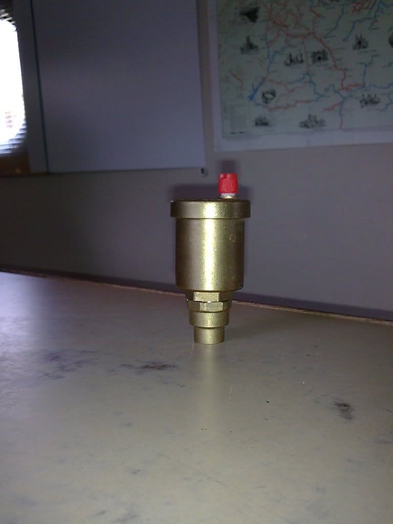

Sot on, though make sure header tank is vented and flow pipe slopes upwards to rads, maybe a valve on the return at the end to encourage flow through rads. Or your setup could still work if you vent header tank and highest point on flow, return top of last rad into top of header tank or an automatic air valve (AAV) will work fine, they are cheap, simple and will fit into top of furthest rad

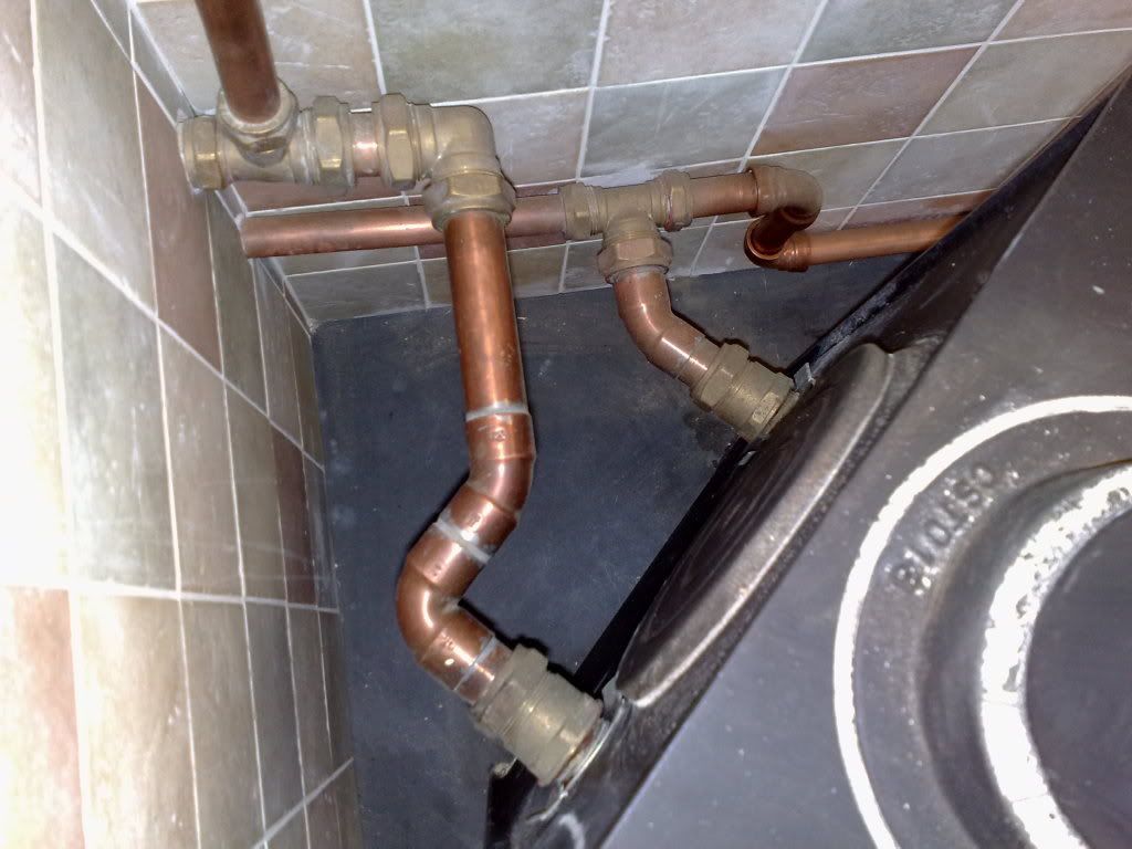

Pipe work behind stove

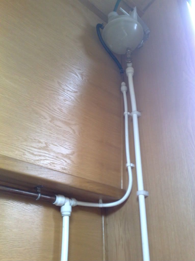

Transit expansion bottle coonection showing air bubble 'catch' pipe take off.

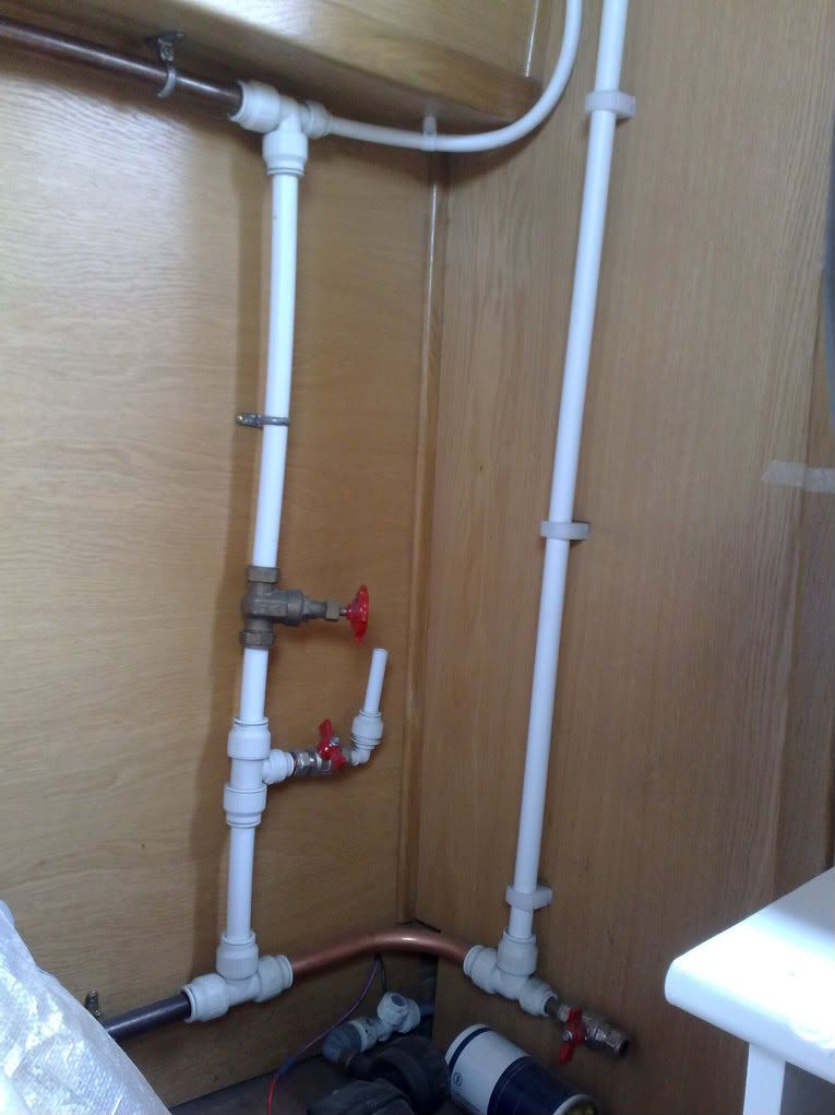

Return loop pipework (centre valve is shut of the previous rad loop so only the first rad flows)

Agreed the reservoir bottle would be better connected to the top right hand end of the higher rad to make it self bleeding, or maybe just fitting an auto air vent would be enough.
At least with the current arrangement the steam is contained and only the relatively cool reservoir water would be ejected.

Be careful with auto air vents. They were discussed here a while back and they only seemed to vent at around 8-10 bar which might be a bit much.
Edited by Smelly
or just tee into the riser to the expansion tank from the top rail.... If that section has a valve on it it can be used to prevent the hot water simply trying to rise into the expansion tank. edit... a valve between the riser and the top rail of course...
The AAVs I am referring to are the bottle type which just use a floating ball similar to a diving snorkel. They vent as soon as water level drops due to air trapped. Foolproof really.
Until it fails to reseal
