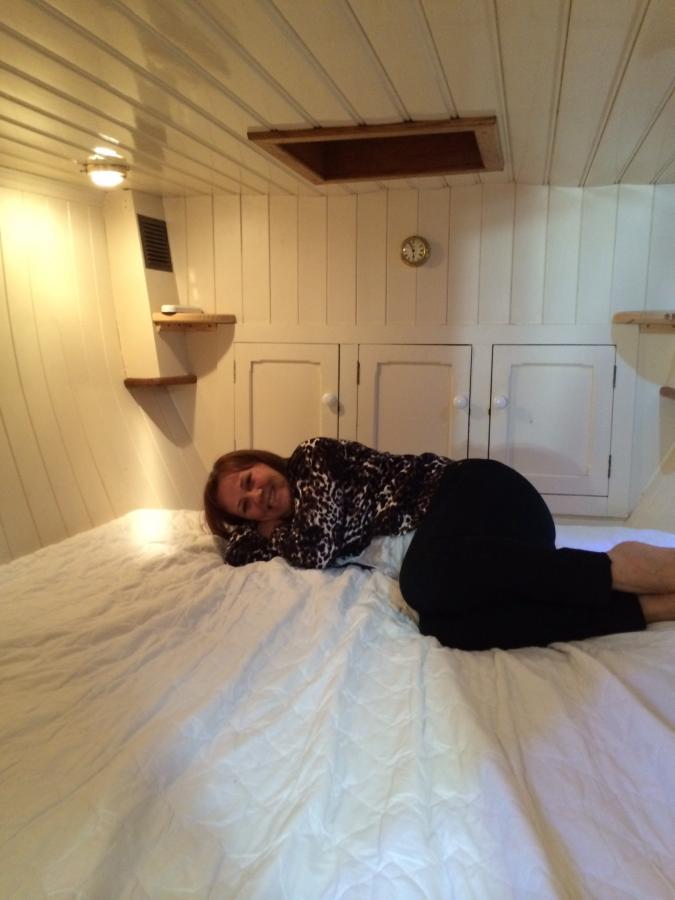

We have letterbox vents on the front bulkhead either side of the doors with channels leading down to grilles in the under deck bedroom 'ceiling' which seems to keep air circulating. Got some water inside a while back when snow built up over them on the deck and we also block the vents when tackling rough water. to stop waves splashing into them. There's also a finrad up at the head end which I suspect helps airflow as well as warmth.
