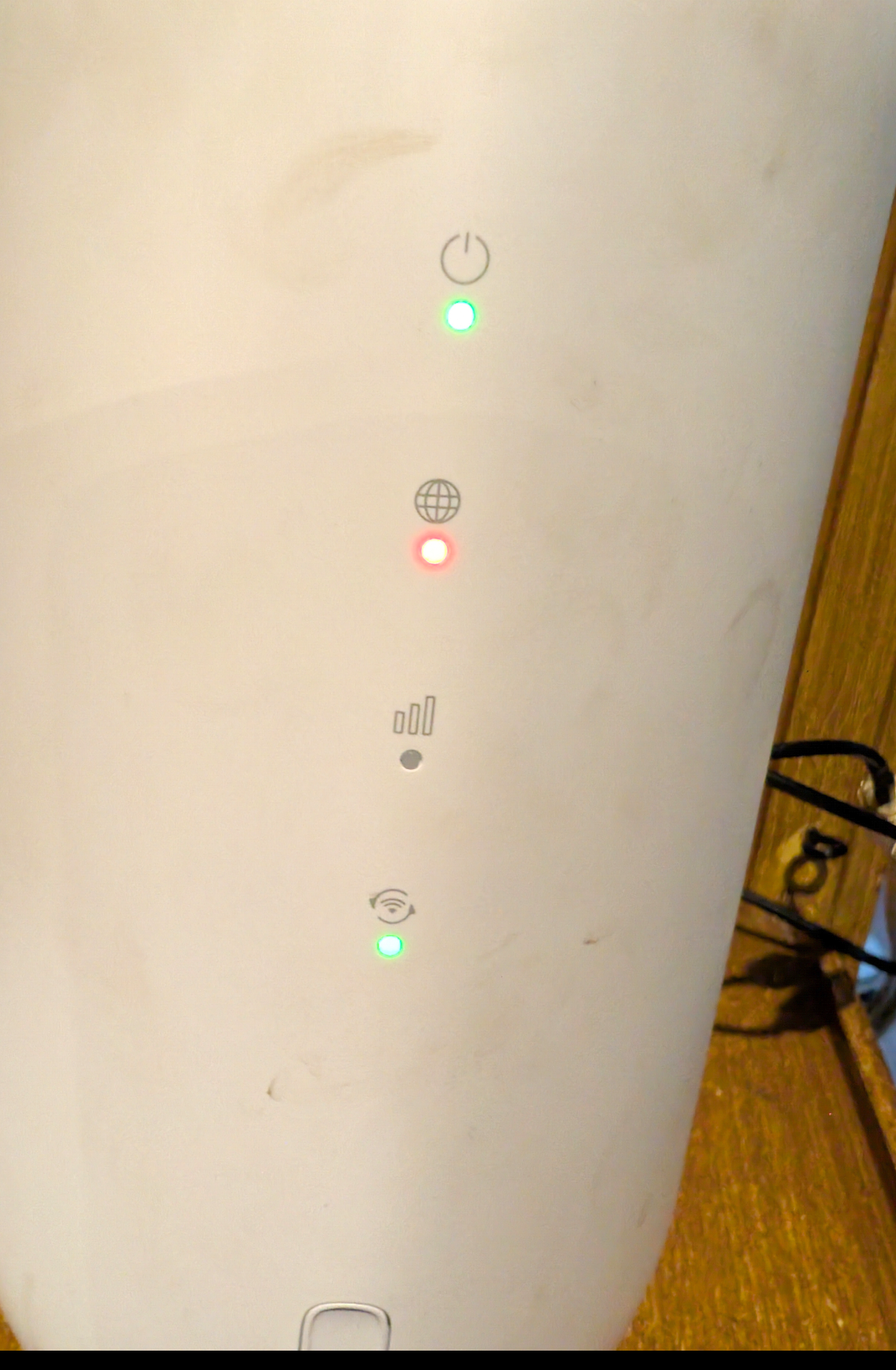

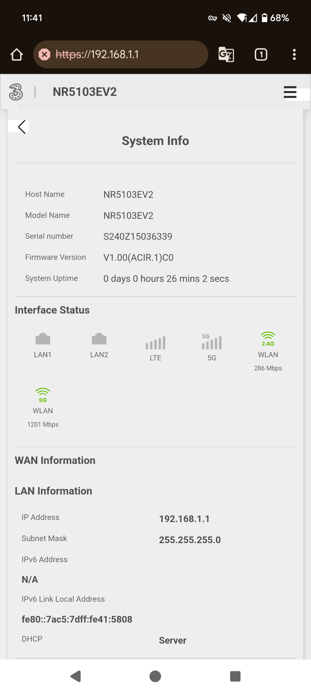

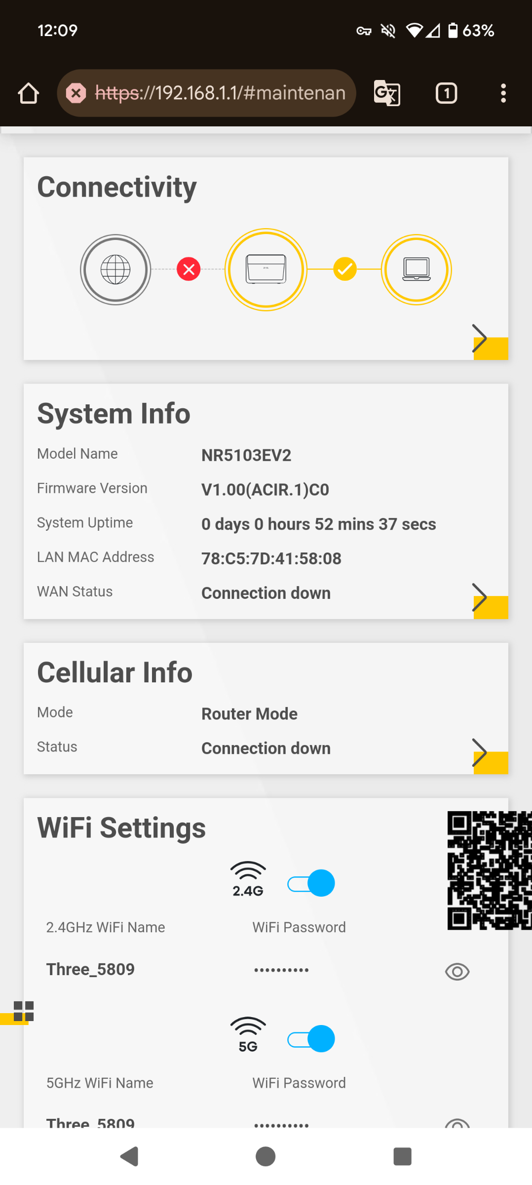

IanD Posted March 13 Report Posted March 13 (edited) 14 minutes ago, junior said: So basically I'm stumped then in a chicken/egg situation. The router doesn't have internet because the firmware is out of date, but it can only download the new firmware when connected to the internet? I'm not convinced that statement it true; it's possible but unlikely since exactly the same firmware worked until a couple of weeks ago, a SIM (or other router hardware) problem is much more likely. Unless it *did* a firmware update automatically and that's what broke it... 😞 14 minutes ago, alias said: I'm not familiar with the router, does it have a WAN port? If so (and you are close to home) you could take it indoors and connect it to your home router with an ethernet cable to give the internet connection to check for updates. It has two Ethernet ports, both are normally configured as LAN (Local Area Network) but one can be changed to WAN (Wide Are Network) in the app -- then this idea might work, plug it into home router via an Ethernet cable. But this assumes that the firmware check/update works via an Internet connection rather than requiring a cellular connection to the Three network, which might not be the case -- I have an NR5103E on EE and I can't update it over the EE network (which has internet access)... 10 minutes ago, Liam said: Can you download the firmware update file to.your computer using the house internet, and then connect your computer to the router to do a manual firmware update by uploading the file to it rather than downloading it? AFAIK the only way to do firmware updates is when you're on the Three network (see above), so no, there's no accessible file to download... 😞 Edited March 13 by IanD
junior Posted March 13 Author Report Posted March 13 21 minutes ago, alias said: I'm not familiar with the router, does it have a WAN port? If so (and you are close to home) you could take it indoors and connect it to your home router with an ethernet cable to give the internet connection to check for updates. So I've done this, but unfortunately it hasn't made any difference. The Three router (white one) still has no internet, even when connected by cable to my home Sky (black) router.
IanD Posted March 13 Report Posted March 13 2 minutes ago, junior said: So I've done this, but unfortunately it hasn't made any difference. The Three router (white one) still has no internet, even when connected by cable to my home Sky (black) router. You need to reconfigure that port from LAN to WAN in the app, as said above... 😉

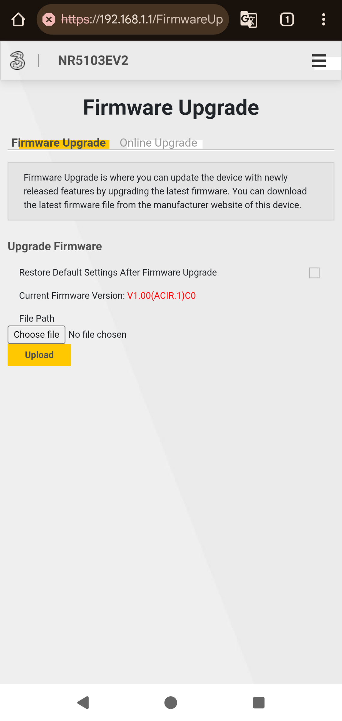

junior Posted March 13 Author Report Posted March 13 8 minutes ago, IanD said: You need to reconfigure that port from LAN to WAN in the app, as said above... 😉 Yeah saw that. Did that.... Hey presto, I now have a green LED in the internet light. So as I understand it, my Three router is now getting it's internet from my sky home router, via a cable, not from the SIM card/Smarty mobile network. Bad news is I've gone into the diagnostic tool app and tried to manually update the firmware....and it's told me my router currently has the most up to date firmware. So I've now ruled out firmware as the problem. I've also ruled out the SIM card/smarty network being at fault as it works in my mobile phone. Any other suggestions? I'm starting to think it's a hardware issue now, and might need to replace the router 🤬
junior Posted March 13 Author Report Posted March 13 10 minutes ago, Liam said: Can you try your phone SIM in the router? Yeah tried that this morning. Exactly the same as when the Smarty SIM is in there. Doesn't work.
IanD Posted March 13 Report Posted March 13 15 minutes ago, junior said: Yeah saw that. Did that.... Hey presto, I now have a green LED in the internet light. So as I understand it, my Three router is now getting it's internet from my sky home router, via a cable, not from the SIM card/Smarty mobile network. Bad news is I've gone into the diagnostic tool app and tried to manually update the firmware....and it's told me my router currently has the most up to date firmware. So I've now ruled out firmware as the problem. I've also ruled out the SIM card/smarty network being at fault as it works in my mobile phone. Any other suggestions? I'm starting to think it's a hardware issue now, and might need to replace the router 🤬 Are you absolutely 100% sure you're inserting the SIM the right way round? The labelling on the socket is very poor, and it's easy to get it the wrong way round. If it's the right way round, then after inserting it you could try pushing it towards the side with the contacts using your fingernail -- or slip something thin down behind it on the opposite side to the contacts to push it towards them. You could also try switching the antenna switch to EXT and back to INT a few times, in case this is the problem (and EXT is selected). If none of this works there's nothing else you can do, it doesn't matter whether the problem is the SIM socket or something else in the router, it needs replacing. How long have you had it -- is it under any guarantee from the seller? If you do have to replace it (not under guarantee) I'd suggest the V1 not the V2, people seem to have more problems with the V2...
