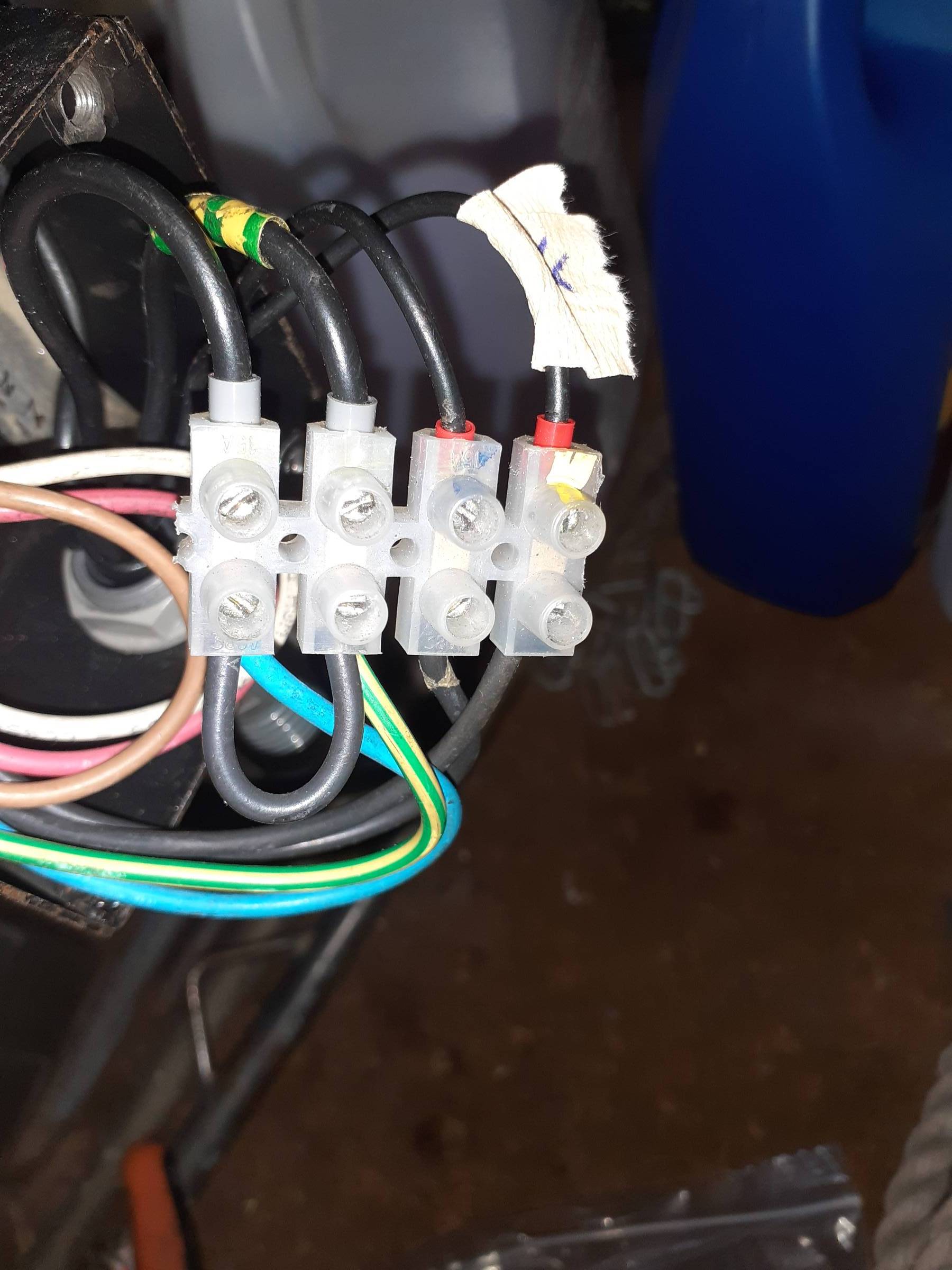

Lockkeeper7 Posted July 25, 2024 Author Report Posted July 25, 2024 Am i correct in thinking the main 230vac connections are via blade terminals?
Tasemu Posted July 25, 2024 Report Posted July 25, 2024 2 minutes ago, Lockkeeper7 said: Am i correct in thinking the main 230vac connections are via blade terminals? Are you referring to the voltage sensing inputs to the SX460? If so then I simply tee'd off from the back of one of the 240vac sockets and ran the wires to the inputs on the AVR. EDIT: on second look i actually used WAGO connectors to tee off from the output socket as I like them and they're reliable. @Lockkeeper7 Youre going to want to take particular note of this post, as the old markon AVR siphons extra voltage off, and the SX moderates it differently. I've included steps and a wiring diagram to explain here but you need to rejig the system slightly to work with the SX unit. 1
Tonka Posted July 25, 2024 Report Posted July 25, 2024 13 minutes ago, Lockkeeper7 said: Am i correct in thinking the main 230vac connections are via blade terminals? Mine had a block in a box on the Markon
