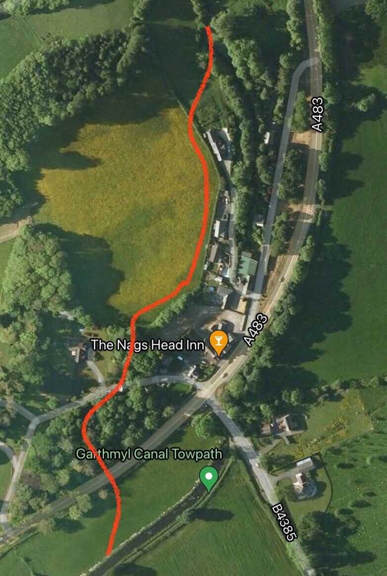

Graham, absolutely agree that the Garthmyl 2 dropped bridges + 150 - yards of vanished canal is the worst blockage on the southern bit before the dry section at Newtown. There seems to be no way it would go back on the original alignment or anything like it.
What I have seen mentioned as the subject of semi-official discussion in the past are alternative routes such as sketched by myself in the appended picture.  From an engineering perspective the road is slightly rising going south, and there  may be JUST the required headroom under it for a crossing without any unacceptable (highway requirements etc) uplift.  As OS contour maps are to the nearest 5m I cannot be definitive on this, but I’m repeating what others have said.
From a property perspective it cuts through Hall lands and crosses one of the two drives into the Hall, necessitating a lift bridge, I imagine. I’m not sure how that would go down, but we’re not in the 18th and 19th centuries where landowner rights could kill such a proposition stone dead. Perhaps outline very early soundings have even happened?
I have seen versions of this rough concept being mentioned by sources I respect on a number of occasions, so I currently believe that it has some merit… but nothing is certain.
Regarding the two 483 crossings further south at Fron farm, they also provide challenges but you have started to pencil in one engineering line of attack.  My worry about the approach of staying on the East of the 483 with a new 1/2 mile length of canal, is that in the area roughly opposite the farm, the field is perhaps 4-5 m lower than the canal, necessitating a considerable embankment. I suppose the good news is that makes the side road crossing easier, but it is substantial work.
The two existing crossings might be viable if they were moved short distances along the 483 to gain headroom. However this would be two sets of crossing works, and very touch & go on height as well.  There might also be issue with property at one of them. So overall I’d guess your suggestion is the most likely - certainly it would minimise road disruption.

Perhaps one of these days I'll park up at Garthmyl and walk down that length and take some comparative (rough) height comparisons.
It certainly is an interesting problem.
Agreed Graham. If ever I’m in that part of the world I’d probably pull over and check it out myself. Mind you, estimating slight rises and falls to these levels of accuracy, when the canal is some distance away, really needs the proper kit I suspect. Still, there’s no harm in having a good old look at it 😉
From my perusing of the OS map, I’d estimate the canal level to be somewhere >90 and <95m.  Best guess around 93-94m.  If u ever do have a gander at it, pop it on the end of this thread!

Looking at the canal from the new road,towards the lime kilns ,the Nags Head pub to your left,the canal is about 6-10ft above the old road. The ground rises to canal level by the old  bridge at the very end of the canal. The red line on Tarboat Tims map would not cross the drive to Garthmyl Hall,or the modern Swedish type house.built by the then owner of Garthmyl Hall. It would cross the origional drive to the hall.(The origional gate house is next to the pub).The canal passes under the road to Montgomery(op. the Nags Head) with minimal clearance. Between the two bridges,the canal is filled in
I doubt if a bridge would be possible as sight lines on the main Welshpool to Newtown road between the Nags Head  and the drive to Garthmyl Hall would not allow the main road level to be raised
