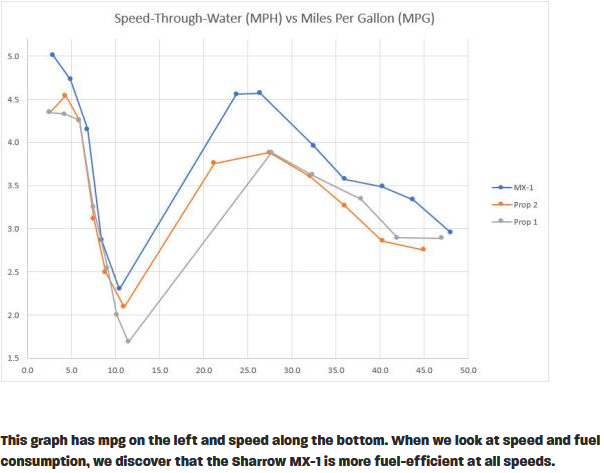

Guest Posted May 20, 2021 Report Posted May 20, 2021 50 minutes ago, Sea Dog said: I think you're missing the fact that the typical canal boat burns about 1.25 litres of red diesel per hour. Even if you could halve fuel consumption with a better prop, the annual saving would be too small to justify the expense for the user to buy one. Canal boat props are such a tiny market that there's really no incentive for the manufacturer's to invest. There may be some imperative to improve prop efficiency with electric drive canal boats, but even now that's still a very tiny fraction of an already tiny market. If more efficient propellors do become available for canal boats, they'll be as a result of the R&D for markets other than ours.. I agree apart from the fuel consumption, with the drive for ever bigger engines I think that they use more fuel than the older boats
David HK Posted May 21, 2021 Report Posted May 21, 2021 Electric Drive - That is what this is all about. New tech begets new tech. If your prepared ( at the moment ) to pay fortunes for LIFEPO4 battery banks or exotic hand built motors and the associated generators, controllers et al. then prop cost, which you might consider expensive on its own, really is insignificant and yes, like non stick frying pans, the answer may come from other tech endevours.
IanD Posted May 21, 2021 Report Posted May 21, 2021 (edited) 15 hours ago, Sea Dog said: I think you're missing the fact that the typical canal boat burns about 1.25 litres of red diesel per hour. Even if you could halve fuel consumption with a better prop, the annual saving would be too small to justify the expense for the user to buy one. Canal boat props are such a tiny market that there's really no incentive for the manufacturer's to invest. There may be some imperative to improve prop efficiency with electric drive canal boats, but even now that's still a very tiny fraction of an already tiny market. If more efficient propellors do become available for canal boats, they'll be as a result of the R&D for markets other than ours.. The efficiency difference between a standard prop and a beautiful CNC-machined one will be tiny, maybe a couple of percent at most, because how to design a prop has been well known for many years and everyone uses similar turbine designs because that's already the optimum. For high-speed and high-load multiblade props with much higher power density the difference may be a bit bigger, but we're talking about narrowboat here not nuclear subs or ultra-large ships. There is a radical new tipless prop design being promoted (the blades form a loop) which claims >10% higher efficiency -- these are CNC machined and ferociously expensive, but probably useless on canals because of debris pickup. https://www.mby.com/gear/sharrow-mx-1-tipless-propeller-110120 "The only obvious drawback is price. Currently, every MX-1 propeller has to be milled from a solid billet of metal, which helps explain the price of $4,500 for an aluminium MX-1 or $9,000 for a stainless steel one." Edited May 21, 2021 by IanD added link to Sharrow prop

David HK Posted May 21, 2021 Report Posted May 21, 2021 3 hours ago, IanD said: The efficiency difference between a standard prop and a beautiful CNC-machined one will be tiny, maybe a couple of percent at most, because how to design a prop has been well known for many years and everyone uses similar turbine designs because that's already the optimum. For high-speed and high-load multiblade props with much higher power density the difference may be a bit bigger, but we're talking about narrowboat here not nuclear subs or ultra-large ships. "The only obvious drawback is price. Currently, every MX-1 propeller has to be milled from a solid billet of metal, which helps explain the price of $4,500 for an aluminium MX-1 or $9,000 for a stainless steel one." ... and these sort of responces have been seen whenever new and expensive tech hits the market. Lots were said about horse against car, IS happening about ICE vs electric when a Tesla has a crash. As regards expense, then of course a precision one off hand made by robot is going to be loads more than a simple item made with 19th century tech. BUT as Henry Ford might have said, " wait till I get my shit in one sock and the prices will tumble." You have a good argument for now, but now is not where we are going and the ICE is out , even on the canals, in the not to distant future which, if it is to be really economical, just like a modern Euro X diesel, is going to need tech to be economically available and just because something never has doesn't mean it never can. Love to have this discission at your local Frog and Trumpet when I return to the motherland and get the boats built.
IanD Posted May 21, 2021 Report Posted May 21, 2021 (edited) 13 minutes ago, David HK said: ... and these sort of responces have been seen whenever new and expensive tech hits the market. Lots were said about horse against car, IS happening about ICE vs electric when a Tesla has a crash. As regards expense, then of course a precision one off hand made by robot is going to be loads more than a simple item made with 19th century tech. BUT as Henry Ford might have said, " wait till I get my shit in one sock and the prices will tumble." You have a good argument for now, but now is not where we are going and the ICE is out , even on the canals, in the not to distant future which, if it is to be really economical, just like a modern Euro X diesel, is going to need tech to be economically available and just because something never has doesn't mean it never can. Love to have this discission at your local Frog and Trumpet when I return to the motherland and get the boats built. We're not disagreeing here -- as I keep saying electric is expensive now but the cost is dropping, however as long as you need a generator (no widespread charging points) I can't see how it can ever become cost-competitive since a marine generator costs more than a marine diesel engine even before you add on the batteries and the rest of the electronics. Yes it's the future (more eco-friendly etc), but cost is an obstacle to widespread adoption, and this will only be fixed with charging stations. The cost of the Sharrow prop is high now because it's not mass-produced, the article says exactly that, and it will come down assuming it succeeds in the market. But I'm not sure the higher efficiency will compensate for it being way more prone to picking up canal debris on the loops -- this usually slides off a normal prop especially with a burst of reverse, but I can see it getting stuck with the Sharrow, meaning far more frequent visits to the weed hatch. Looks beautiful though... I'm a fan of new technology (used appropriately!) which is why I'm having an electric (OK, series hybrid) boat built, but I also recognise the disadvantages and especially the cost at the moment... Edited May 21, 2021 by IanD

IanD Posted May 22, 2021 Report Posted May 22, 2021 Just now, David Mack said: There was a radical square bladed prop design being promoted a while back. It has since sunk without trace . The difference is that the Axiom prop was a combination of BS and hiding the fact that in order to be better in reverse than a conventional prop it was worse in forward gear. If you go and read the links about the Sharrow prop it does appear to be a genuine advance in prop efficiency, with both theory and test data to prove it. If it does offer the advantages claimed for ship-scale props then I suspect it will be a huge success, saving even a few percent of fuel is the Holy Grail for shipping companies and this promises to do better than that.
Guest Posted May 22, 2021 Report Posted May 22, 2021 (edited) 14 minutes ago, David Mack said: There was a radical square bladed prop design being promoted a while back. It has since sunk without trace . When I converted mine I just cut down the original prop, it was to big for the diesel engine before so I removed an inch of it carefully and it now spins to maximum rpm, I gave it a nice polish for good measure ? I had a look at those Sharrow props but 4.5 to 9k in dollars sort of stopped me, mine seems to work ok Edited May 22, 2021 by peterboat
