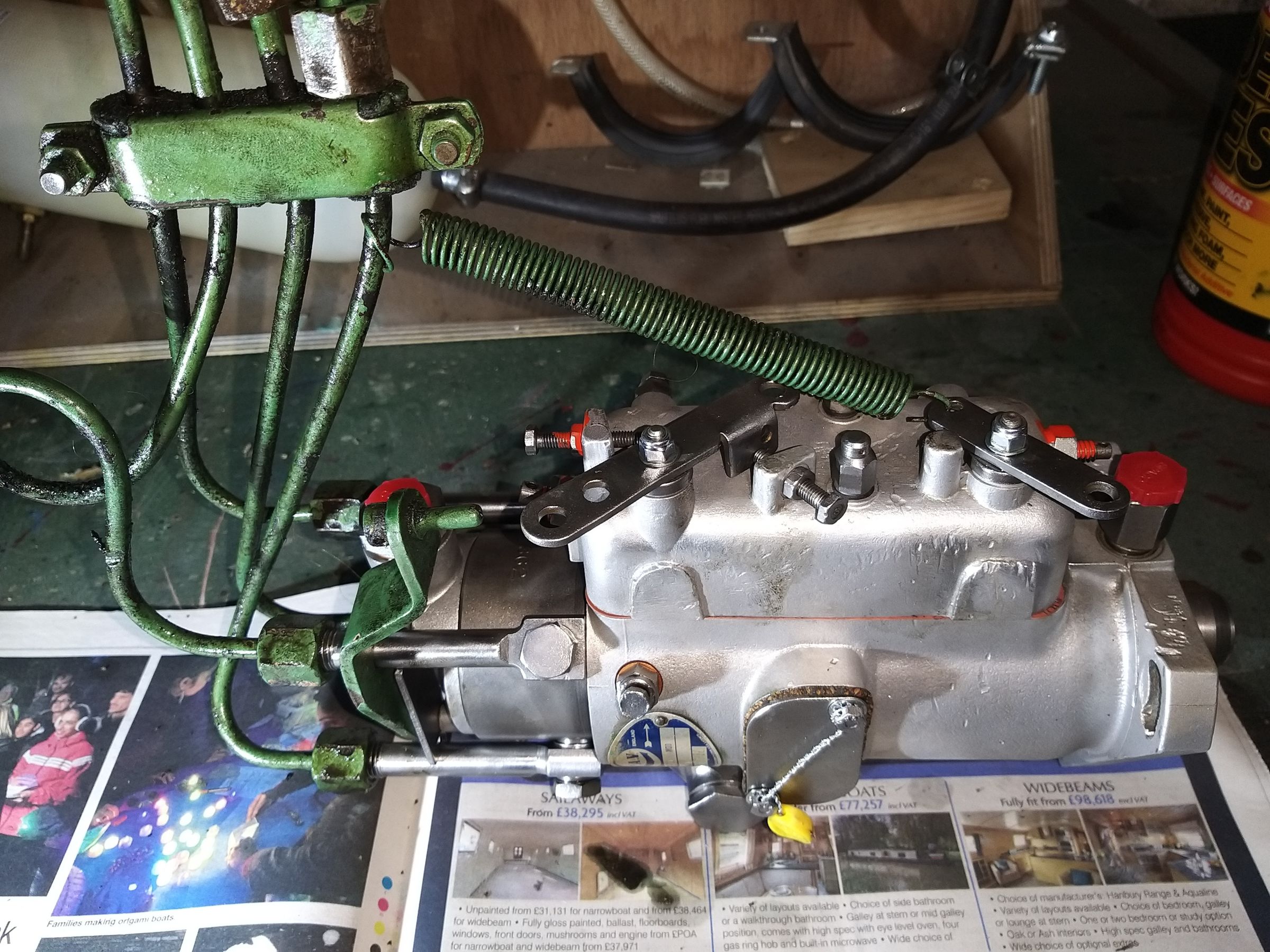

Evening all,
I recieved my CAV DPA pump back from the refurbers last week, it was sent away as it was leaking diesel fron the front seal.  Decided while i was at it to get the injectors overhauled at the same time.  Spent yesterday refitting the parts making sure everything was clean, replacing all copper washers etc. All went fine until i came to bleeding, from the manual it says:
Slacken the two air bleed valves on the fuel injection pump.  One bleed valve is located on the govenor housing, while the other is incorporated in the hydraulic head locking screw situated immediatly above the pump name plate.  Operate the lift pump, and when fuel issuing from both valves if free from air bubbles, tighten the bleed valves.
Sounds simple enough, opened both bleed valves and started pumping within a minute or so diesel was dribilling out of the lower valve... 30 minutes and a raw finger later still no fuel at the higher valve.  figured i'd carry on and try and start it turned it over with the injector unions looseuntil fuel appeared at all four, nipped them up and it started, very rough and lost of smoke but quickly settled down and it  ran ok for about 15 min then i shut it off.
Went back to it today to check all unions are nipped and no leaks, she started up pretty well but i noticed a bit of white smoke, definatly smoke not steam, had that unburnt diesel smell to it and the idle is little lumpy has a bit of a stumble to it.  Figured there might be a bit of air stuck in there so cracked of each injector union for a minute or so whilst running.  Once all nipped up again it hasn't made much difference, still a bit of white smoke and a bit of a stumble, rev it up and it improves, no white smoke and feels smoother...
Any ideas what i might have missed, do i need to go back and re bleed the pump??

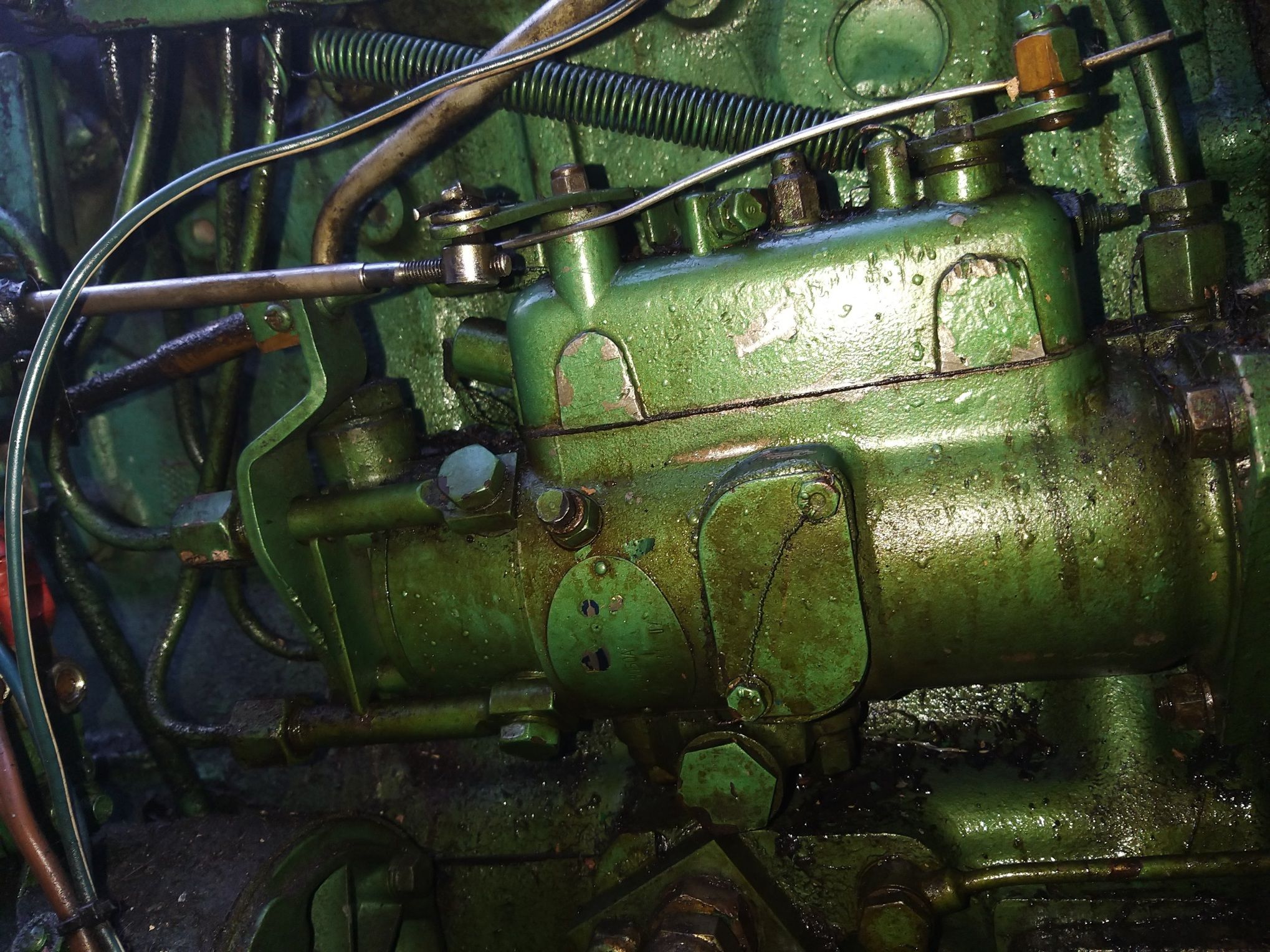

?  When you bled the pump did you have diesel coming from both the bleed valves pictured at the top?
We had a fountain from the lower one, and a trickle from the top one and virtually nowt at the  injectors the first time.
When it came back the 2nd time, fountain from lower and upper one.
