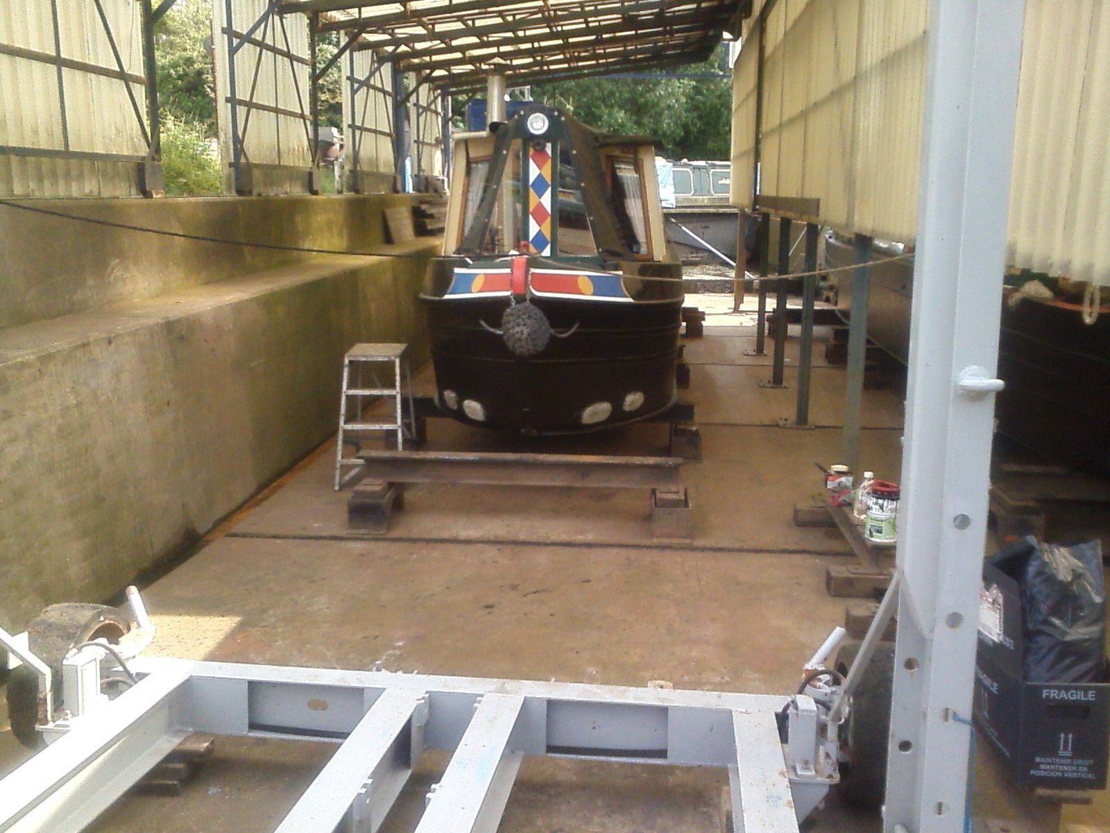

Not your neck of the woods, but your £1250 would get you a week out on the slipway for hull blacking and a week in wet dock for top side painting at Aylesbury. Both covered and heated.
http://aylesburycanal.org.uk/our-services/slipway-dry-dock/
http://aylesburycanal.org.uk/our-services/wet-dock/

From Adlington, options for covered wet or dry docks are:
Wigan dry dock
Worsley dry dock
Fettlers Wharf wet dock
St Mary's paint shed/slipway
Or going the other way,
Bank Hall dry dock
Lower Park marina wet dock
Pennine Cruisers dry dock
If you are going to Botany Bay, ask Ian the boat painter to put you in contact with Kevin, or ask Mark if you can go under the scaffold tent next to the containers for an extra charge.
Andy at Wheelton also has existing tents if you are going there, but they are usually in constant use.
