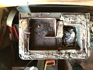

I’ve got the top screws undone/drilled out but the top is still stuck fast. Any tips anyone? I fear it would be easy to break it.
Edited by starman
The good news is I finally got the top off. The bad news is the top of the oven us split in two (not by me) which looks like a complete dismantling job to replace (with a non-existent part no doubt).
12 minutes ago, plato said:
I’m pretty sure that can be welded.
I’ve had bits of my Epping welded successfully.
It will certainly be worth a try - if I can get everything apart without finding (or causing) any more damage.

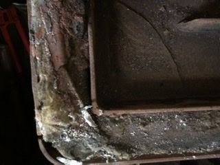

The Epping is in bits! Surprisingly straightforward really  though I had to drill out most of the fixing bolts.
I’m making a list of the bits in good order...it’s depressingly short.
The list of damaged ones is depressingly long: the top, the flue box, an oven casting, three of the four firebricks, the grate, one foot.
I think I’ll store everything out of sight and wait until the virus plague is over.
1 hour ago, springy said:
The top, flue box, firebricks & grate I would expect, what happened to the foot ?
springy
Snapped across the bolt hole - possibly over tensioned sometime. I’ve got the broken bit.  Not a problem compared to the other stuff.
