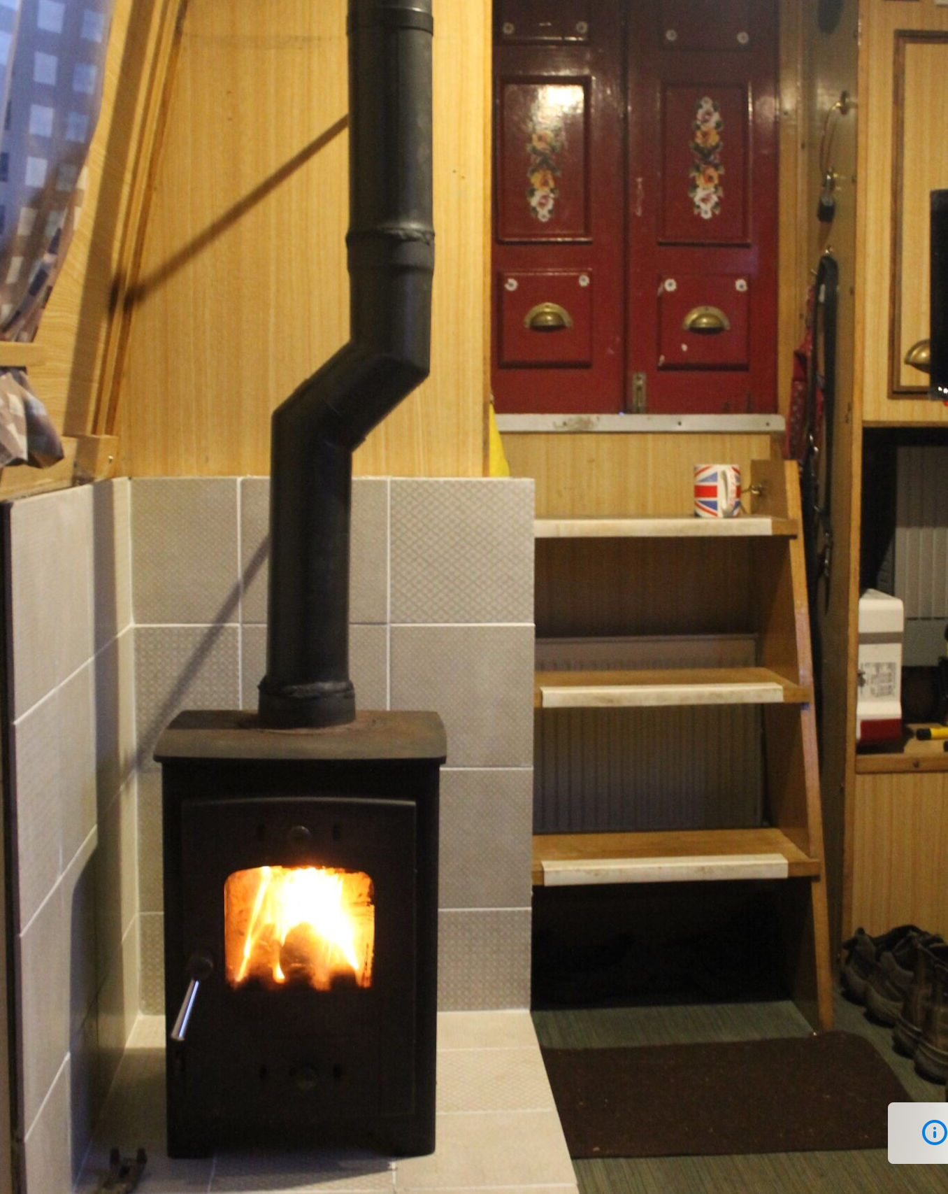

Having fitted a Hobbit to ours, earlier this year, I am struggling to understand your predicament.  If you are building out at stove height, so as to have an air gap, calcium fibre board, backer board and decent porcelain tiles, then place the stove the correct distance from these, your flue will naturally be 3x diameter from the bulkhead.  I also had to use an off set, but this was purely because the chimney would have gone right through the handrail otherwise, so worth checking your space outside too!
