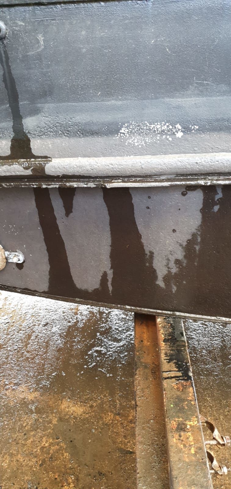

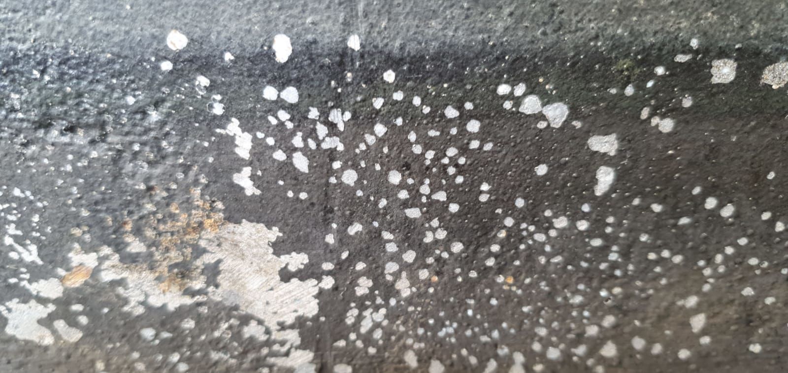

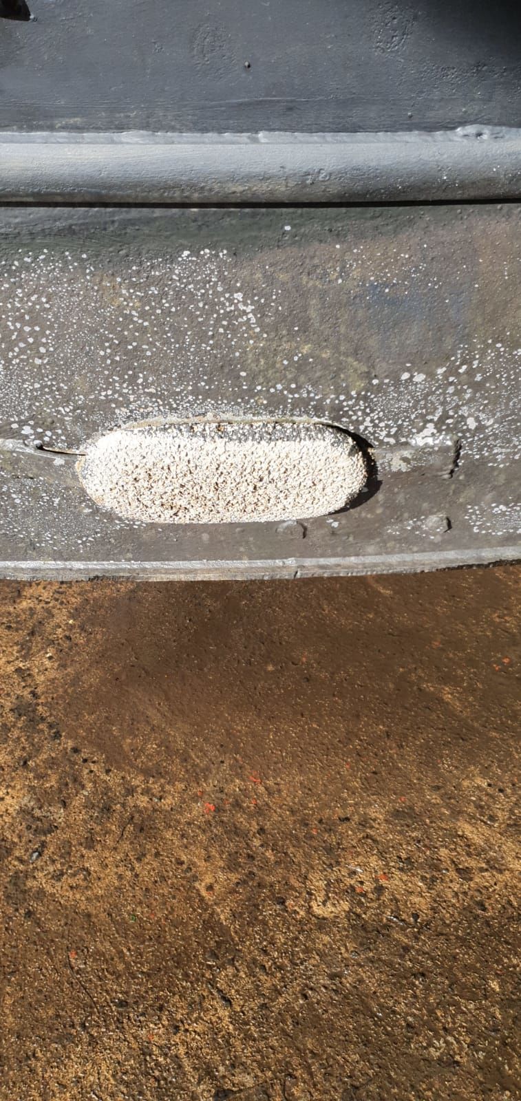

  3. The residue sand was brushed off before coating. I didn't bother with that when I did Midnight just mixed it in and it's been okay. I've only seen the photos but asked the question and was told it's on the steel It's all over except for the base-plate and seems to be random
  4. For clarity the silvery spots are all down the hull sides not just on the vicinity of the anodes. My initial thoughts were galvanic corrosion but as I said the boat has an isolation transformer fitted.
  5. Apologies I misread your last sentence
  6. Again this is a puzzle. Although about 30 years old and not in tip-top condition the hull and base-plate were sand-blasted prior to the two-pack coating being applied just one year ago. It's exactly the same system I've used on Midnight which despite being 16 years old now has no such issues. Although the base-plate was perhaps given an additional coat the hull sides had two coats applied. I think the Type 2 Microbial Corrosion mentioned by Alan de Enfield and Captain Pegg is the answer just very surprised it happened in such a short time span and now need to find out what the correct treatment is. In the past I remember someone washing the hull sides with Domestos.
  7. No that's what's puzzling the base-plate is untouched
  8. Here's a puzzle I helped a friend two-pack his hull sides and base-plate last year. Today he dry-docked to see how it was doing and was quite shocked to see the hull sides covered in silvery flecks but nothing at all on the base-plate. Both were painted just after the sand blasting and loose sand removed. He has an isolation transformer installed.
