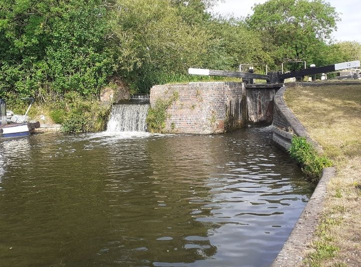

Paired gates are designed and installed to seal down the mitre joint between the gates. On wide canals many narrow boaters open a single gate and scrape against the sealing face of the closed gate as they pass through. The result is that every wide lock (other than one with brand new gates) has a gap between the bottom gates 2-3 feet above the lower water level. When the lock is full water gushes out through this gap, when it's empty you can see daylight through even if the gates are fully closed. The same doesn't happen with top gates as the damage is done above upper water level. That damage, and the resultant leakage, is down to boaters, not CRT. On the River Wey use of single gates is not permitted. Perhaps CRT should require the same, although in practice it is probably unenforceable. The Avon Navigation Trust only has to maintain the locks and a few mooring sites. The river channel, weirs and bridges are all the responsibility of others. There are no reservoirs to maintain. The river upstream, tributaries, drainage outfalls and runoff from the adjoining land all provide more than enough water for navigation. There is no leakage from the channel to worry about. And it's a similar position on the River Wey. So hardly a valid comparison with CRT's network of mostly canals. Which other navigation authorities are you thinking of which apparently do a better/cheaper job than CRT? CRT are generally responsible for the management of the water space in the West India and Milwall Docks. Its a legacy role from the development of the whole area led by the London Docklands Development Corporation, now wound up, and somebody has to do it. It's a similar position in Liverpool. CRT do have some development land in the West India Docks, and it is currently undergoing large scale development, with CRT getting their share of the resulting financial benefit.

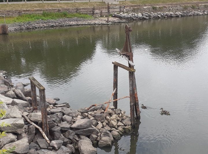

I don't see a swing bridge! Don't believe everything you read on the Internet! -
