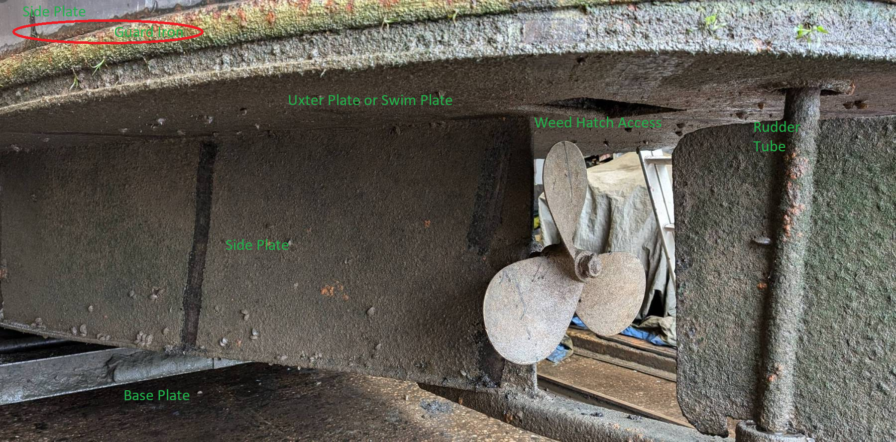

Replacement of Engine Compartment
agg221 replied to Ian Thomas's topic in Boat Building & Maintenance
I'm with Tony on this. So that everyone is on the same page, I have marked up your drawing with what I would call each of the areas - other names get used in different boatyards or parts of the country. With reference to the named parts, is it just the base plate which is being considered for replacement? If so, that is relatively minor. Re-plating is directly equivalent to the original build if done properly, so there is no loss of value. The standard construction of canal boats for a long time was 10/6/4 (base, sides cabin, thickness in mm). Earlier it had been 6/6/4, well actually 1/4" probably. If you replace the base plate in 10mm plate rather than overplating it will be completely back to as built. Whilst you are at it, if corrosion is pretty much internal, I would expect it to have gone a bit up the side plates too, so the bottom of the lower side plates need considering. The swim plate normally corrodes from the outside and it is usually possible to see what's going on with the inside. The other parts which often get neglected for painting and general maintenance are the weed hatch access and the rudder tube. These want careful inspection as if they corrode through the boat sinks. If your surveyor has done a good job they will have been inspected, but they are areas I would specifically ask about. I have marked an area with a red oval because I don't like the look of it. It could be purely superficial in which case no issues but it's somewhere I would be paying close attention to. I would also be having a good check to see that the guard irons are fully welded top and bottom because if you are beginning to see a bit of corrosion in the side plate at that region, it will be much worse behind the guard irons unless they are sealed. Hope this helps. I do not claim to be an expert and others are likely to be able to chip in with a lot more knowledge than me. It is certainly not designed to put you off a boat that you like - doing a bit of welding becomes something on an inevitability as boats age, particularly if they are used as the baseplate can wear as much as it corrodes. If this is a boat you are going to keep, I would be inclined to have the whole thing blasted off, any deep pitting filled by welding and then paint with epoxy, including the baseplate. It will stop the outside from getting materially worse through corrosion and give a good long interval between painting. If you do decide that you want to do more than just the repairs identified by the surveyor (e.g. blast cleaning, remedial welding if any is needed, epoxy etc) then it will be more cost-effective to do it all at once. On that basis, I would get a quote for the repair work identified by the surveyor, get the price reduced by that much and then add in the rest on top (get the quote at the same time but it isn't really part of the purchase price to have that work done). Alec -
